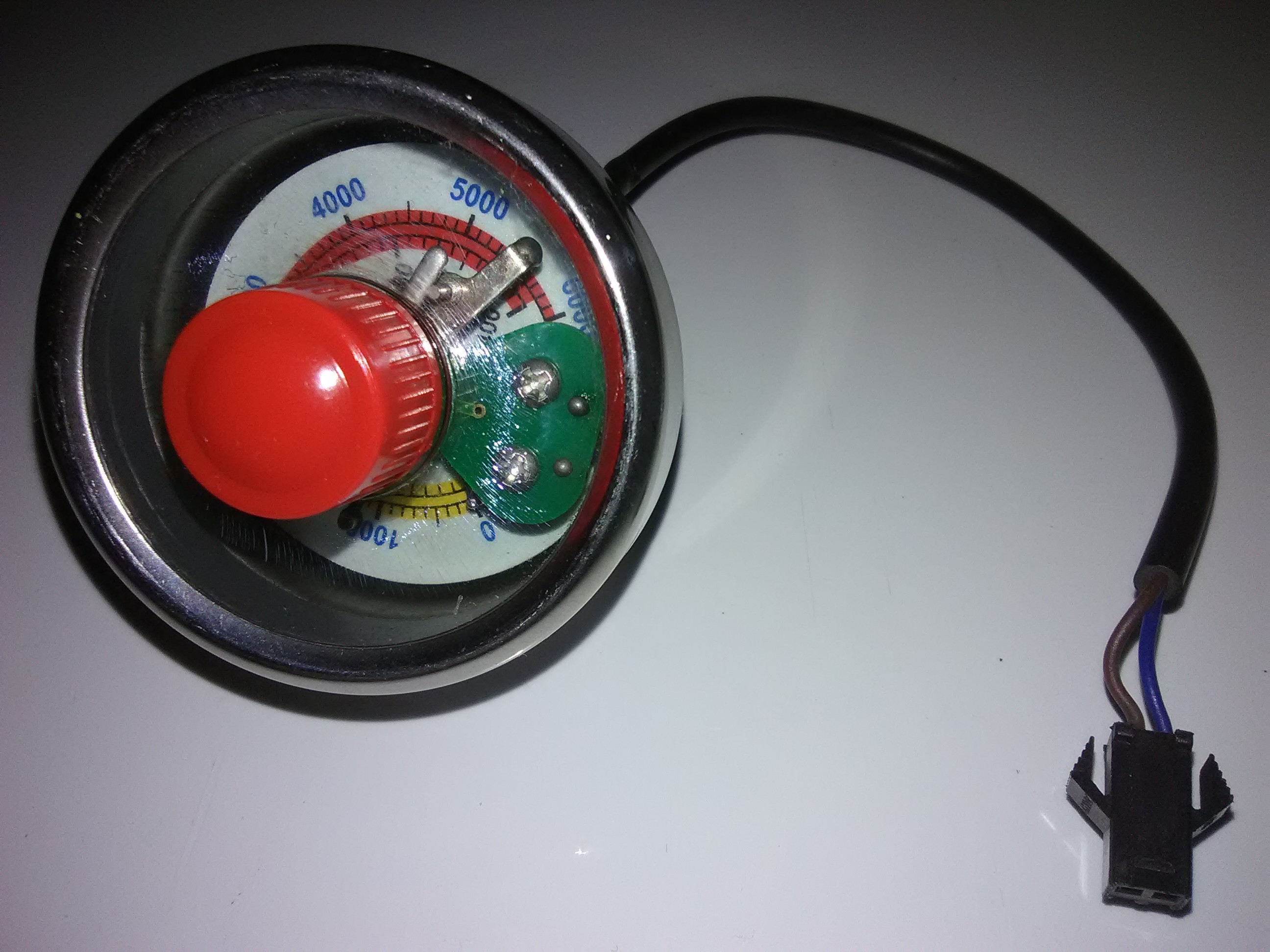

Gauges eventually shake apart, then leak, borrowed liquid-filled one from my Chinese HPA handpump when original failed. Never used the set pressure function (red knob in gauge glass) so don't miss it now. Yong Heng spare parts bag includes a few Delrin (white plastic "donut" style) washers, I bought more since they seal gauge and pressure-release valves and tend to wear out over time. WM

Here's my dead original YH gauge, lasted two years. Never used red plastic knob to set pressure. Gauge from HPA handpump threaded right in, has a solid glass face, no red knob. WM
