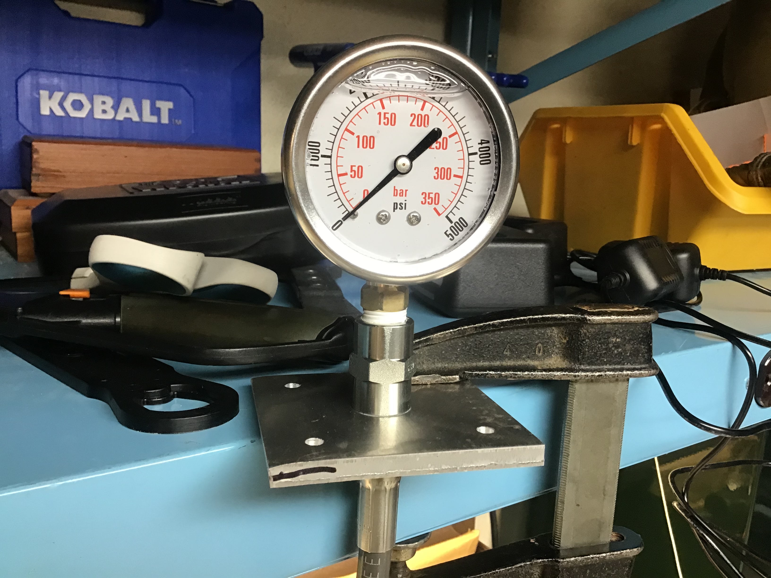

Yong Heng remote mount gauge

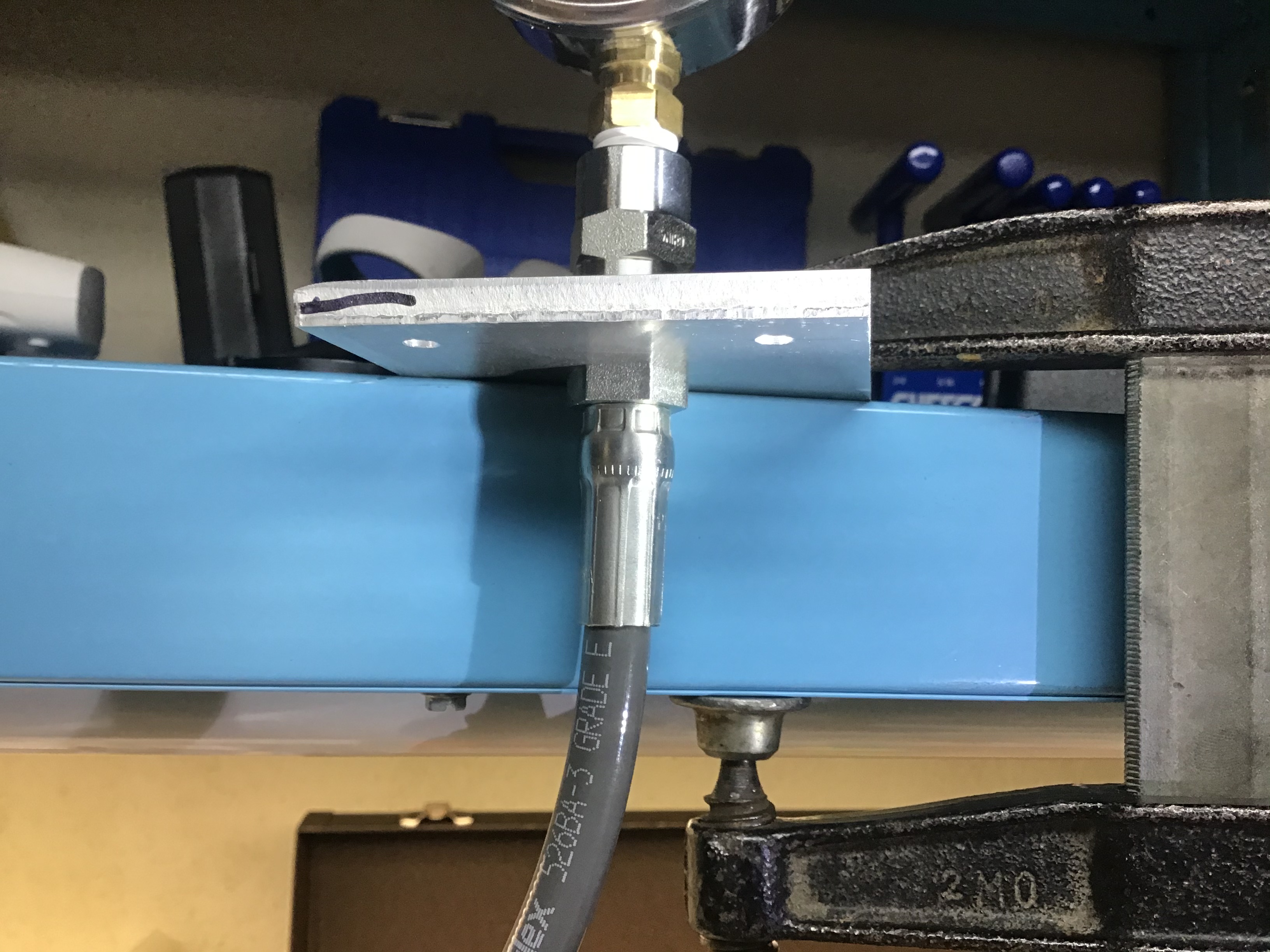

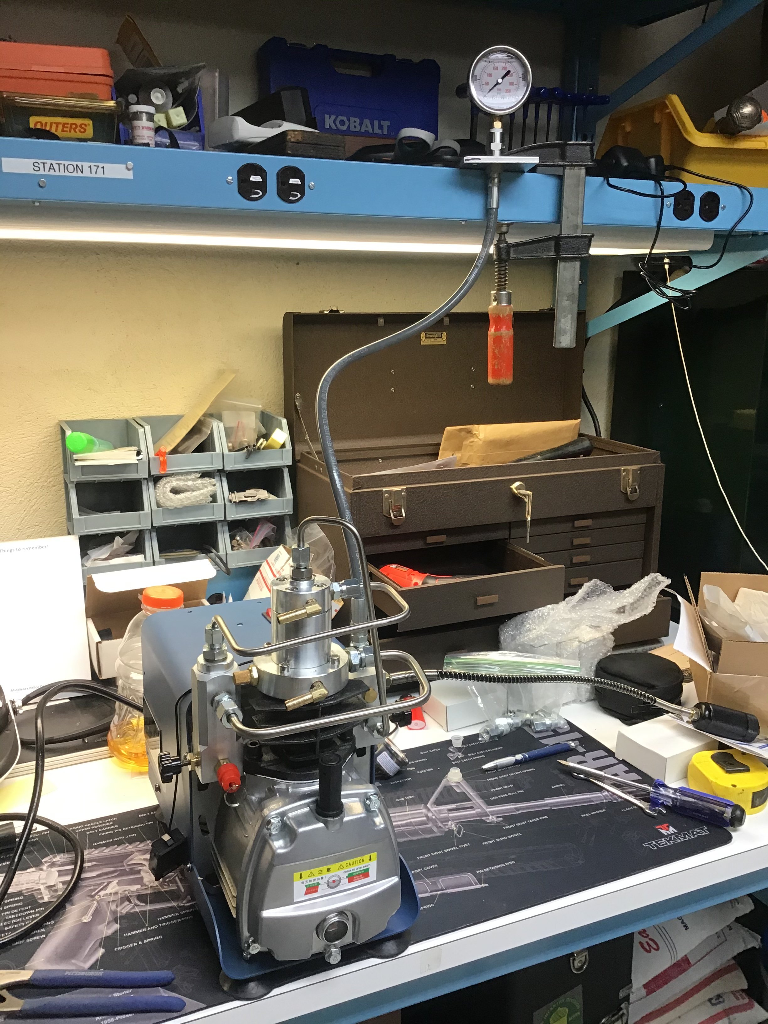

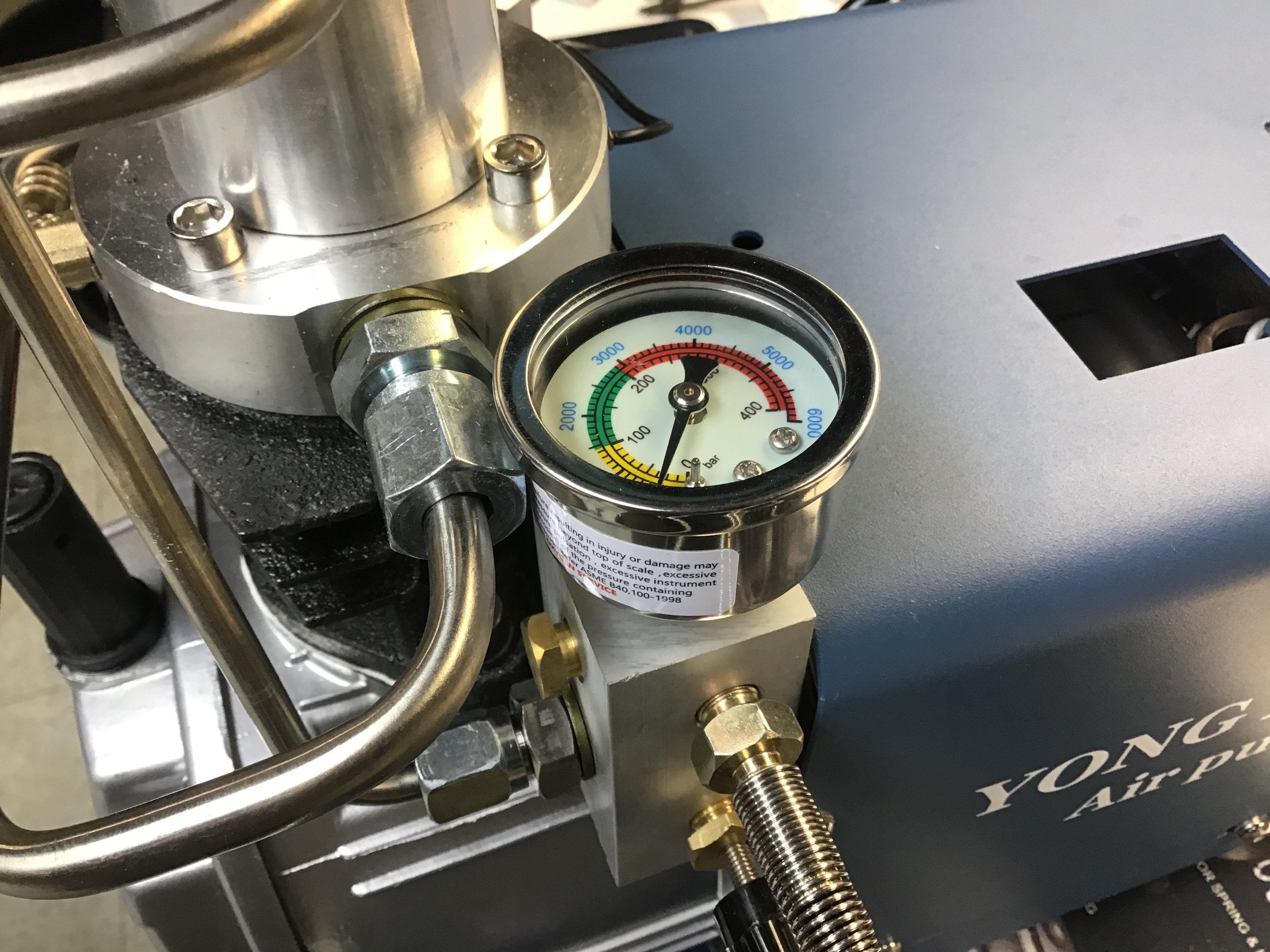

With aging eyes, I found myself way to close for comfort trying to read that small, yong heng, gauge. Time to move it.

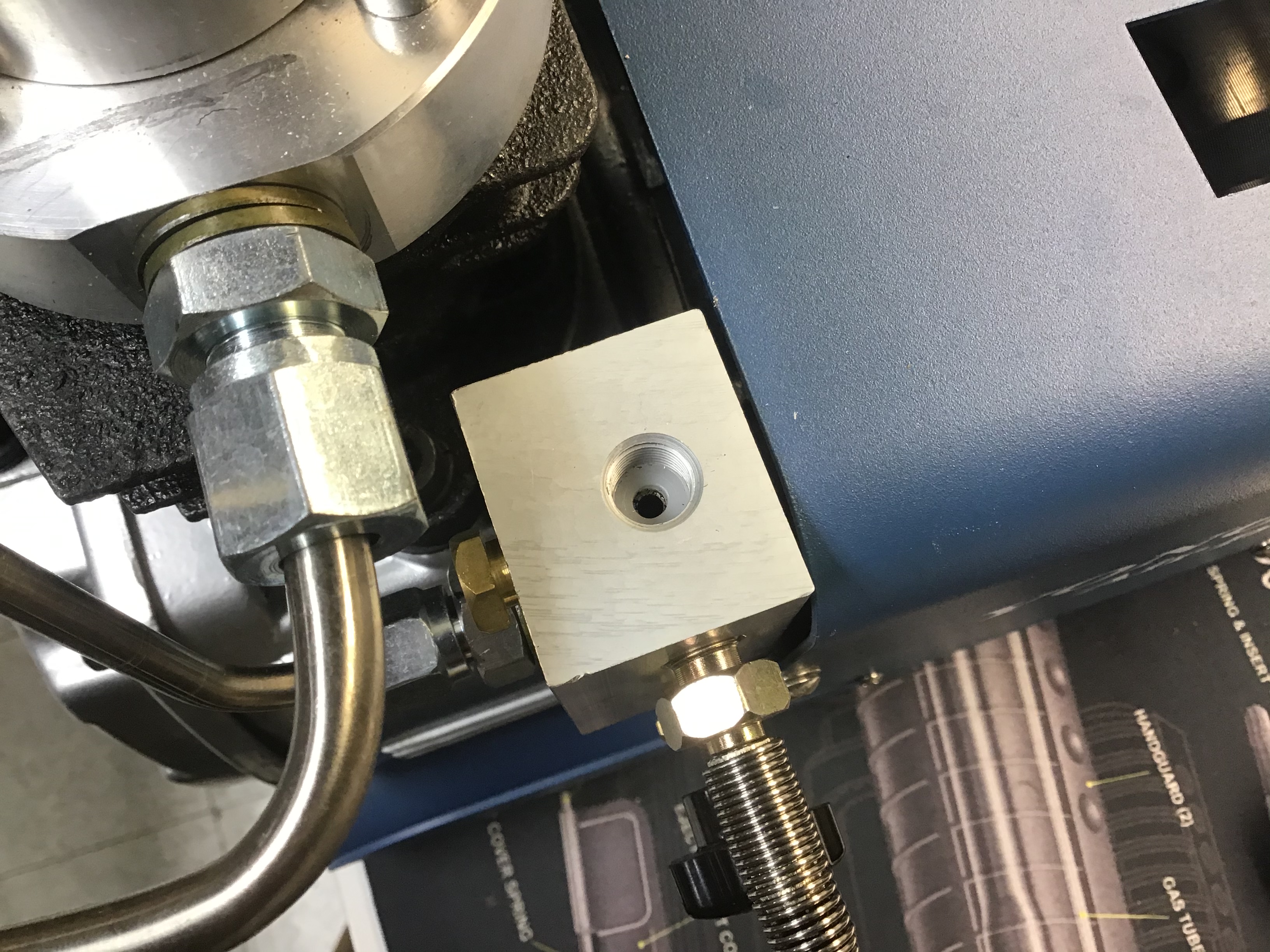

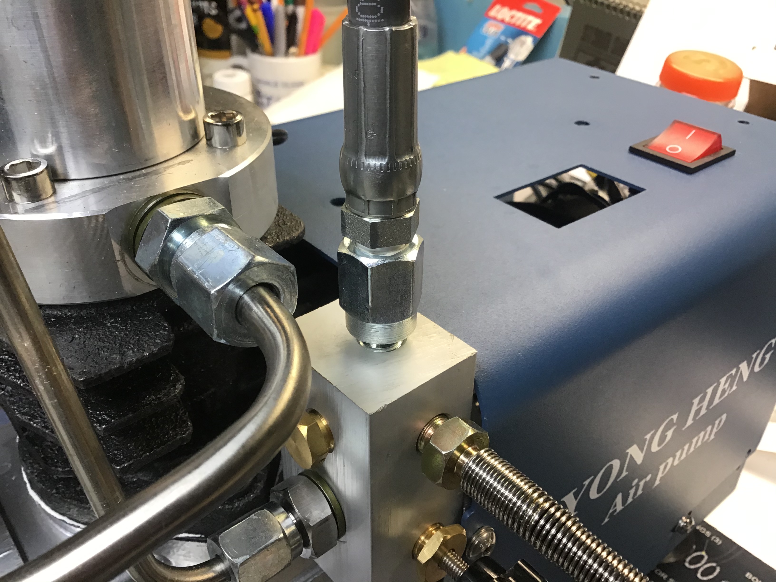

M10/1.0 threads on the gauge port so I needed an adapter. M10/1.0 male x 1/8th Fpt gets me where I want to be.
A decent 2.5” glycerin filled gauge, 2 feet of quality air hose, a coupling, and an aluminum plate.
I’m thinking this is a “must have“ for you guys running your compressor on a lower shelf or the bottom of a cart.

I like it!
I want to make a quick connect gauge that I can insert anywhere along the line that I want to, from right at the compressor clear through the air highway, right up to the connector on the gun. Just trying to decide what make and type (Analog or Digital) on the gauge. I want something that is very accurate, but won't break the bank.

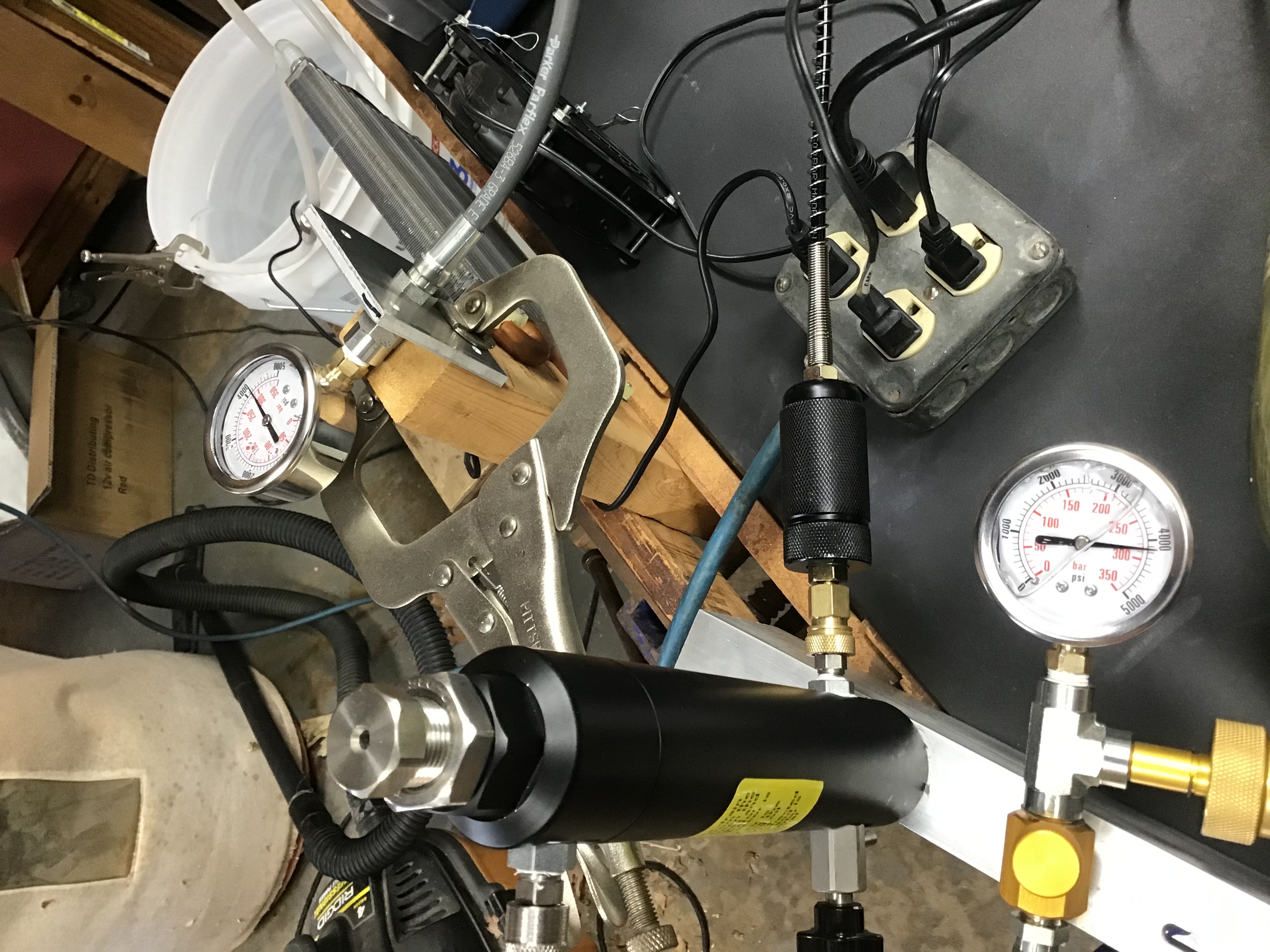

Define accurate — something certified is going to cost. Now I at least have gauges that match and read really close to the same pressure — Are they accurate? I don’t know.
I recently purchased a fill set off the classifieds here, turned out the gauge was off by almost 50 bar. Luckily it was reading higher than the actual pressure. Would have been blown burst disk city if it was 40 to 50 bar low. Unfortunately 4 of my scba tanks where low — didn’t know it till trying to fill a gun to 250 bar and couldn’t get there off the tank.
One of the reasons I did the remote gauge was because of this faulty gauge. I will always have 2 gauges while filling tanks from compressor.
