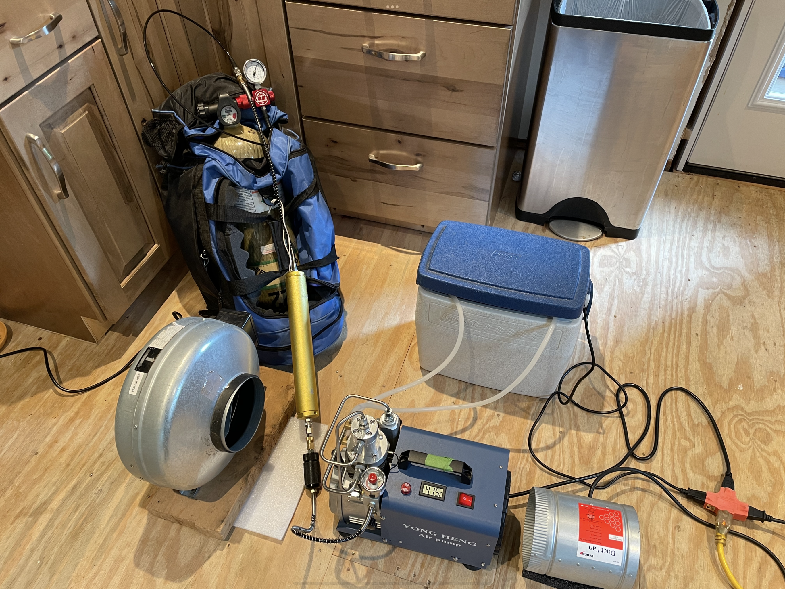

Yong Heng, Radiator vs Ice, my results so far (Video added)
A higher volume water pump can not help cooling in a closed loop because each molecule of water spends the same amount of time being heated and cooled no matter how fast it makes laps through the loop. The only time it could help is if the water were reaching it's heat carrying limit which is close to boiling point and will not happen in these compressors.
The greatest limit to water cooling a yong heng is the lack of a cooling jacket on the cylinder. The water passes through a single straight skinny bore between the inlet and outlet so there is not enough contact surface to exchange the heat. Adding the tinniest drop of dish detergent to your water will break the surface tension of the water and allow it to contact slightly more surface area inside the tiny water passage in the compressor head but this won't be much.
Agreed 100%
I use a bigger pump in mine but my justification for that is my YH is at counter height and my water bucket is on the floor a couple of feet below it. I use a fairly large computer radiator with two fans on it. I also have a 8 inch fan blowing air across the YH motor and first stage fins. In the winter and portions of the spring and fall I do not use ice. My temperature stays at 60 degrees C or below. In the summer I add ice in the form of frozen soda bottles. I run the YH for around 20 minutes to refill my 45 minute SCBA tank. I also find that brake line has significantly less tendency to kink than vinyl hose and I think "water wetter" sold for cooling systems of cars is worthwhile.
Once the water reaches maximum pumping height and falls back down the siphon effect cancels out the head pressure so a larger pump isn't necessary.
Even though the oem pump can't lift water more than a few feet, if you lift the bucket to let it get through the compressor head just once it will be plenty of water flow even if the bucket were 20 feet below the compressor.
A tiny drop of dish soap will make you happier than water wetter because the latter is expensive and really smells bad.
If you run clear tubing on a closed loops system, add a few drops of copper sulfate solution to prevent algae growth.

When was the last time you cleaned the air filters, or replaced the tampons? Also, I noticed you have several several filters inline. The more filters you have for the air to pass through the harder the compressor will have to work. Each filter creates resistance and back pressure. This will cause it to run hotter. I also noticed in the picture of your setup that you are using some copper lines that are smaller in diameter than the main silicone tubes. This will restrict you flow and as a result less fluid per unit of time will come in contact with the surface area that needs to be cooled. Cooling is proportional to to heat transfer rate and cross sectional area of the tubing and the area the Cooling fluid passes through. Also, run 50/50 distilled water to aluminum safe coolant. The coolant has lubricants that help with the conducive heat transfer. Your setup should not be running at 70C. At most 57C. If all that is taken care of and you are still running hot, your problem is with the compressor itself. Just my two cents worth...

I'm just sharing information I gained from many years of building high end water cooled gaming computers. You can't compare the simple cooling of a yong heng compressor to your car because the compressor doesn't produce enough heat to boil the coolant where your car does. I can tell you a half gallon per minute is plenty of flow on a closed loop with radiator for these compressors. Even if you double the flow each molecule of coolant spends the same amount of time being heated and cooled.
If flow is high enough to cause cavitation at a heating or cooling interface it would be detrimental due to loss of contact but having enough for impingement at the interface helps a tiny bit through increased contact. In the case of these yong heng compressors the limitation is lack of contact area with the heating side. The heat cannot get into the water fast enough.
If you measure temperature at the inlet and outlet on the head you'll see the coolant barely picks up heat when it passes through.
To greatly improve cooling, remove the second stage cylinder and make the water passage wider without getting too close to the bolt holes on each side or getting closer to the cylinder bore. Just make it wider and you'll have many times the heat transfer area. Do not open the gasket hole.

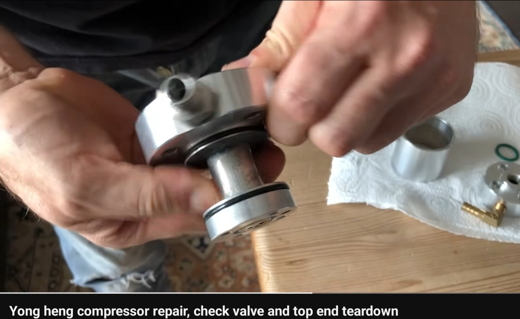

I don't think the cooling on mine has a small coolant passage like in your drawing, mine has a water jacket like this one in the pictures. I took these screenshots from a video on YouTube. Here's a link to the full video:
