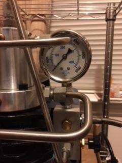

I put an M10-1male to 1/4" female NPT adapter on mine then added a good glycerin-filled gauge.

@tracker1955 great idea! just ordered all parts and follow the same idea!
Where did you buy the adapter and was it rated for high pressure.
