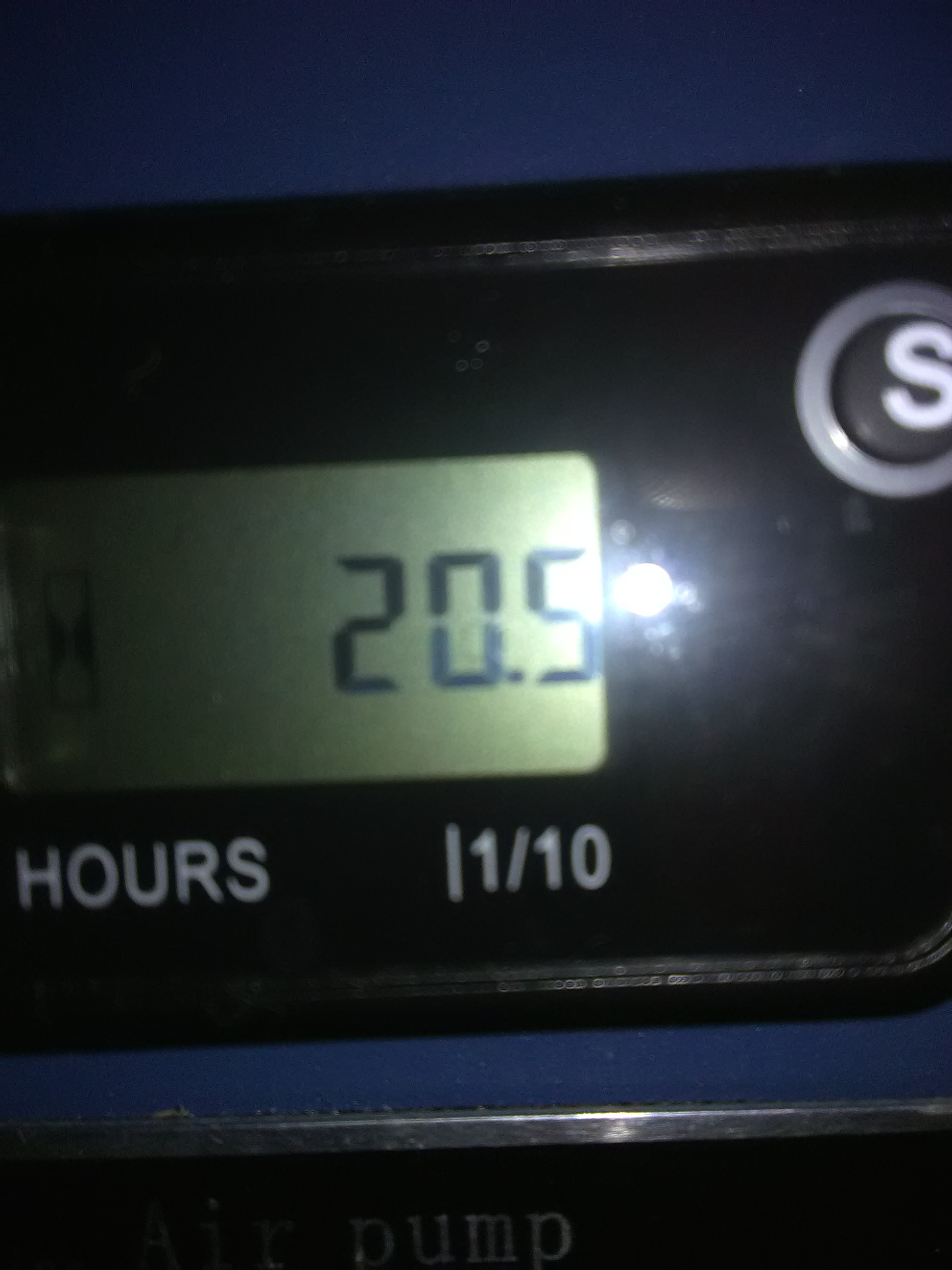

Can't swear my practices help oil to remain clear, you've seen the oil, here's a pic of my second hour-meter, initial one's batteries dying @ 7 hours run-time, both set to register strongest vibrations only. I'd say there's nothing to lose with a little experimenting. Best of Luck, WM
Reactions: Ponz

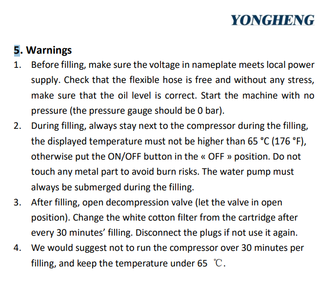

What temperature do you guys feel is too hot for the yong heng?
Does yong heng even post a not to exceed temperature?
Seems like I remember seeing 70C in the "manual" ? but I'm just working off memory so no promises. Mine's never been that hot. I remember hitting high 50's once, but that was without water cooling and the water was lukewarm to start.
This winter, with water from the spigot on the side of my house I'll top out around 46-48C after about 5 minutes, and it won't go any higher, and that's running it for as long as 20 minutes. I'm using the same water the whole run time too, not draining the outlet water like some do.

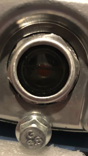

I have less than 20 minutes on this latest oil change before it turned black.
Same its black my seco lube right now its got bout 30 mins on it but you cant even see the red on the dot its that shaded over. I broke it in with husky full synthetic for an hour before though.
Well as of today its been like a few weeks scince I ran the compressor an I noticed the oil window I can actually see thru a bit now it seems like the dark particles that are in the oil all settled down an its clear im at 1.6 hours run time changed oil only once an that was after the first hour. But take a look at this picture it went from black to seethru in a couple weeks.
