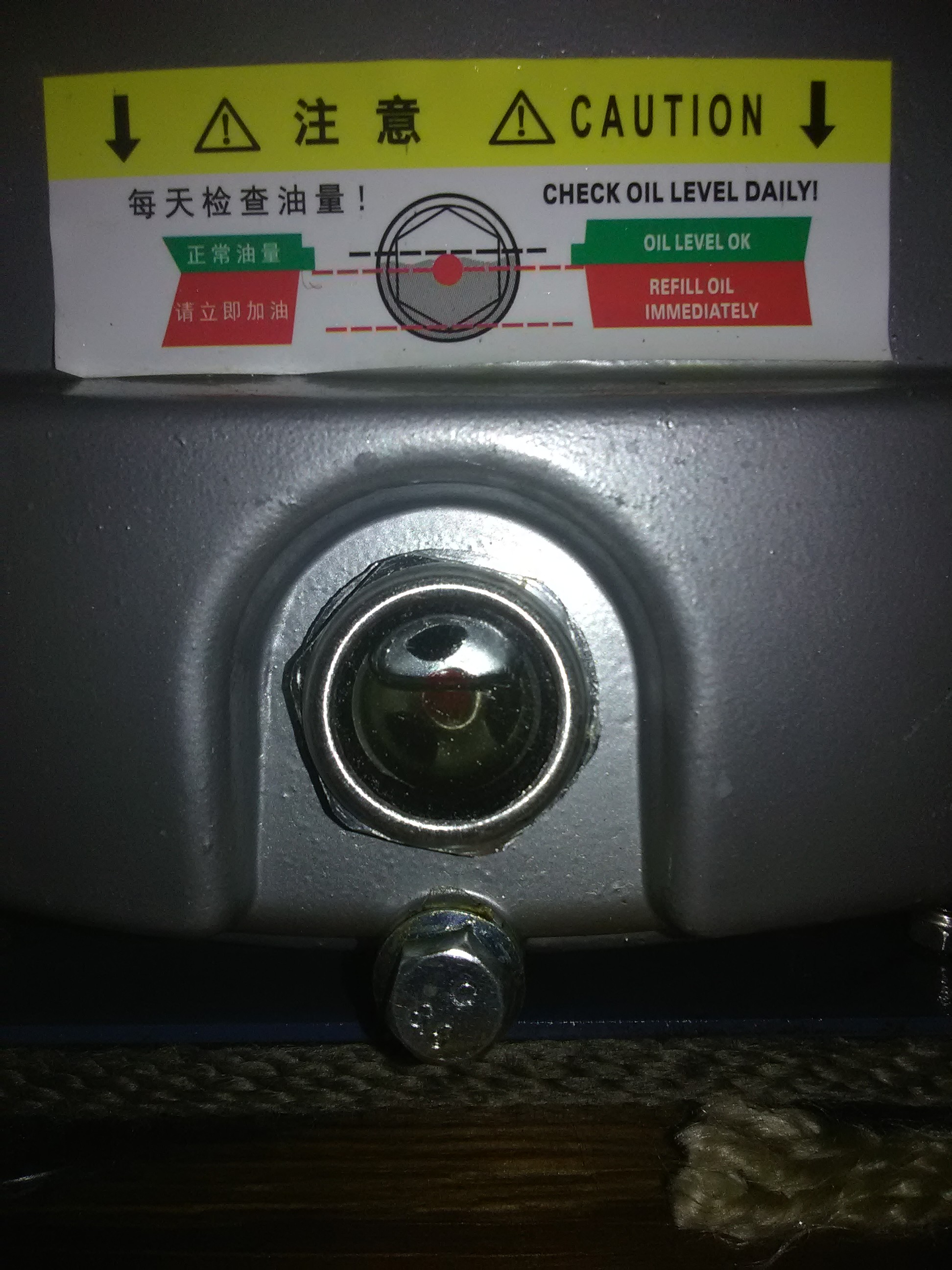

Serious question:
No matter which type lubricant I've used and please believe I have tried several, so please don't ask. The oil/lube turns BLACK way too fast. This past oil/lube change I've done nothing but fill my rifle about 10 times with an average fill time of less than a minute each.
I'm certain the compressor is on a flat surface, and I am filling to the top of the red dot as suggested.
Is it possible I'm overfilling or underfilling or maybe something else is askew?
From the manual:
Filtration and maintenance: The ISO VG46 hydraulic oil should be changed as soon as it changes color, each fill of oil is about 16 ounces. Change the hydraulic oil every 50 hours filling.
When I fill to the specified mark on the sight glass, she only takes 10/11 ounces.
So! Fill with 16 ounces or go by the sight glass??
Sorry for beating this dead horse.
Thanks - Ponz

John, ONLY fill to top of red dot in oil level indicator! Currently I'm using Husky Full Synthetic, non detergent & the discoloration factor is there but not as bad as Royal Purple, let's say. You have my # pal. If I can help, call me. I've stopped freaking about the discoloration, it happens. Going on 3 years STRONG with the YH but STILL baby it!

Annual oil changes for me, after initial 1-hour break-in change. Picture of Husky Full Synthetic Air Compressor Oil after 26 hours per vibration-activated hour meter. WM
