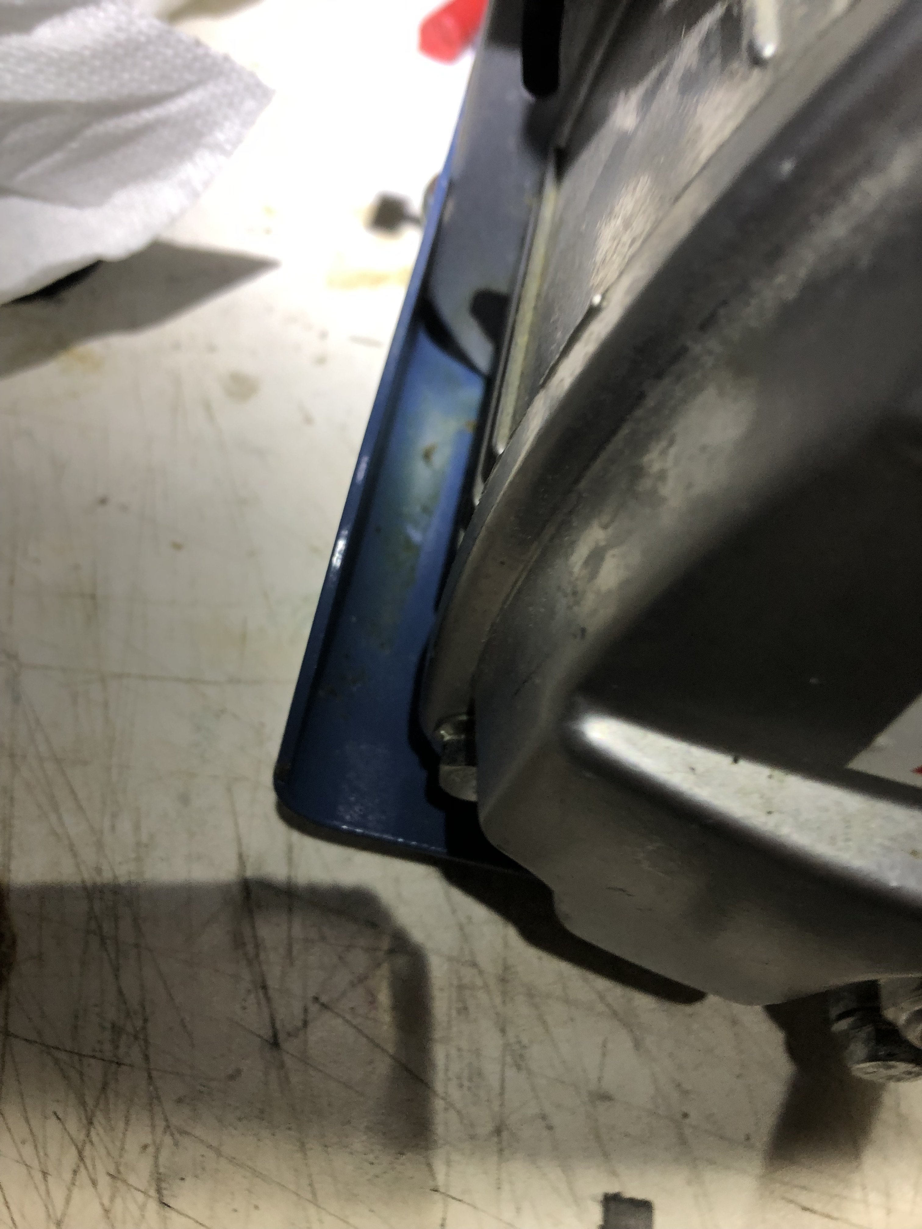

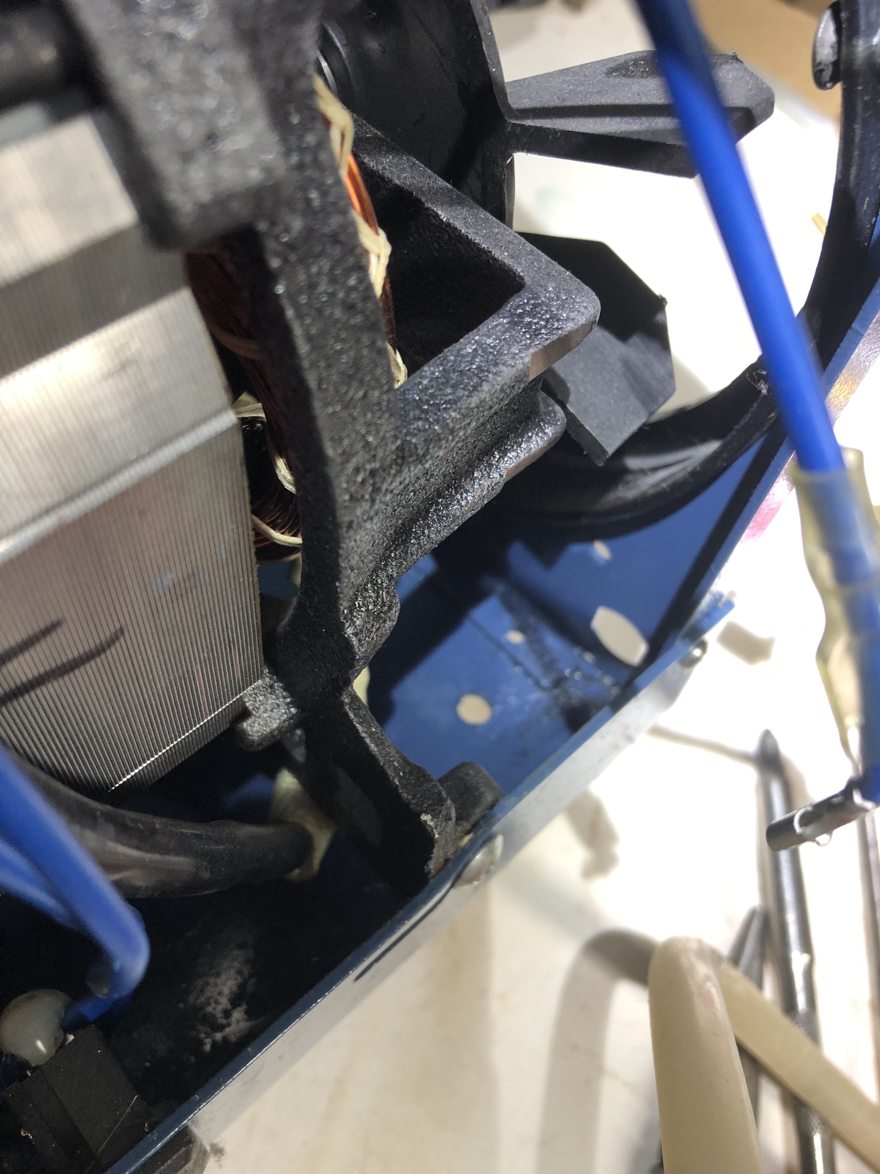

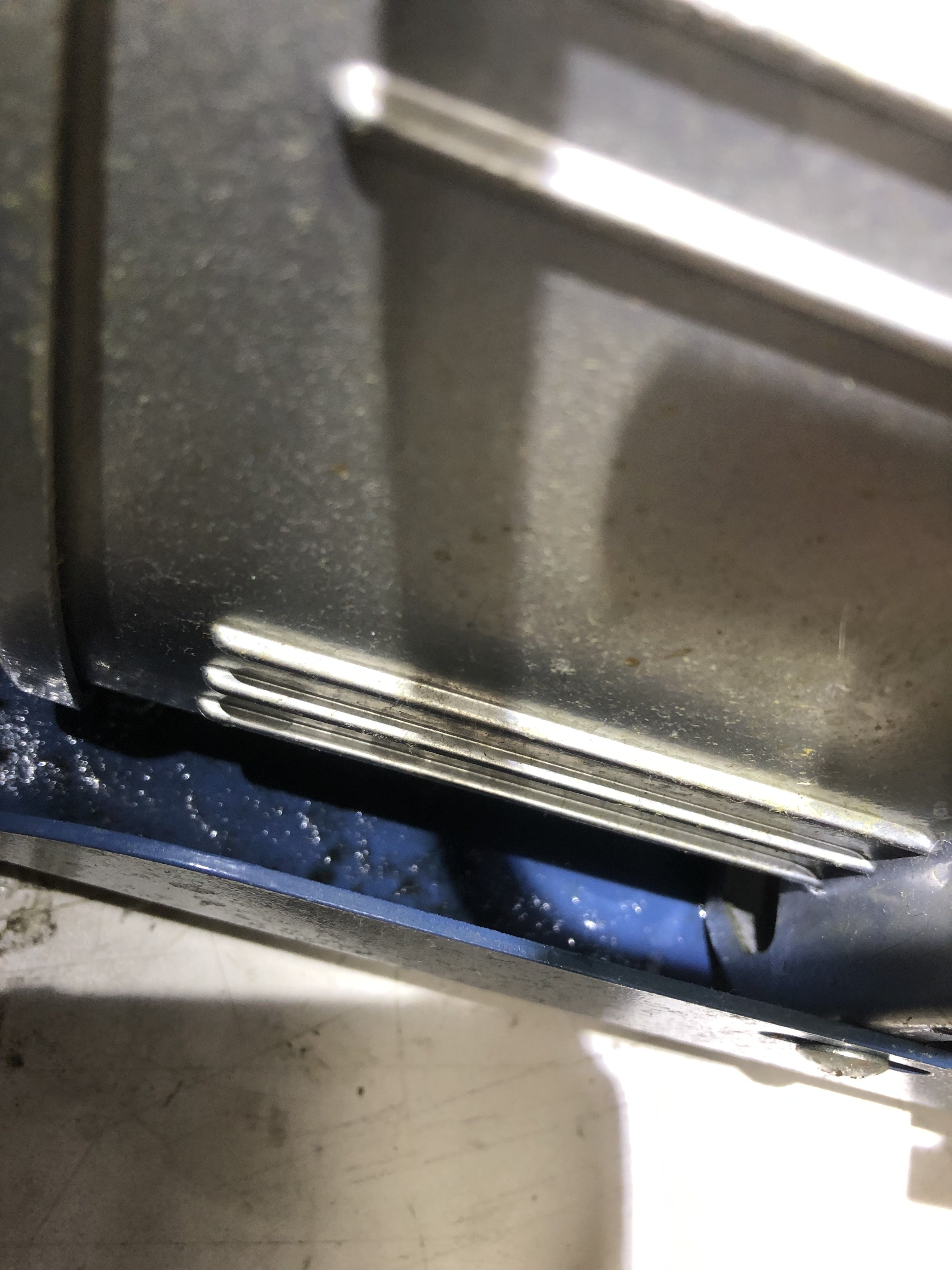

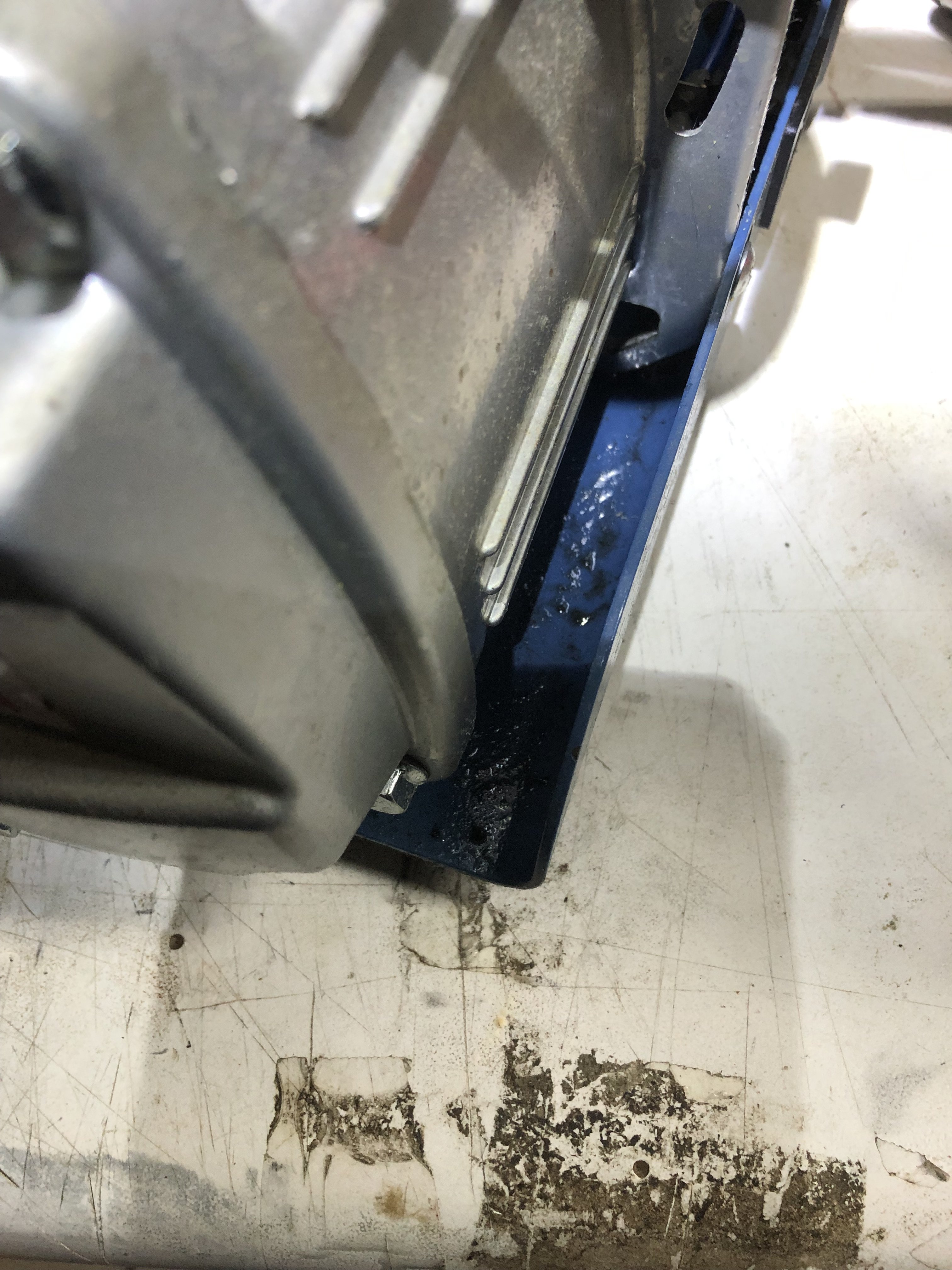

Noticed some oil on the bottom case, not a lot but enough to see a minor puddle. I did find where one back foot had vibrated off.
This compressor has never really cooled correctly, did the water pump up grade but no luck there. any guidance word be appercated.

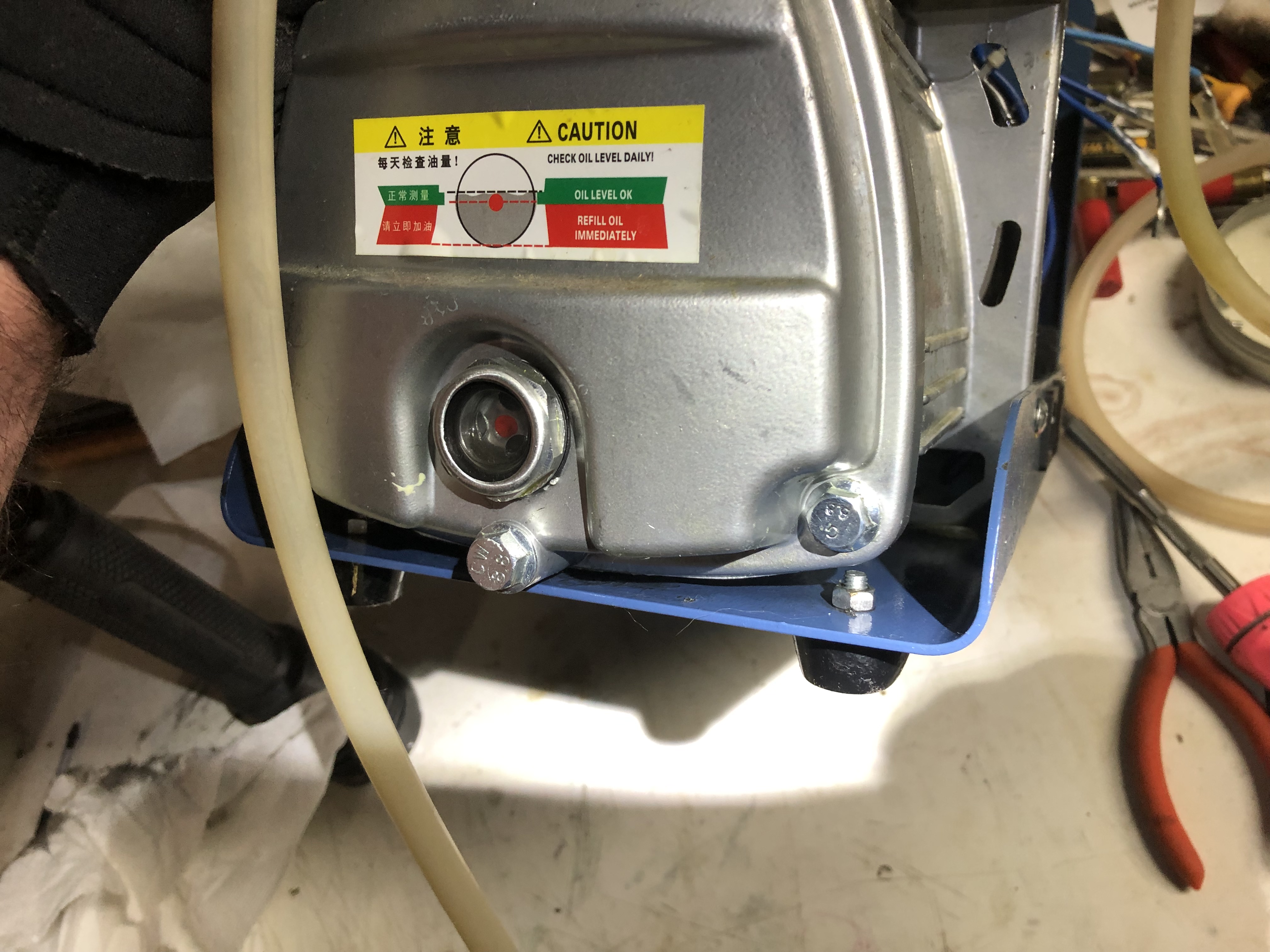

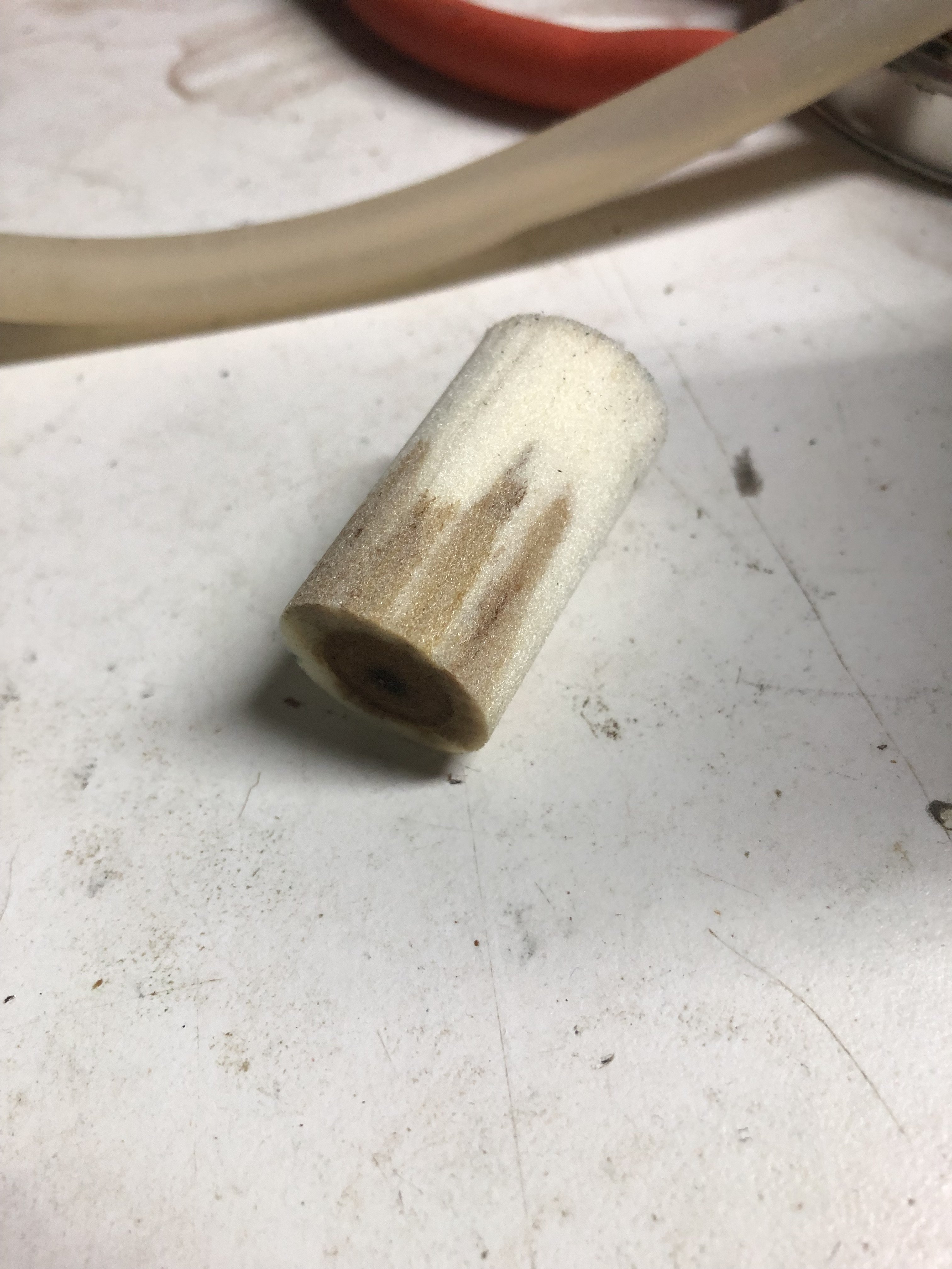

If the crankcase is overfilled with oil you could be getting oil collecting in and getting blown out of the moisture purge. These are directly over the areas where you show oil collecting. If it is coming from the moisture purge I would expect some oil residue on the casing as well. Can you send us a picture of the cotton filter and the oil window when the unit is level? I normally only get a small dot of oil on the cotton filter.

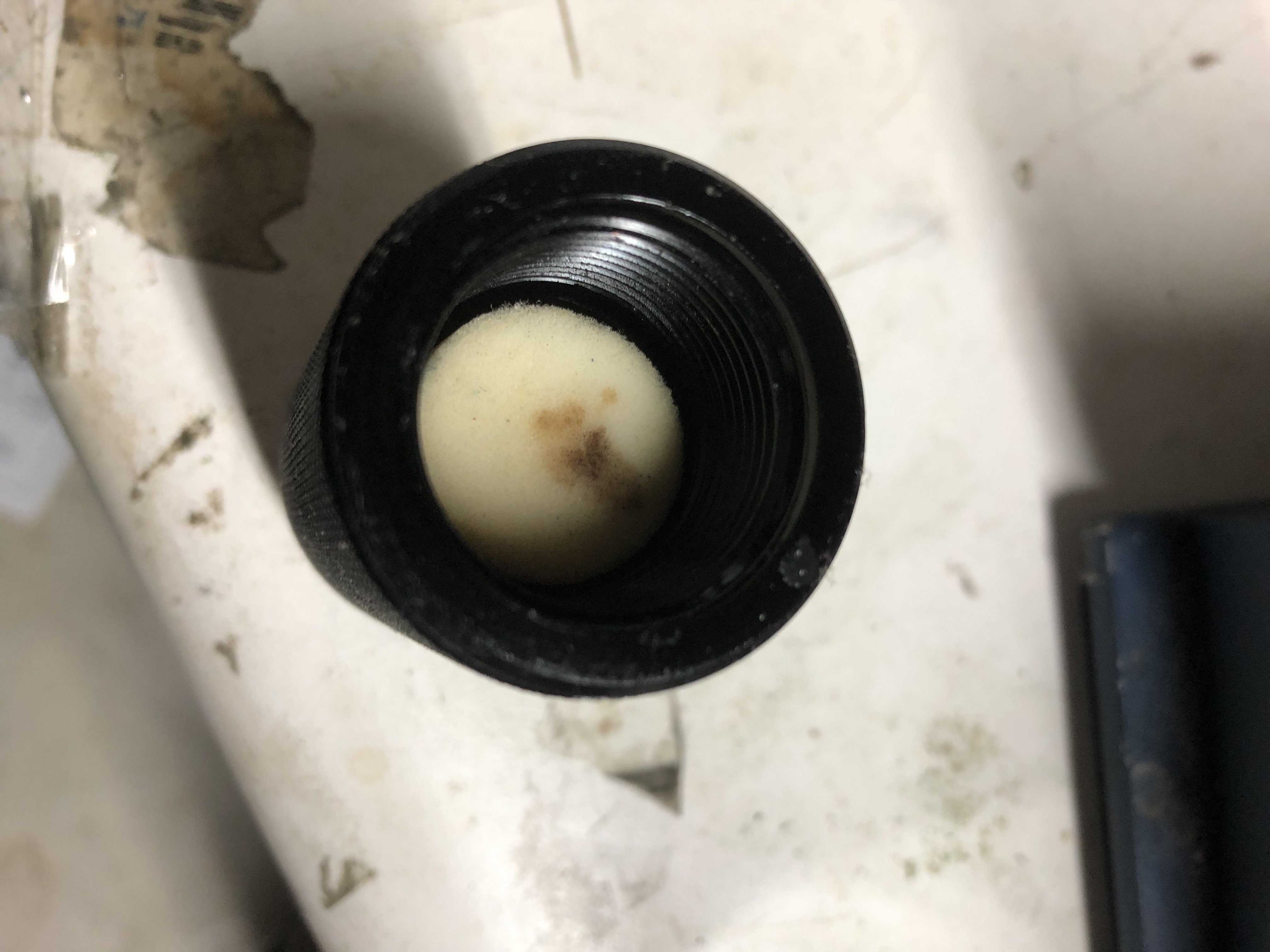

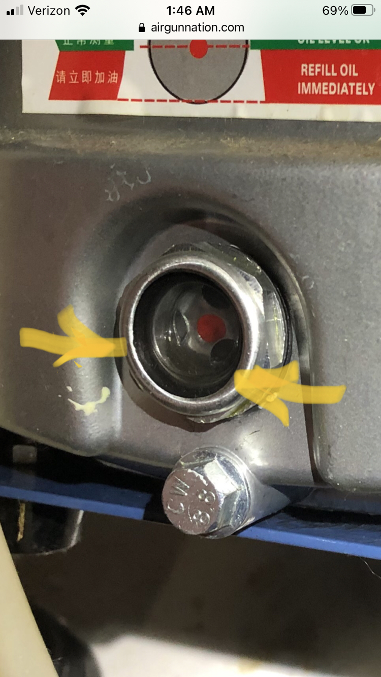

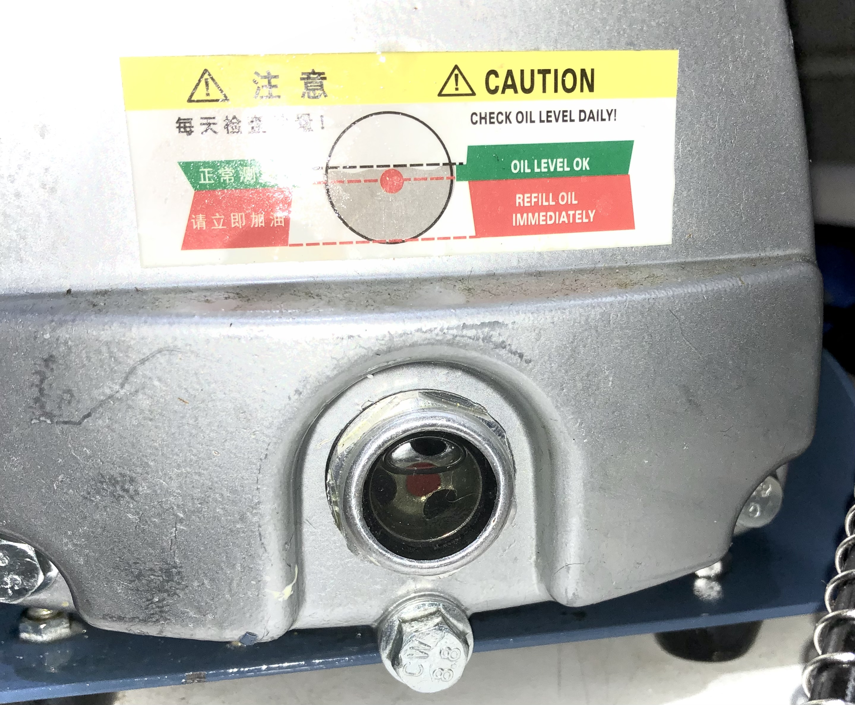

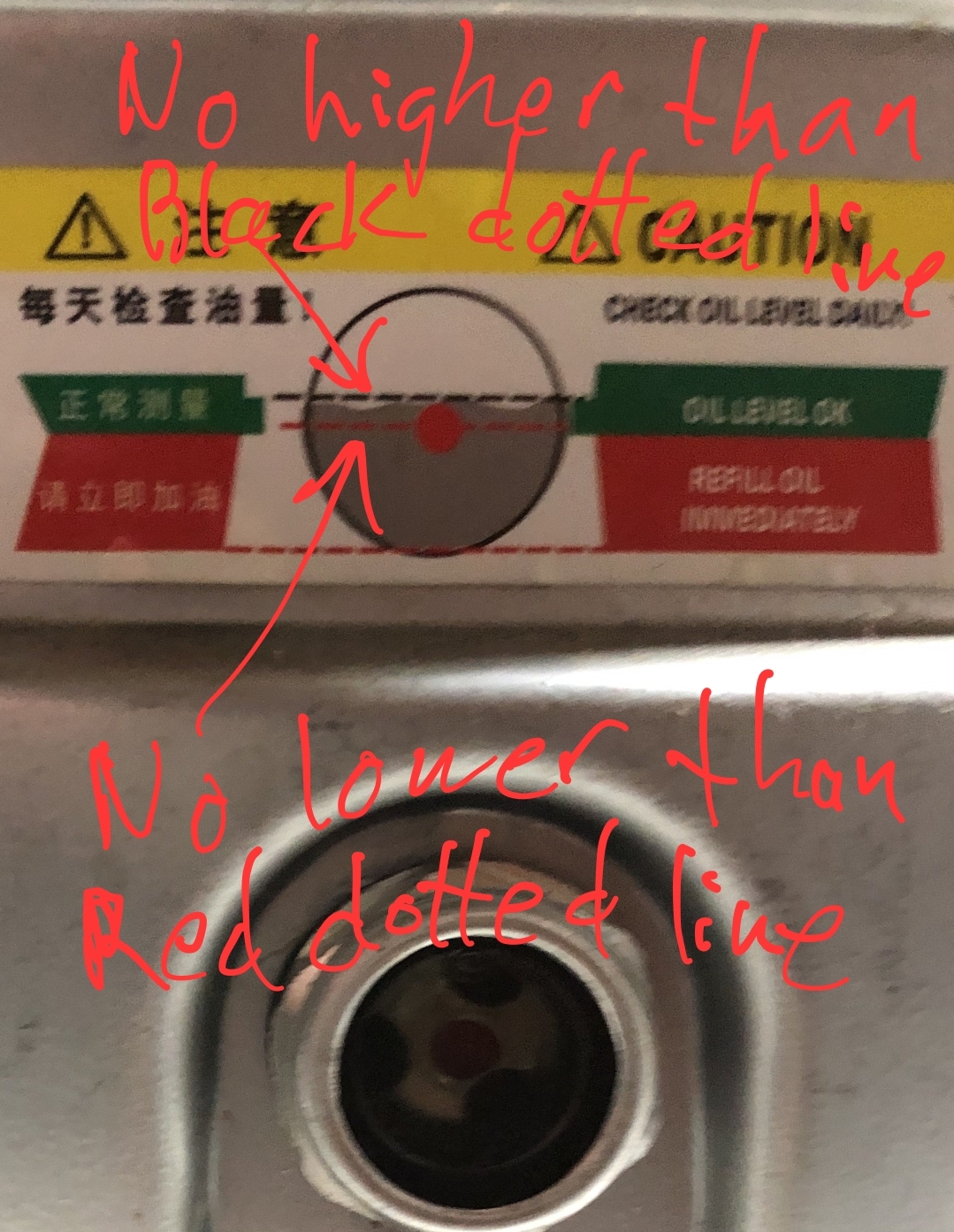

That is WAYYY more oil on the filter than I have ever had. The one dark spot near the middle in your second pic is the most I get. I have never gotten oil on the sides of the filter like in your third pic. However, I do switch out the cotton filter after each fill to let it dry out (filling a 74 cu ft tank). How often do you change the filter? In your first picture I can not see the oil level. I think that I "might" see a bubble at the top of the window. If that is a bubble then you have too much oil in the YH. The oil level should be level with the top of the red dot.

Your cooling issues could also be the result of the oil level being too high. I would remove the top end and clean everything to avoid the possibility of future problems such as: carbon build up on reed valves leading to loss of pressure / slower fill times, oil migration through fill lines, possible oil detonation (depending on oil used), and premature wear on high pressure piston seals. Not trying to be all gloom and doom but those are possibilities if you just drain, refill to proper level, and run it. It might be perfectly fine to run it and blow the excess oil out; depends a lot on what oil you used.

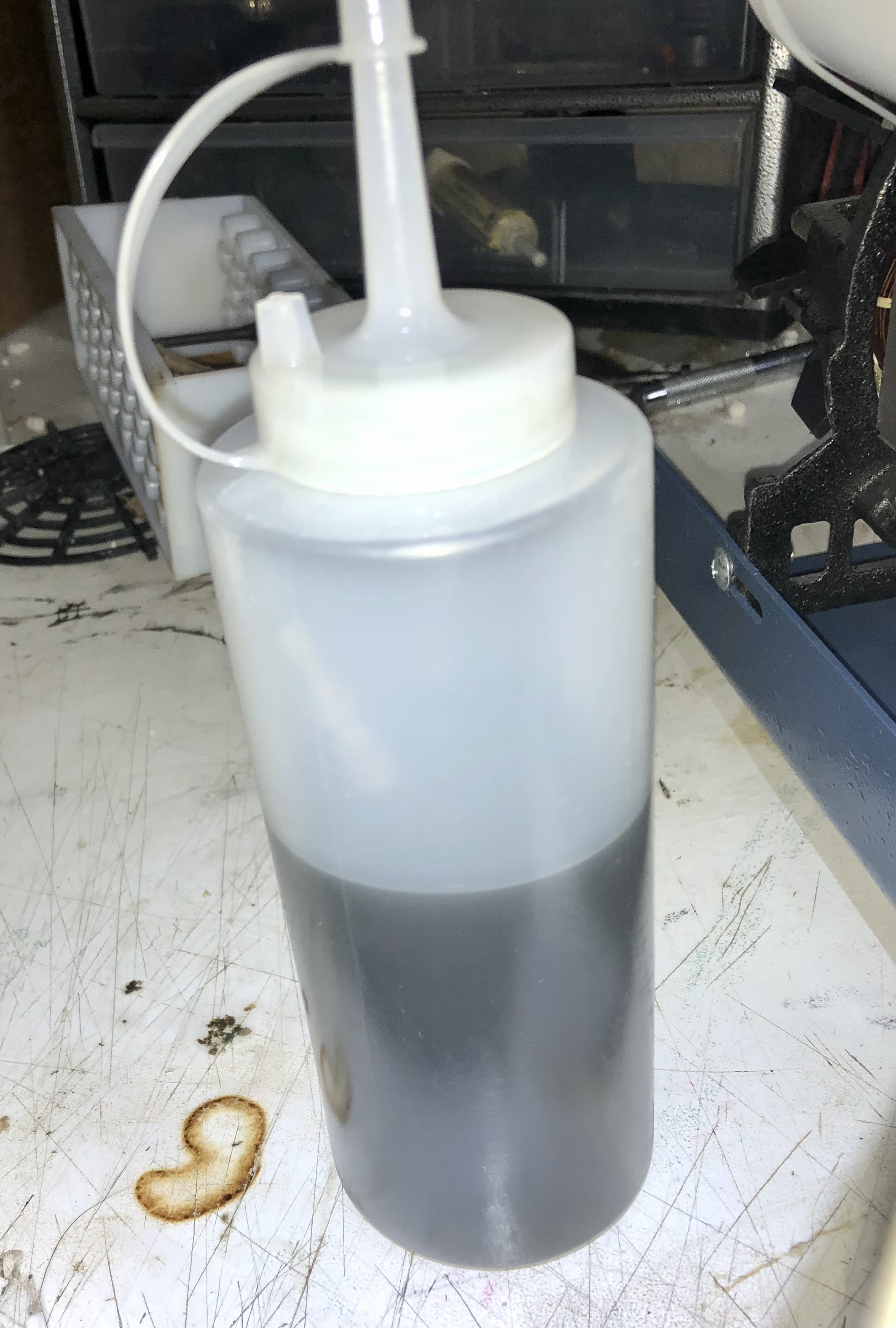

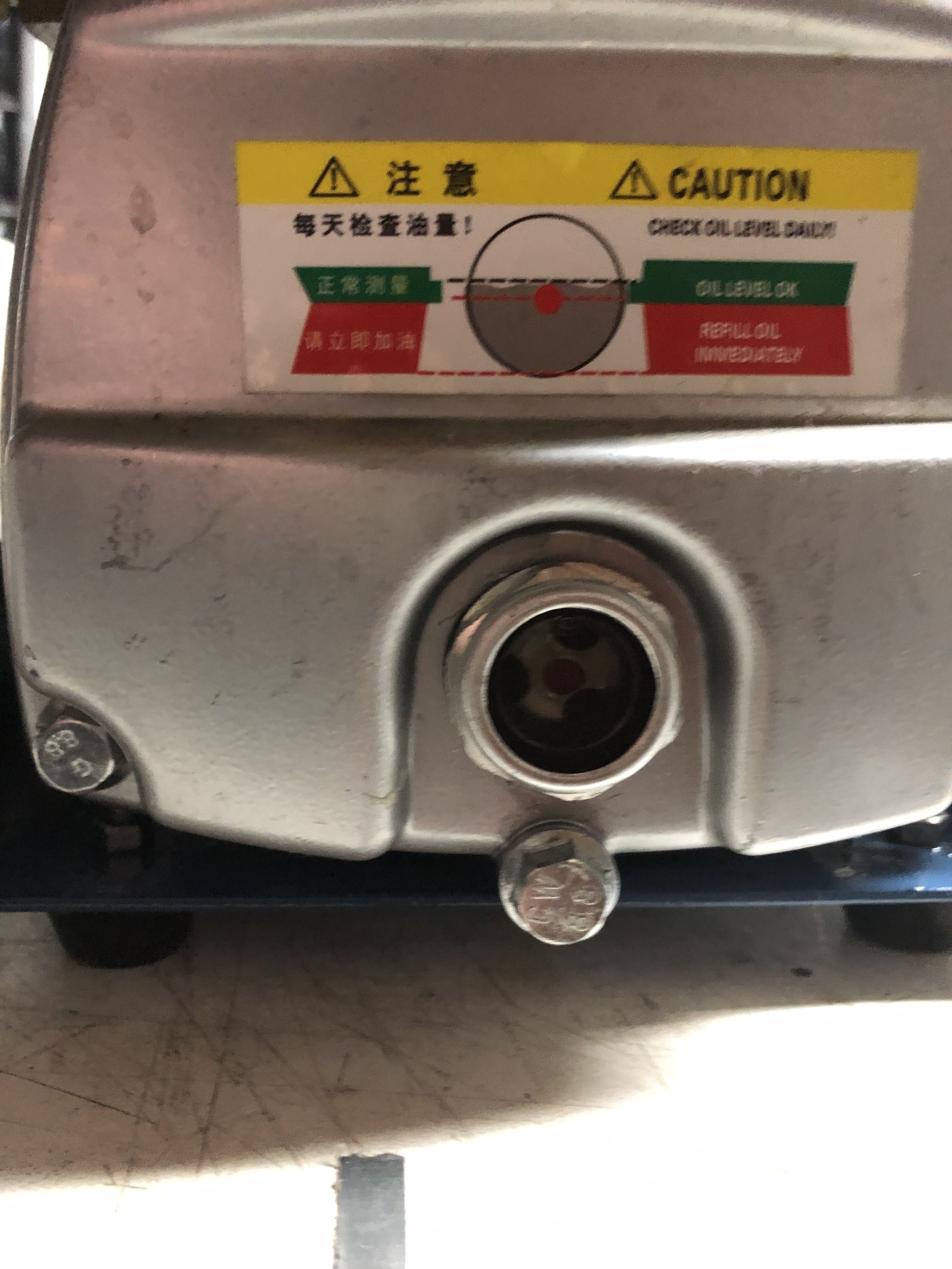

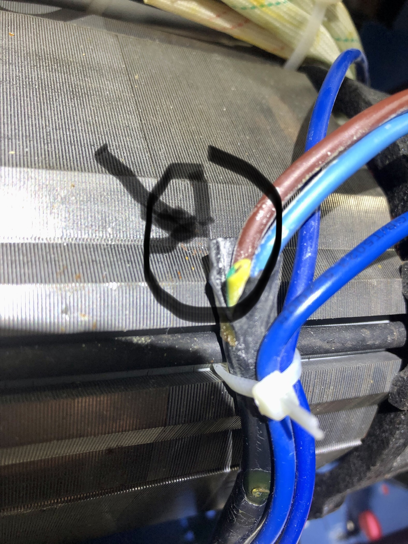

You guys nailed it, grossly over filled. Drained the oil to required level, cleaned up all the excess oil and put it back together. Here are some pictures of the current oil level and also the excess oil I drained out. On the wiring harness there is a green and yellow wire that was not used when the unit was built. Is this possibly the wire you would use for the automatic shut off function? Thanks to all you guys for the help and information. Going to fire it up tomorrow and fill some Guns.
