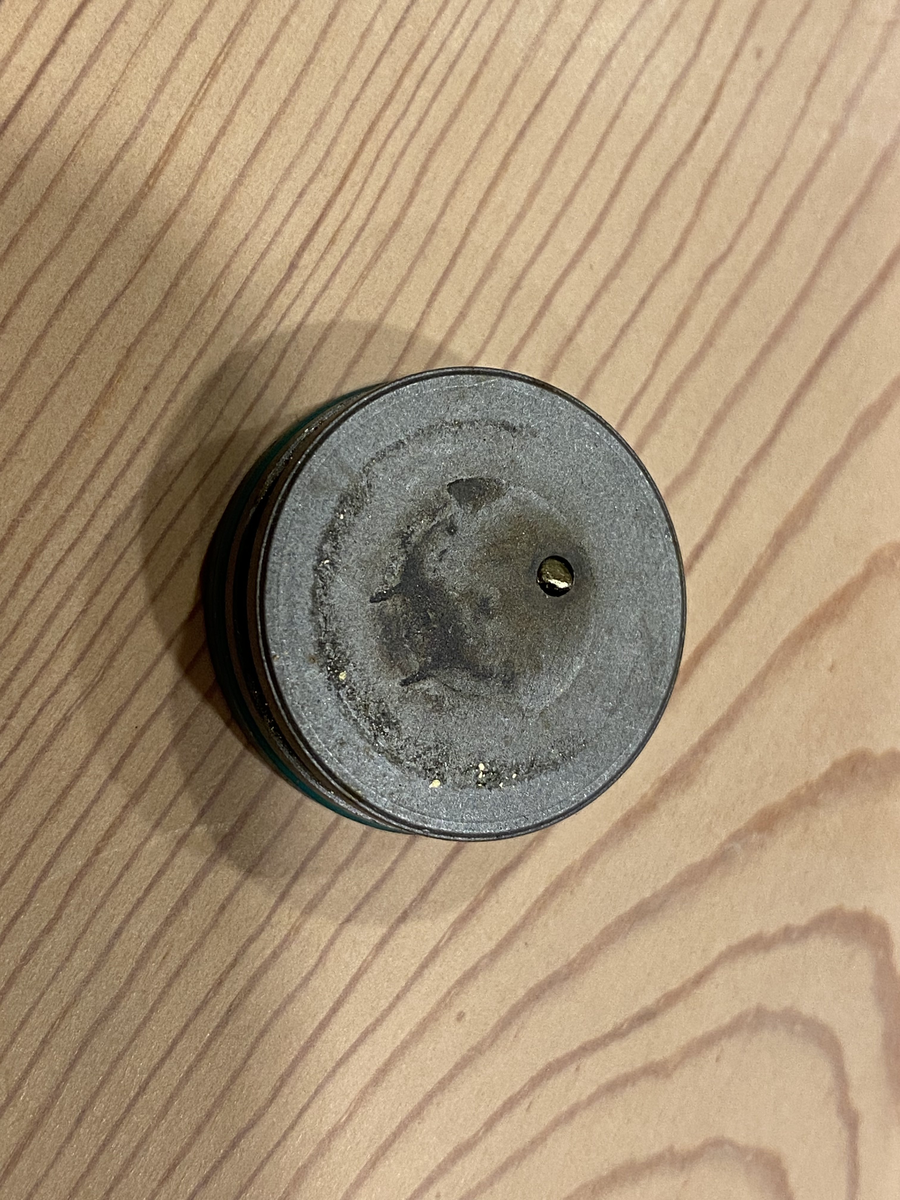

Interesting - I found this thread which led me to the Second Stage Valve Base (part #6) on the IPB. Looks like the hole in my 2nd stage valve base has a piece of the tip of the pencil high pressure piston lodged in it. I had replaced the pencil piston since the tip was broken - looks like a piece of the tip got lodged in this 2nd stage valve base hole. I’ll try to clear the hole and see if this is the culprit on why I’m getting back pressure into the crankshaft and thus lots of air out of the breather valve.
