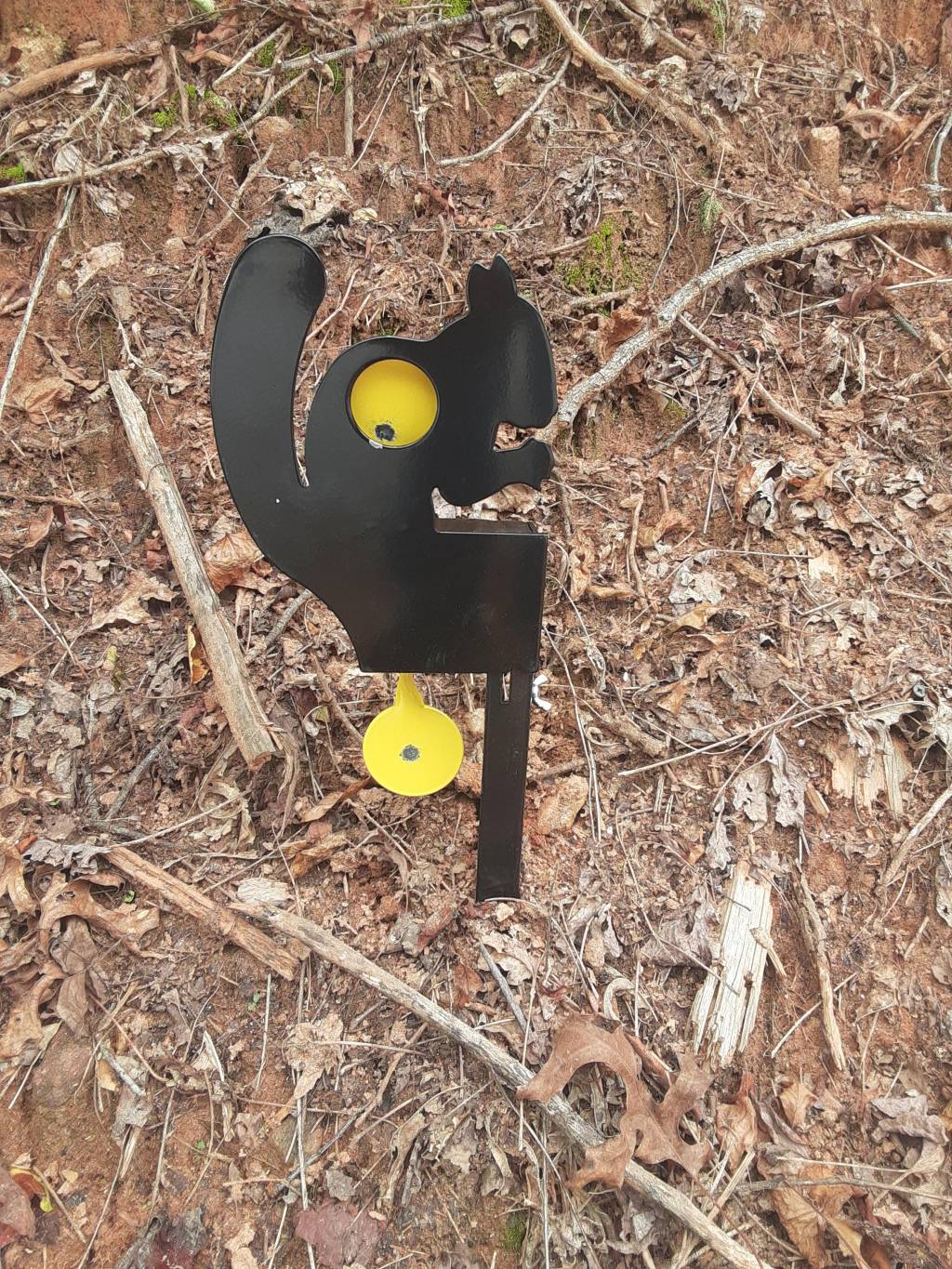

The flashpup is driving tacks once again. I tried blowing the fill port out with 220 pounds of air but it didn't help. I pulled the fill valve and there was a tiny speck of o ring stuck to the valve seat. I also found two small chunks in the tank as well. Cleaned it and put her back together and all is well. That crosman squirrel target is catching hell today to put it lightly.
