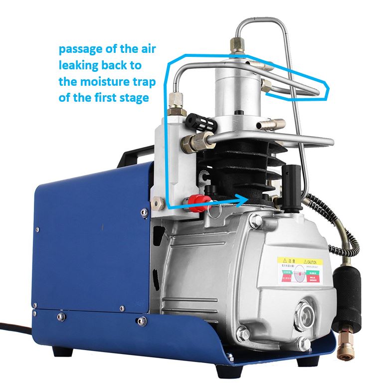

I pulled my YH apart to upgrade the first-stage piston last week and I took the chance to checked out what causes the hissing at the low-pressure relief valve after the compressor is shut down.

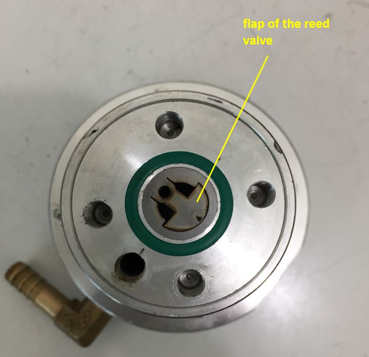

Between the outlet of the first stage and the inlet of the second stage, there is a reed valve sitting at the top of the second-stage cylinder :

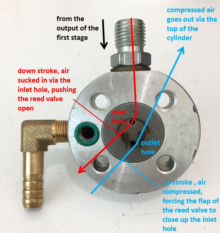

The valve works like this : When the second stage piston goes down, air is sucked into the cylinder and the inward air flow pushes the flap of reed valve downward to open the valve. In the up stroke, the flap is pushes in the opposite direction and the valve is closed.
The reed valve is just a piece of thin metal sitting on top of a hole. There is not any O ring or things alike so it should not seal too well. Immediately after the compressor is shut down, the pressure in the second-stage cylinder is still high so air can be driven back to the moisture trap of the first stage via small leaks in the reed valve. When the pressure so created in the moisture trap is high enough, the pressure relief valve will be vent.
What I don’t understand is why this did not happen over the last year but only recently. Does it indicate some kind of degradation in the reed valve ? I cannot see any visible signs. Anyway the filling time is not affected so I think I will just leave it like that for now.

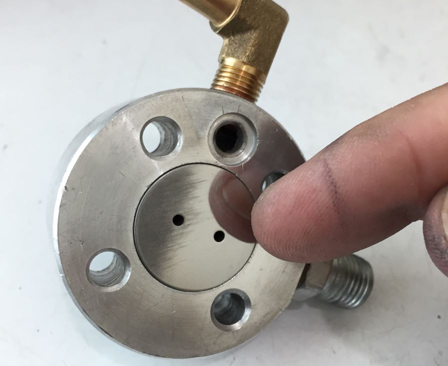

I have got some spare time today so I decided to dig into this issue trying to find out the cause.

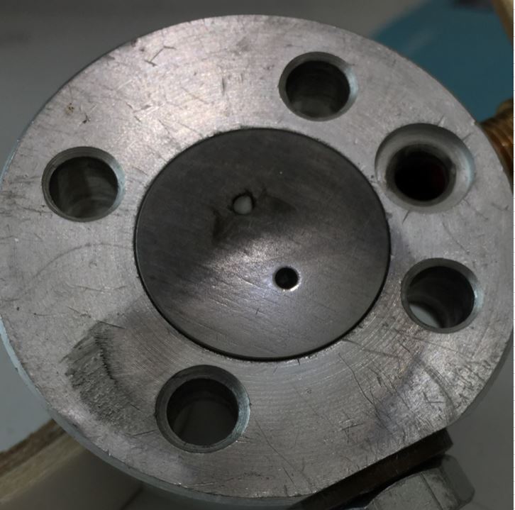

Upon close examination , I noticed that the metal surface the reed valve sits on is not very smooth :
I polished the part around the inlet hole ( where the reed valve sits on ) to a mirror finish :

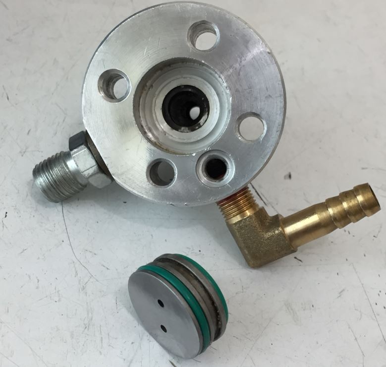

Just when I was about to re-assemble it, I found that the center piece ( made of steel ) of the cylinder head is removable :

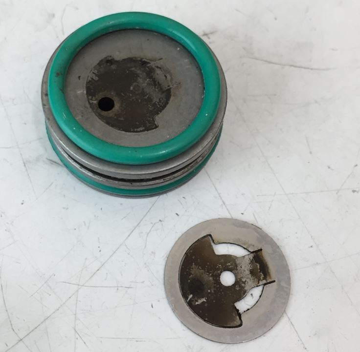

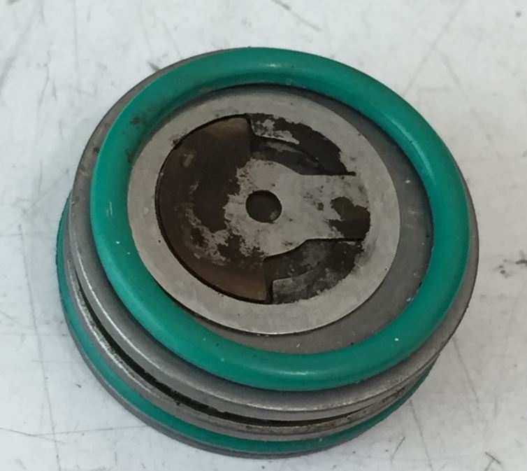

There is another reed valve on the other side of the center piece guarding the outlet of the second stage. The purpose of this valve is to prevent high pressure air in the stainless tube from getting back to the second-stage cylinder. The valve is VERY dirty as you can see :
I then cleaned it and put everything together before firing it up again. DA DA ! no more hissing at the first-stage relief valve after the compressor is shut down ! I concluded that the cause is the dirt accumulated in the reed valve preventing it to close fully. The polishing work could not be the fix because this symptom did not exist when the compressor was new. There has been a report on youtube that dirt accumulated here have caused failure to build up pressure so may be you guys will check this part out in your next rebuild.
