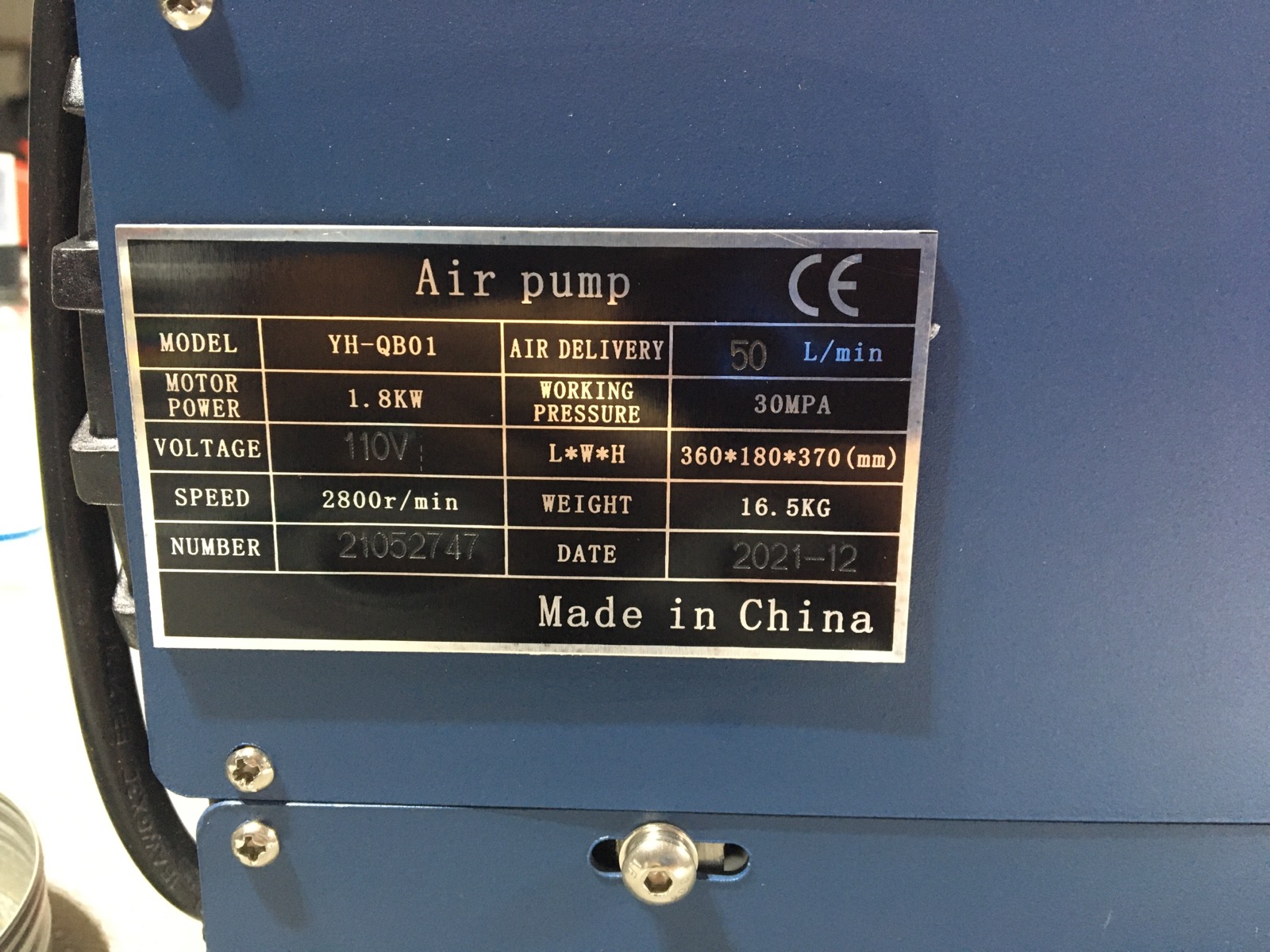

I bought one on Ebay that did not have the YH painted on the side of the cover but has the black ID label that it is a YH compressor.
The dealer assured me it was a YH.
This is my second YH, which lasted about 3 years so I'm pretty familiar with the break-in process and using it.
Despite this, the second one lasted for I would guess less than 3 hrs. Definitely a lemon from the get-go.
After much messaging back and forth from the seller they agreed to take it back. I suspect my contacting Ebay helped.
Needless to say, I will never buy an off-brand YH even though it just has a black label saying it is genuine.
From what I gather others have had good luck with them.
From what I gather others have had good luck with them.View attachment 276855
I haven't seen any genuine ones with that plate, glad you got it sorted. I wouldn't put it past the other makers to not be shy about putting YH on these copies by using these plates.
