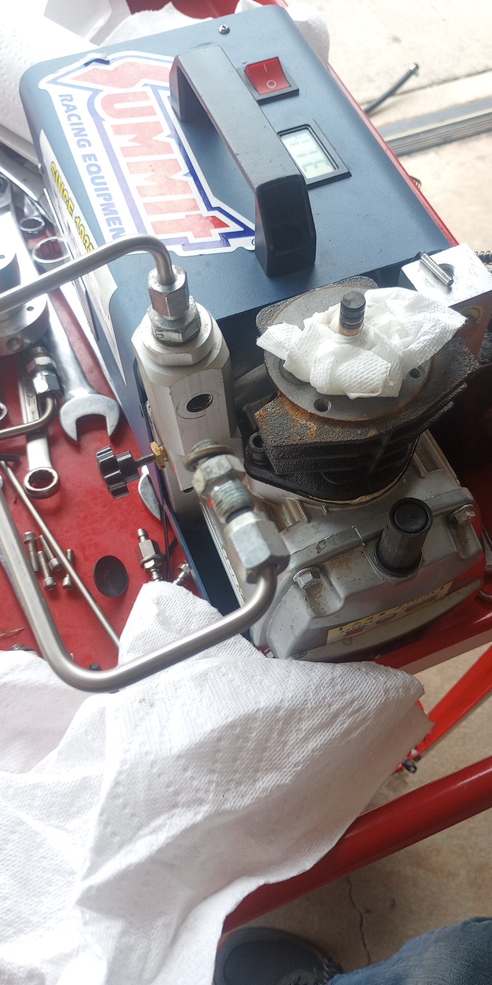

Yong Heng junk!!!!! Time for a altaros booster pump
What's everyone's thoughts on a altaros booster pump I'm sick of these junk ass Chinese compressors how long does it take to fill a 45 min 66cf tank from 3000psi to 4500psi...
Reactions: RM.510bigbore
How long did it last you? What happened to it?
Maybe it was half my fault my water hose had a bunch of trash in it and I didn't know and it clogged it up I cleaned it out everything good there but the threads got messed up from the factory im gonna fix the threads with a tap ive had it for 7 months

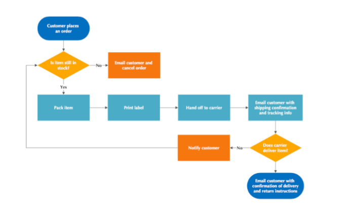

We should have a “decision flow chart” (see example below) that can guide someone through the process of keeping a PCP refilled when needed that would assist people on the direction to go.
No offense to zeroc, it comes up in discussion often.
