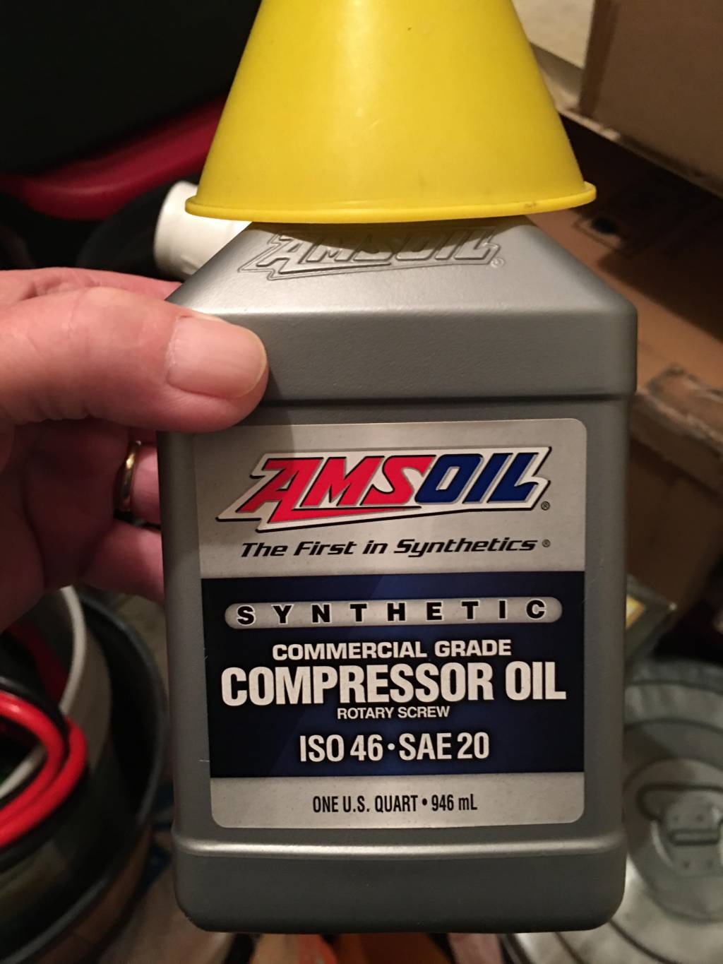

This is what I’ve used in my yong Heng for 2 years never any issues knock on wood just keep it changed regularly, oh it’s only $9 quart at Napa auto
