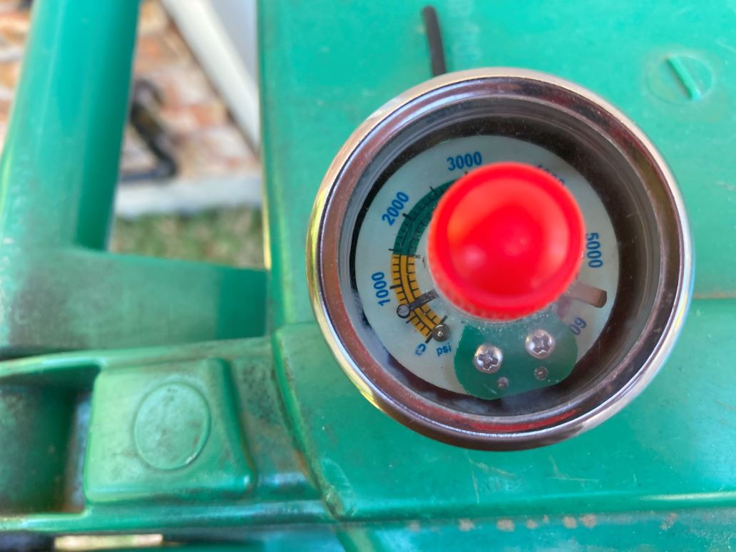

My 2019 first failure on Yong Heng. New auto shutoff gauge was $24 on the bay.
I’m still using the Seco Lube 500 however I wrote Lawrence Factor asking for guidance on why this oil turns black after an hour of runtime and if this is a real issue from detonation or other. Curiosity kills me every time.
My YH gauge conked out too, just short of three years. Since I don't use set pressure function, borrowed a liquid-filled gauge from my Chinese HPA handpump, screwed right in, works great. Changed to SecoLube 500 in November, clear as just from container when inspected last night. What temperatures are you experiencing during typical operation? WM
Hey WM, I didn't have any gauges that were bottom sealed, just some old NPT paintball stuff. I could have ordered a non set point one for $15.
