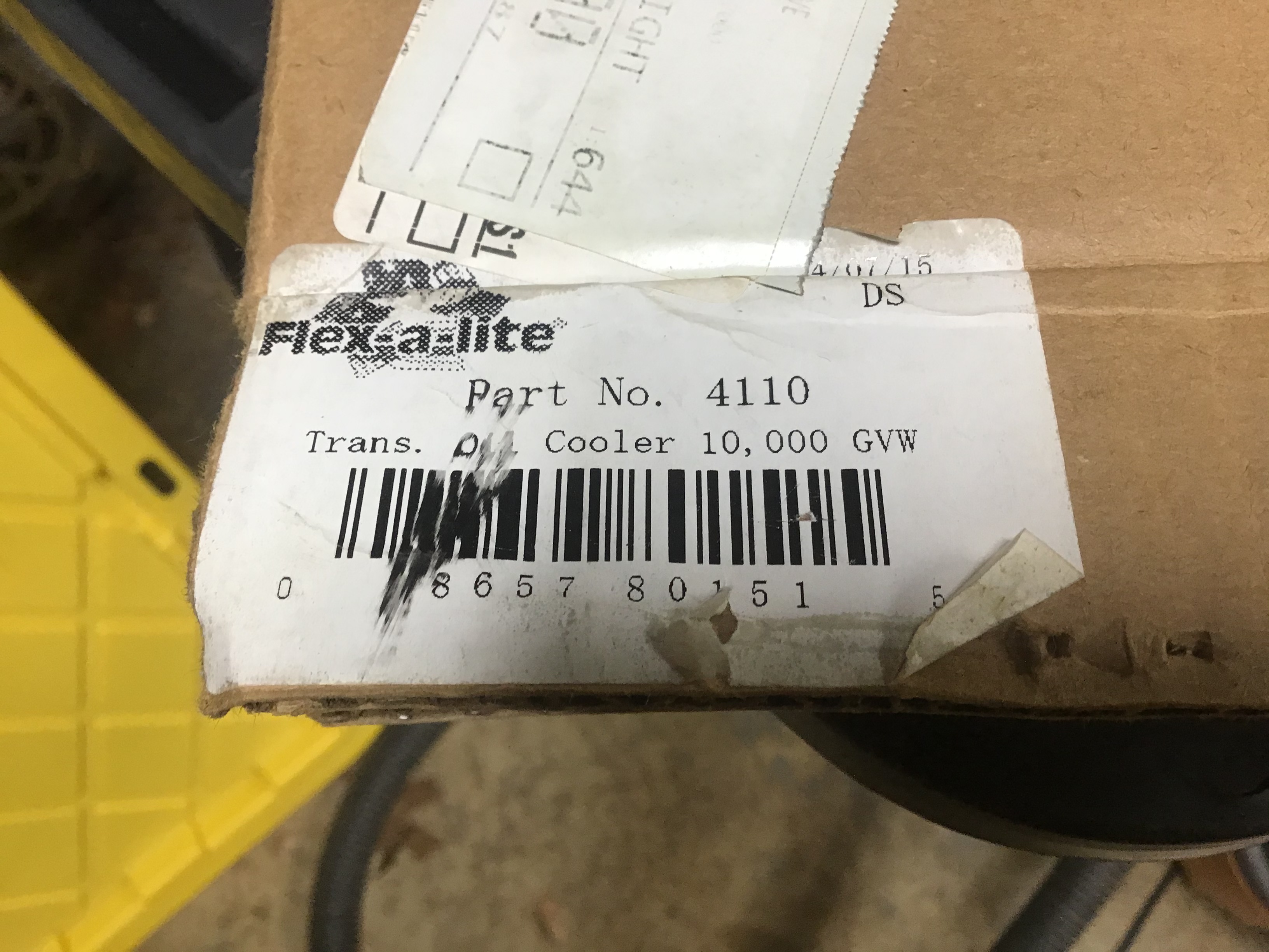

Heavyopp - where did you get the radiator? Do you have a purchase link? Looks like a fine setup.​
I’ve had this radiator in a box for awhile, bought for a tig cooler project but went a different route
I think it was from amazon but not sure. Searching the part number on amazon doesn’t bring up the exact picture but I didn’t look real hard. The one I have happens to have the right sized barbed fittings.

That small trans cooler seems hard to find — here’s one on ebay...
You can buy a universal inline transmission cooler at just about any auto parts store. Find them online cheaper, just gotta wait on shipping.
