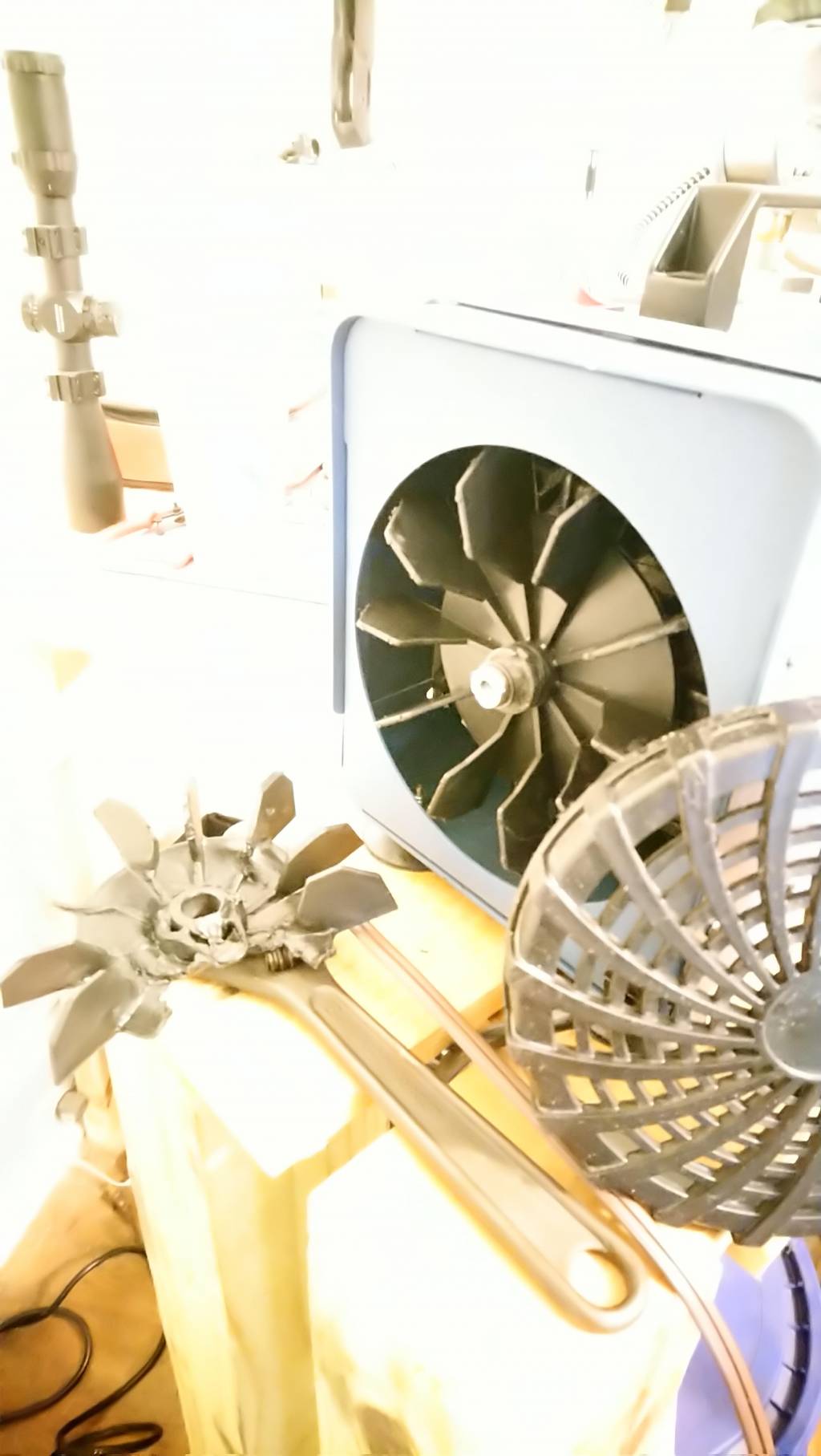

I have a much larget rear cooling fan, too. Easily 5x more airflow

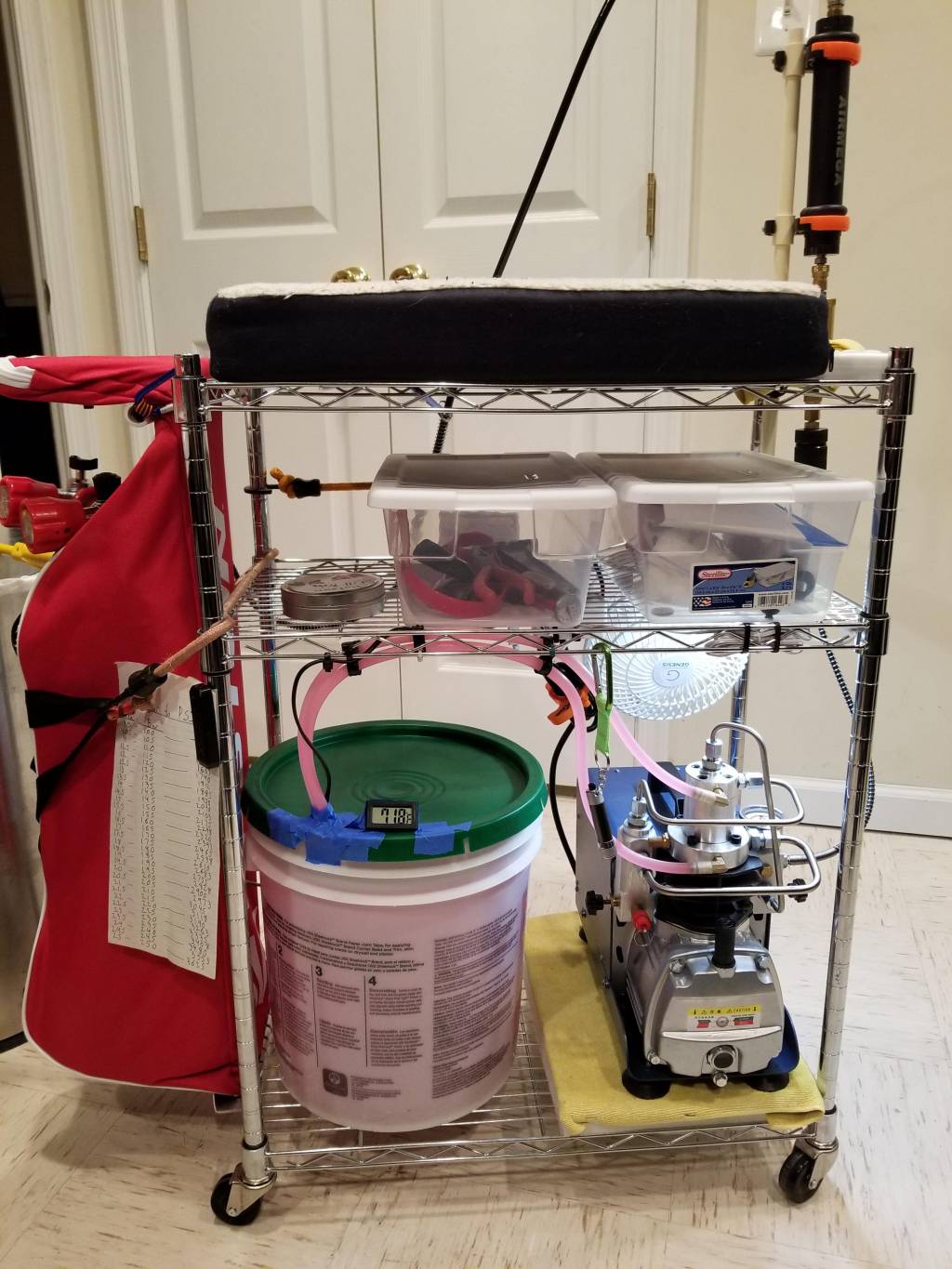

Lots of different setups for YH cooling have been put together, as noted above. I use a standard tool box that holds roughly 2 gallons and add ice to that. I believe that the smaller water volume allows a reasonable amount of ice to cool the water more than a larger volume of water allows, but that is JMO. I also use a ducted fan blowing across the unit while running and it definitely does lower running temperatures. Over 3 years on mine now.
The YH requires two types of cooling. Water cooling does the piston while the motor is air cooled. I work in 95 to 100 F (40C I believe) shed when filling. Ice and a 5 gallon bucket only last so long. So, I follow the keep filling the bucket and pump the water out routine. Keeps the piston area nice and cool at under 50C. In the hot conditions, the motor will last about 20 minutes before it shuts down. So, I run for 15, stop, run for 15, stop and wait kind of filling. When the weather cools this fall, I'll be able to run it longer. Haven't put a fan on the motor yet due to location, but will be doing that soon.
