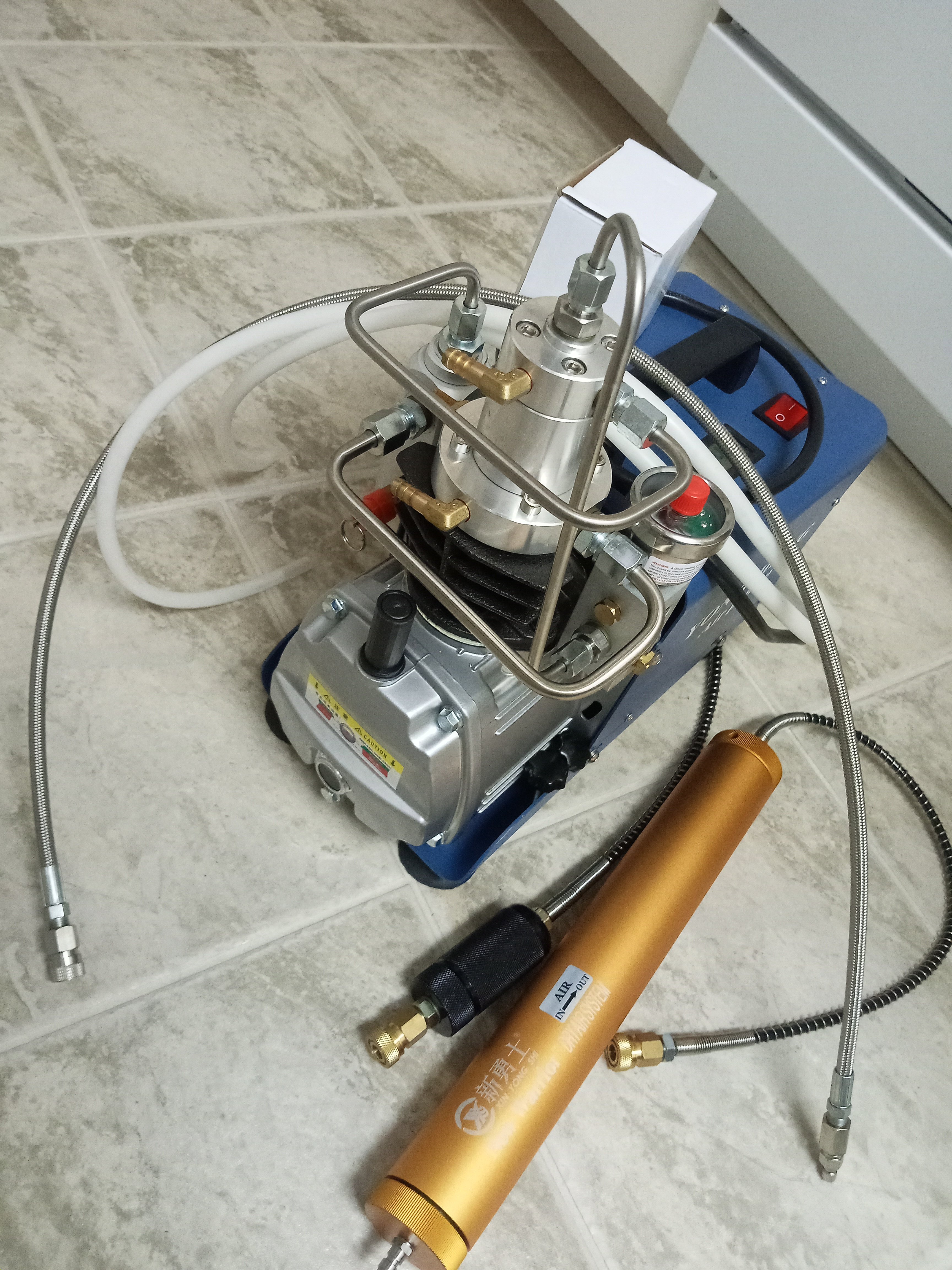

Well I got my first Yong Heng today. Here are the pics. It does have the plate but look at the date of MFG. 2021-8. It did ship from the states, NH. Took six days to get here. so for $190 + $10.26 shipping might be a good deal if it isn't a rebuild. Packed like it was new. Being my first not sure I would know. Bought on Ali Express at the Yong Heng store. Here is the link. Guess it's time to hook it up and see if it smokes!

One reason I'm not fond of young heng is the motor rating of 2800 rpm. That suggests the motors are designed for 50 hertz not 60 that is typically used in the United states. Note the lack of a frequency rating on the name plate interesting. Therefore for people using it on 60 hertz it spins at a higher RPM than it is designed for overheats and burns up rings faster than it otherwise would. That combined with having a 300 MPA rating with only two stages shortens its longevity.
