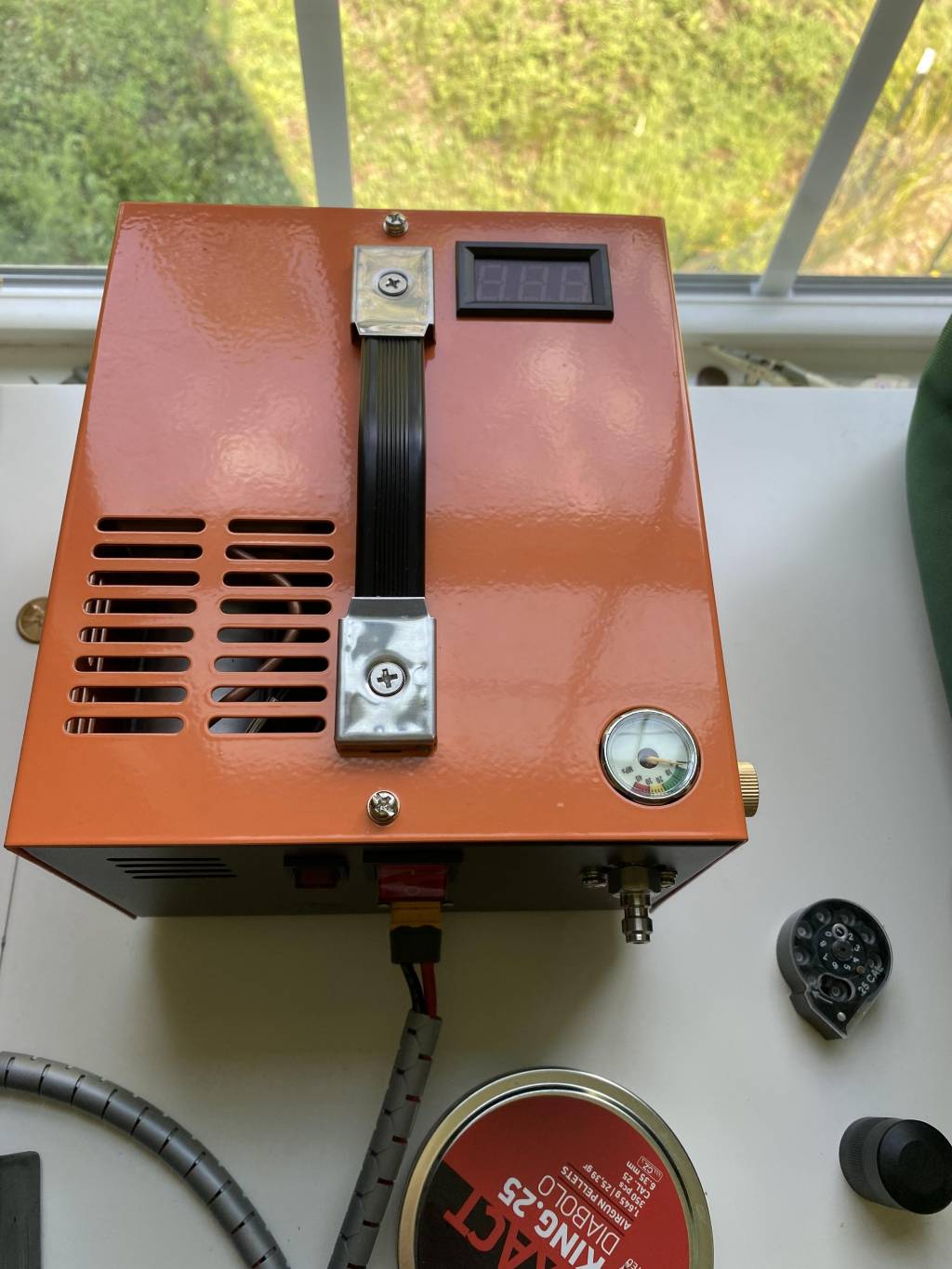

So I received a knockoff 12v portable compressor from eBay on Jun 23rd. It quit working today. The fan runs, but hitting the pump power switch doesn’t do anything. It was only used to fill my marauder 25 and never let the temperature go over 45C. I plan to return it and try a young heng compressor. ThT might last longer.
