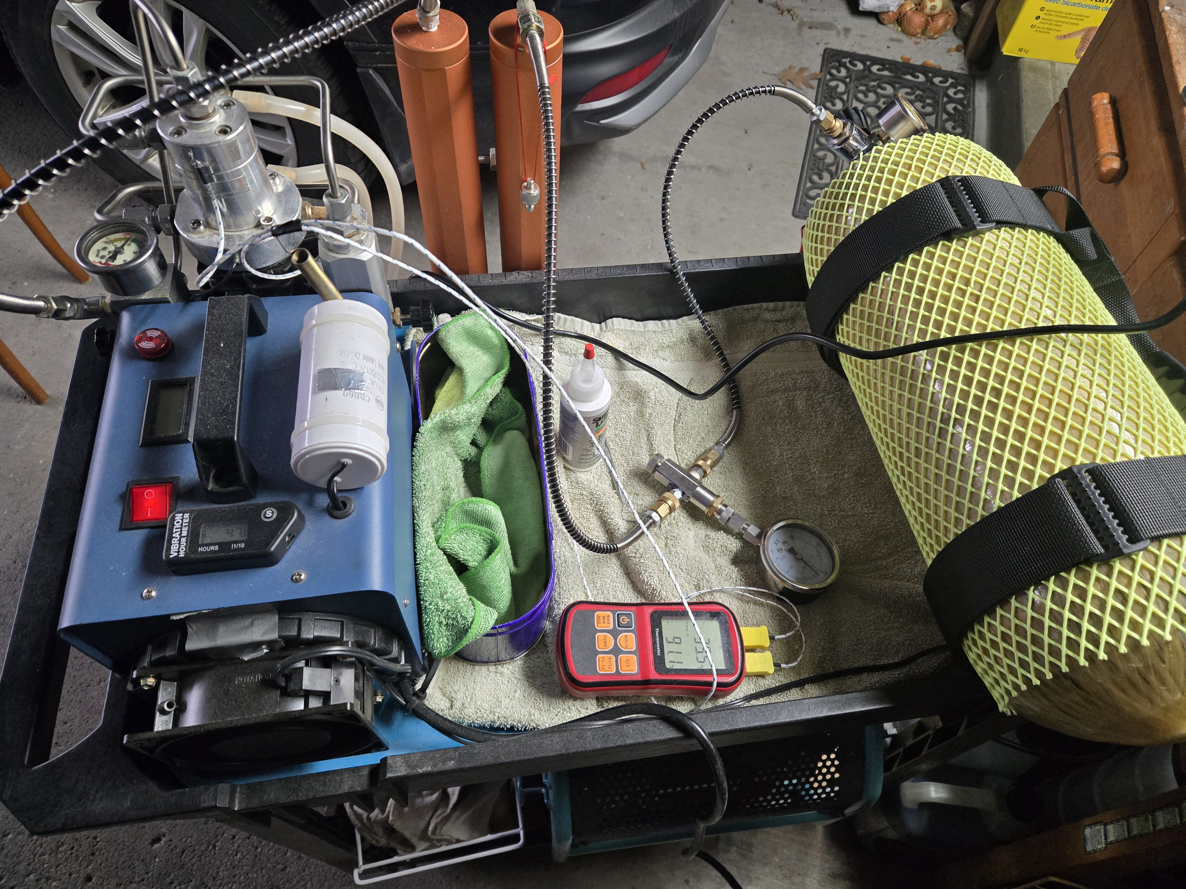

I had to replace an O-ring on the plate where the reed valve is in mine once. Tank fills to 300 bar are still possible with mine but instead of taking 25 minutes like they used to the last one was more like 45 minutes and I still didn't get to 350 bar but got over 4000. The gauge failed months ago but I didn't use it when refilling my 45 minute bottle because I trust the gauge on the fill set a lot more. But I ordered one yesterday so I can dead head test it and look for leaks.
Another leak site I've had before that I did not notice mentioned is filters. I have two, the stock one and another with dessicant and both have leaked before. But usually those leaks are loud and obvious caused by O-rings.
I will start the YH with the dead head and only the stock filter on it, shut it off when I get to 300 bar, and listen for leaks. I will need to turn off the fans on the radiators and motor too but it should not be hot at that point. If I can hear hissing I like to move my fingers to the site and if I really have the site the noise changes. If I cannot hear anything but the pressure is decreasing I will look for my little leak test bottle. You can buy a small bottle of what is essentially red tinted soapy water at the hardware store. They sell it for testing gas connections which is what I bought it for but it works well for compressors too. I've had the steel lines on the YH leak too. Hopefully my slow down is a leak and not something more serious. It's four years old now. I've used NuvAir oil in it from day one but they still don't seem to last forever.

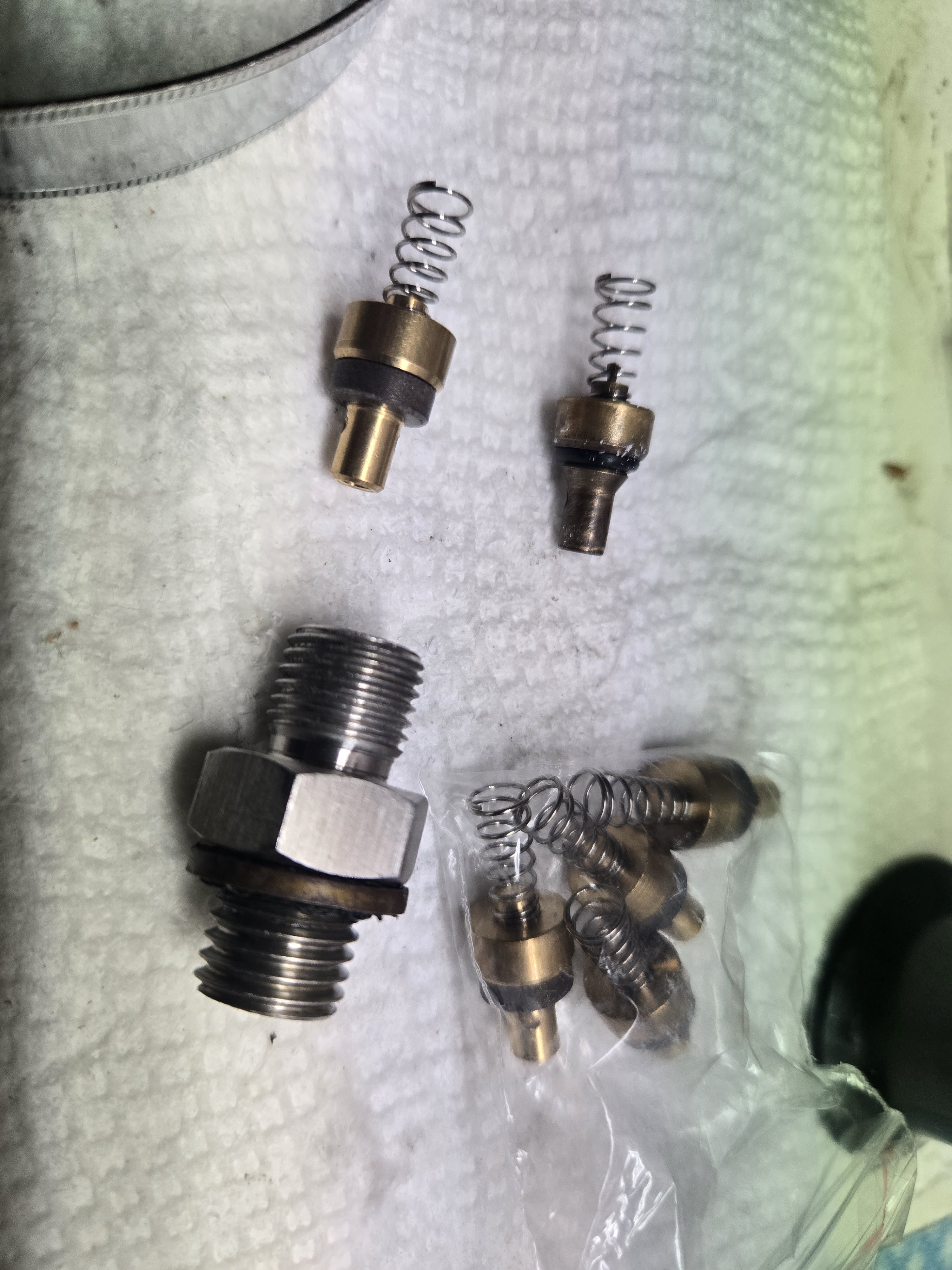

Also I would suggest replacing the old valves with new design, lasts much longer
I appreciate the advice! Where did you get those check valve’s from? I found a store on eBay that still offers free shipping but those valves are not there. Everything else is from spare O-rings to piston rods but no valve like those in the picture.

I am shopping on aliexpress much ahead of time, usually I buy spare parts at my convenience.
I am not focusing on YH store, I know they a bit more expensive, I buy usually where is cheaper and also shipping included.
The valve parts just an example, here:
Thanks!
