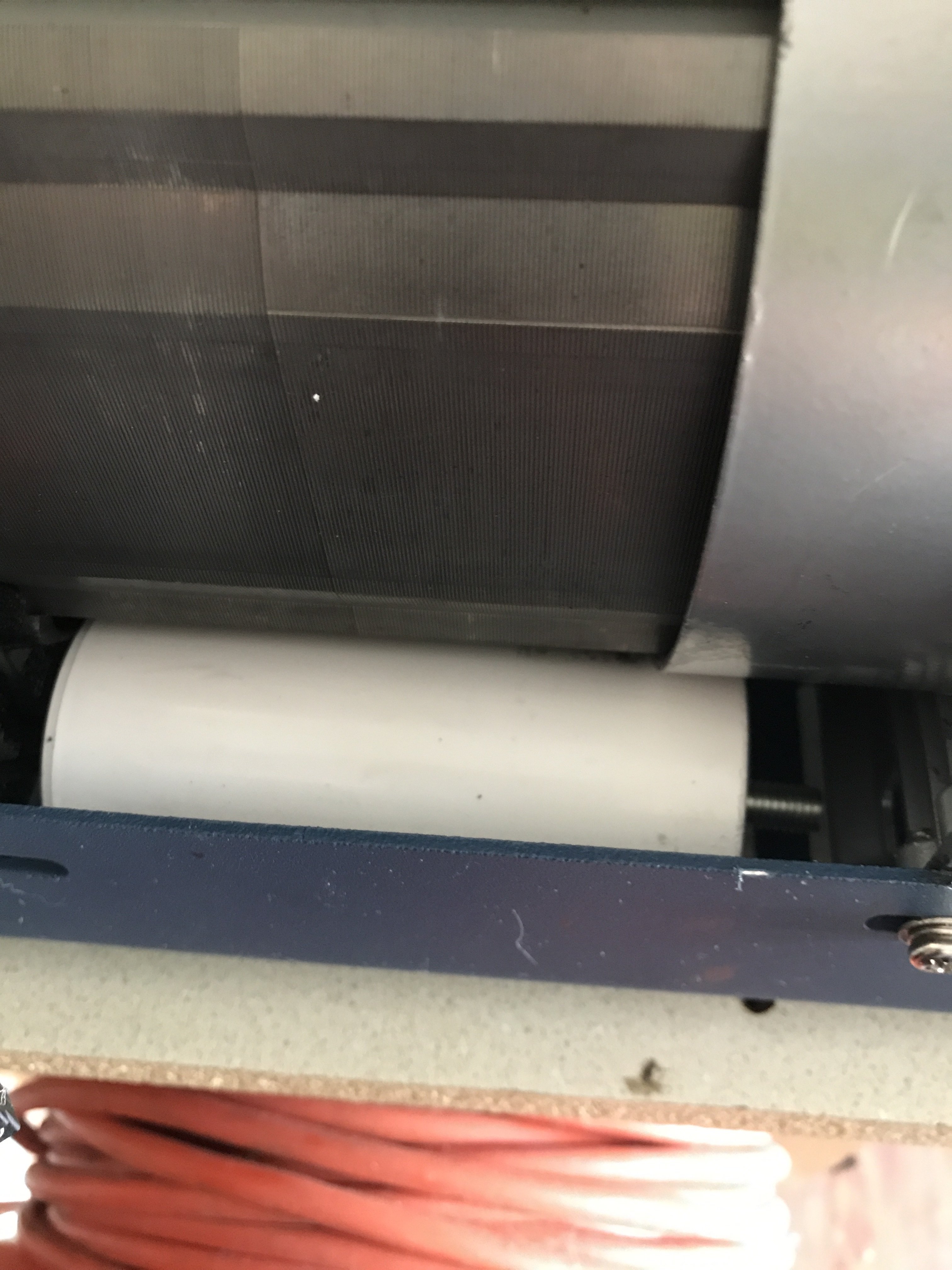

Is the capacitor setting under the windings? I see there is a threaded rod coming out of one end but is not attached to anything, just kinda floating around in the bottom housing.

I think the air line heat is normal. Thats the cap, theres no room in the case to screw it on top of motor and glue wont stick to the plastic. Can wrap it in paper tape and glue it or wedge something in that wont melt. If it doesnt move or rattle then id just leave it alone.
No , it moves! I had some fiberglass insulation and stuffed it in on both ends. It won’t move now!

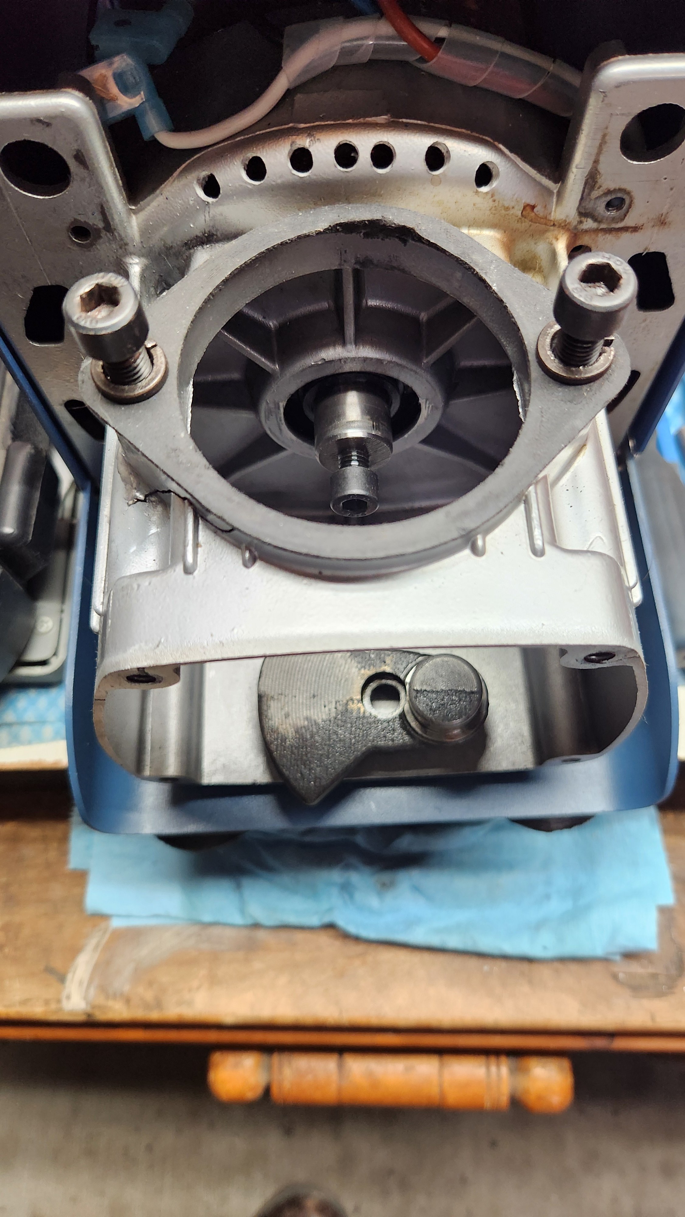

Today removed the oil and pan again, and with some tinkering finally managed to pull out that crank piece. I removed both the damaged and from my spare YH as well (this pic below) where I am scavenging parts in emergency.
I have two pistons refurbished but both piston rods damaged/seized and can't re-use, need to wait for a new full kit to arrive ETA next week.
Good news that all three of my scba tanks still about 250 bars, I have a good chance to survive couple weeks.
Apologies if I missed the post that shows the connecting rod's dipper/splash rod. I've had (5) Yong Hengs and clones, and one of the main reasons for giving up on them was the frequency of failures, particularly the dipper/splash rod breaking off. I have ordered connecting rods from a number of sources, some of which seemed to be even poorer quality.
In my experience, the bell crank can often be cleaned up and pressed back into service. When inspecting the new connecting rod, you may wish to consider the oil hole size and whether it is a clear of flashings as desireable.
