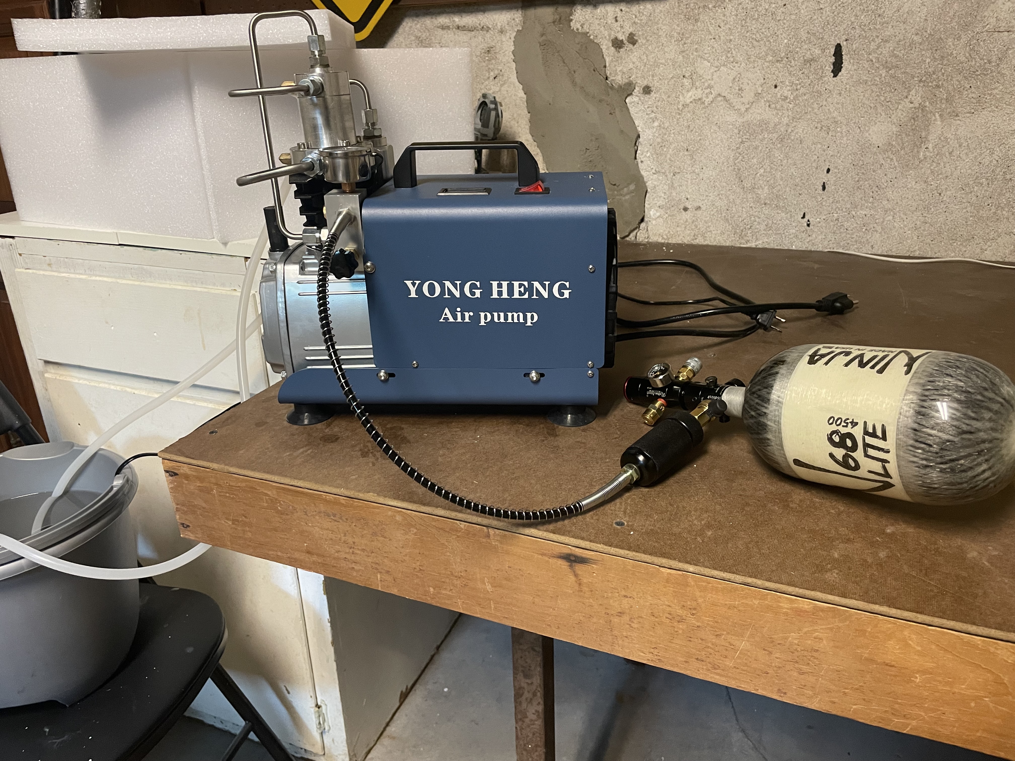

How about showing us a picture of your setup. Plenty of help available. You could have a HP leak or a clog or a valve not open?
Again there should be no pop when disconnecting fittings, find the bleed valve. You may have destroyed the quick fit o- ring.
You shouldn't need tape on the YH output there should be a delrin seal on the inside.

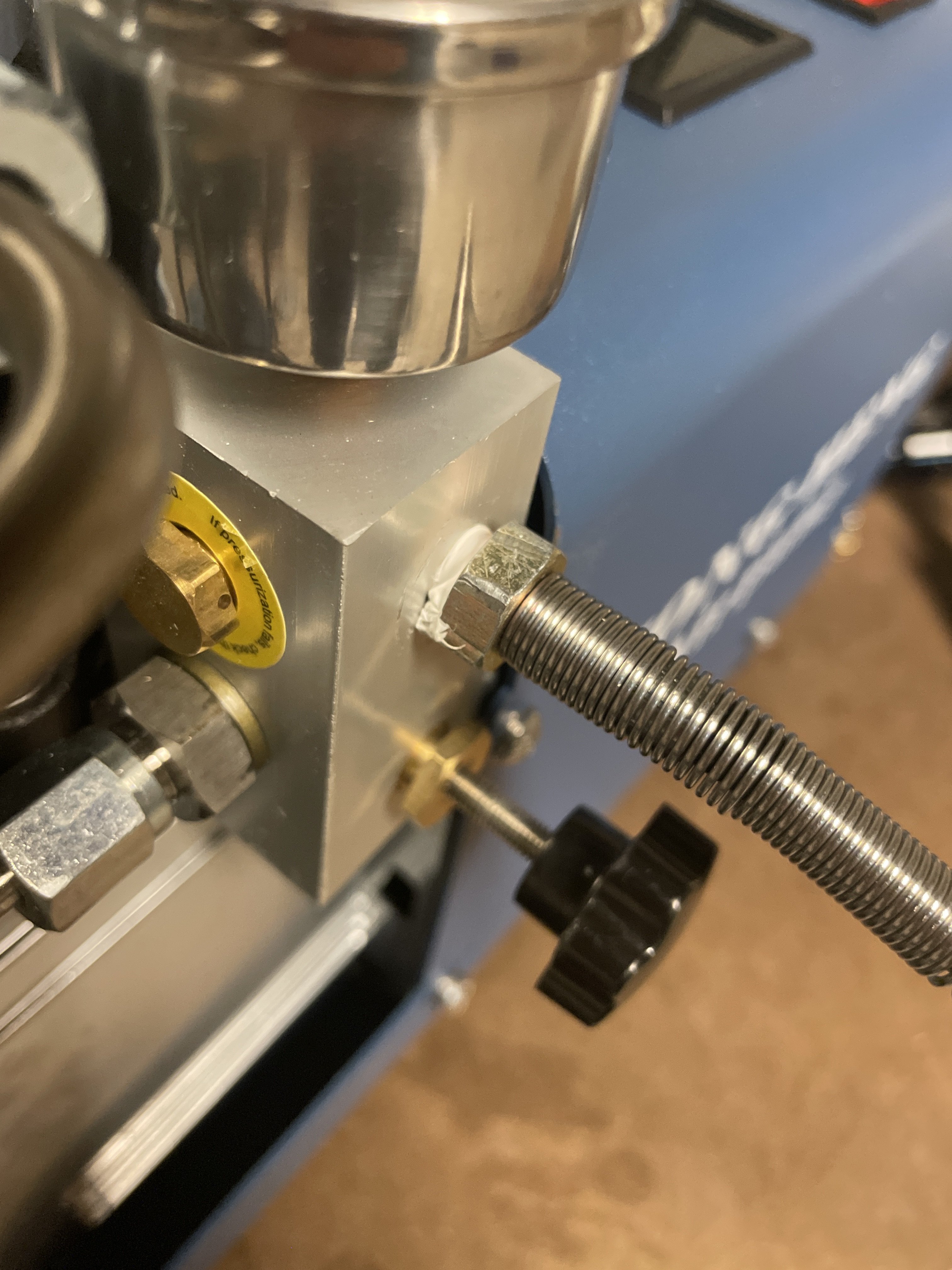

I don’t have a YH so I’ll let someone that has one confirm that the black knob in your photo is the bleed screw.

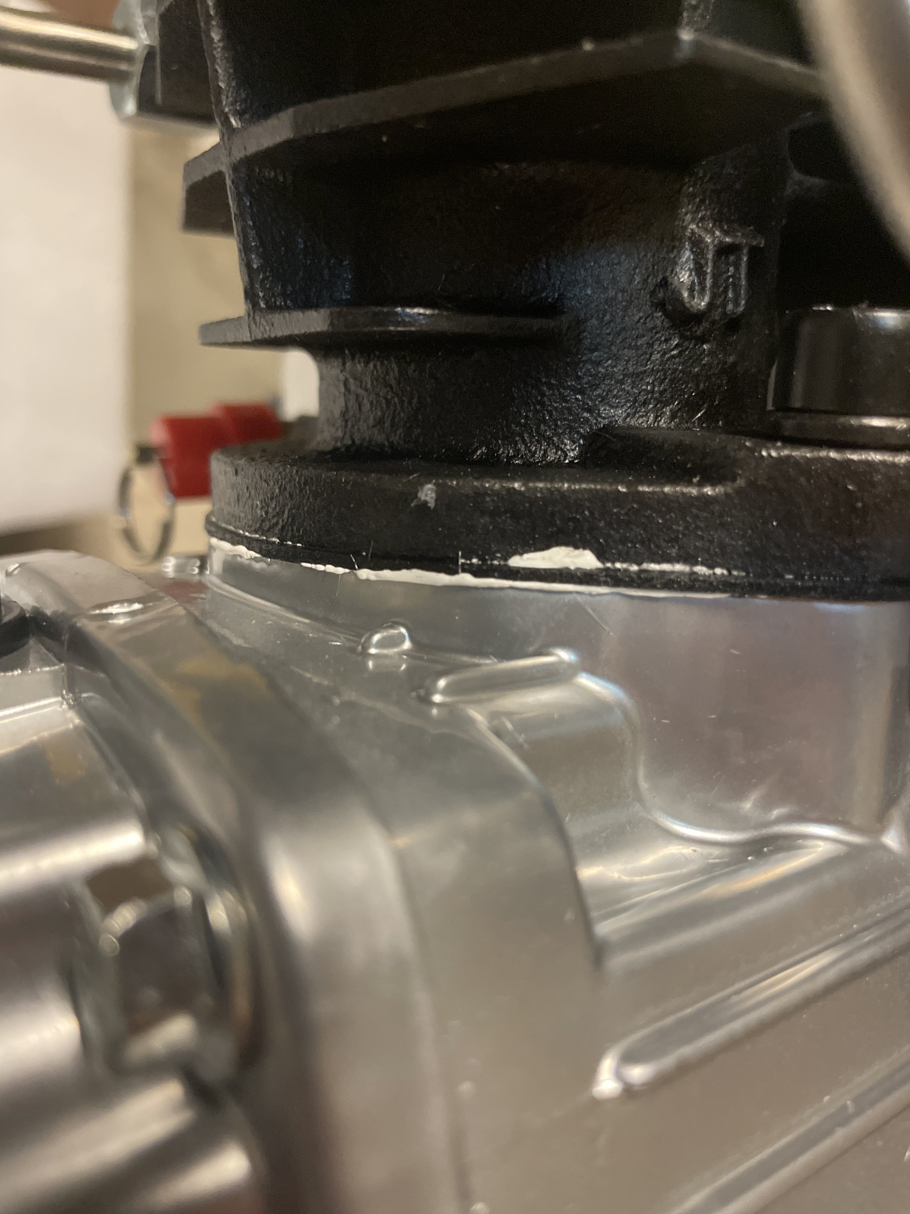

As for the white stuff seeping out, I’m guessing it’s a gasket sealant. Hopefully it has stopped but I suppose it’s possible that some fasteners might not be tight enough on the cylinder. Maybe the next time you run squirt some soapy water on it and see if it bubbles.

You shouldn't need the tape on the output of the HY! There should be a white seal 'washer' inside. Spare parts? Get a spray bottle with a bit of dish soap and spray connections to find the leak.
The white stuff should stop now, mine oosed a tiny bit once.

What's with the 3 brass fittings on tank valve AND the black knob on the brass fitting just past the in line moisture filter (top picture)? I've never seen a setup like that & I've been dealing with all manner of CF tanks for over 30 years. Is it possible some of your stuff is working against others? Why so many fittings & what's each of their functions? You might want to change out that one with the knob for a standard female foster. I'm not criticizing I've just never seen a tank valve setup like yours.
I saw that too. It might be a cap for the male Foster when filling is complete.

Those extra fittings part of a regulator that allows me to use the tank for airsoft
