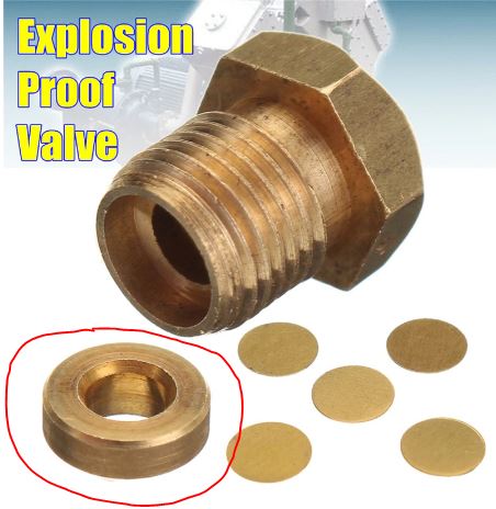

I had to hunt around on aliexpress for a bit to find a burst disc and fitting that actually was available for purchase.

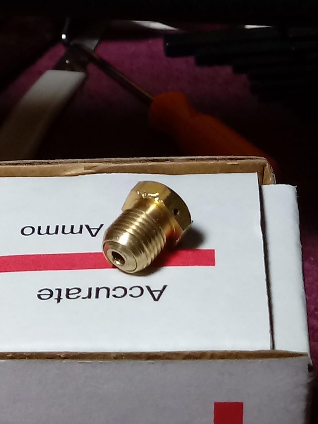

Yes I looked at that before I bought mine. Look at it closely the inner part of the unit not sure but looks like it is a slip fit in the threads!! I really don't see how it could hold any pressure at all unless the inside is threaded also. Really poor design if it is. So I can't be sure it is a valid part.
I don't understand what you are trying to say. It is the exact same part that is sold on the other site. They seal by the crush washer under the fitting.
.... Look at it closely the inner part of the unit not sure but looks like it is a slip fit in the threads ....
This thing does the sealing in the same way as those white plastic sealing washers do. I have replaced the burst disc of my YH once and shared your doubt. I then asked the Yong Heng people whether a plastic seal should be there. The answer is negative.
What I was talking about is that the threads looked separate from the rest of the unit. Kind of like the hex part slid up and down inside the threads. Probly it's just looks but I did not trust it cuz sometimes from China what looks is.
So where did you buy yours? As far as I know, YH is the only brand that uses this M10x1 size fitting. The ad photo is the same image as the one from the overpriced YH store page. Generic burst disc fittings from tank valves and other brands like Tuxing, won't fit. I have one of these as a spare and it is the same part as the original.
