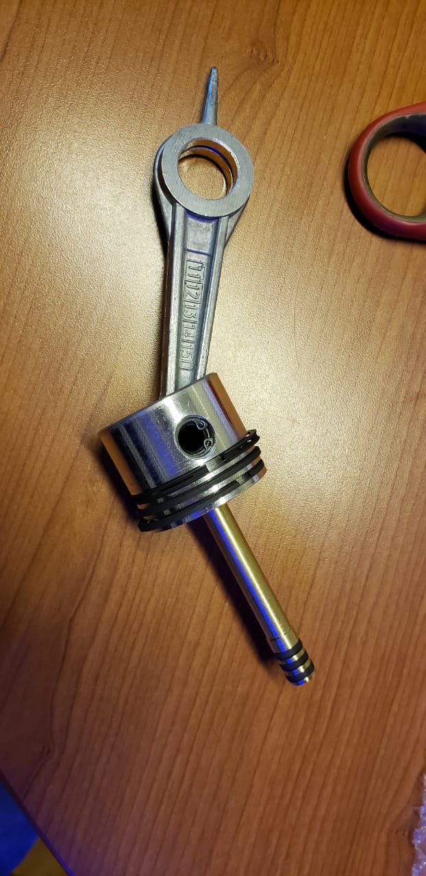

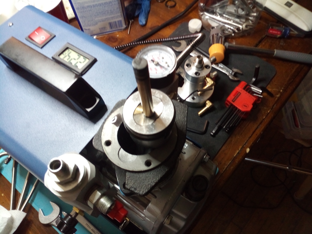

Hello all,

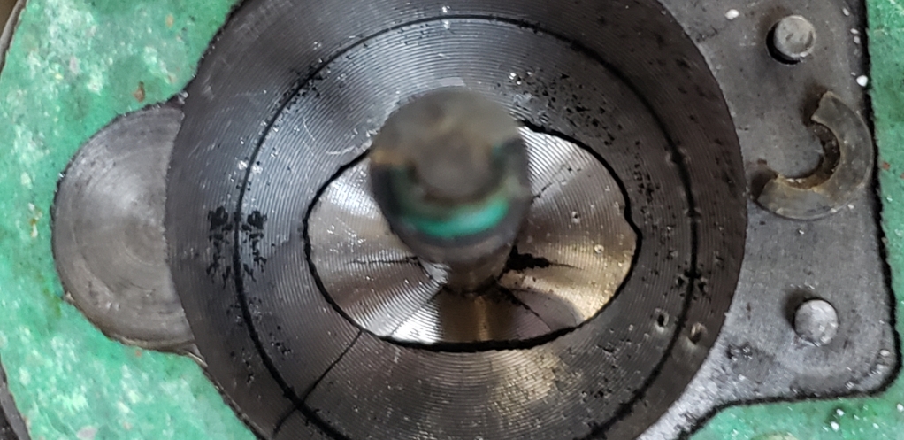

I was filling my tank last night and got a ton of blow-by out of the breather and pressure stopped building at around 4K. The compressor is about a year old and has been working great.The only change I made was to switch from stinky aw46 from Pep Boys to royal purple synthetic compressor oil ISO 100. Rod and crank journal are in great shape along with the first stage cylinder, there are no signs of wear. Compressor temp was between 40c and 50c and unit was running for about 30 minutes when I noticed the blow-by. Can anybody tell me what the heck happened, I have been very diligent with performing oil changes and any other thing that it needed. I ordered another unit but I need to know what I should do as far as rebuilding this unit, should I just replace the piston or piston and rod and cylinder etc...? Do you think I should go back to AW46 or is the royal purple ok?
Thank you,
Jim
Well for a start the top of your first stage piston head is clearly cracked. Hard to say what else is wrong from the pictures alone, but that could be it.
My personal experience with the YH compressors is that they're essentially disposable. Like anything vastly less expensive than competing products, they have their advocates and that is fair, but how many times are you willing to have the thing fail, tear it down, source parts, and rebuild it? Only you can answer that question, but that really should determine whether you buy a whole new one, repair it, or source a better compressor. *shrug* The royal purple full synthetic compressor oil is most certainly not the cause of your problem though and should be fine.

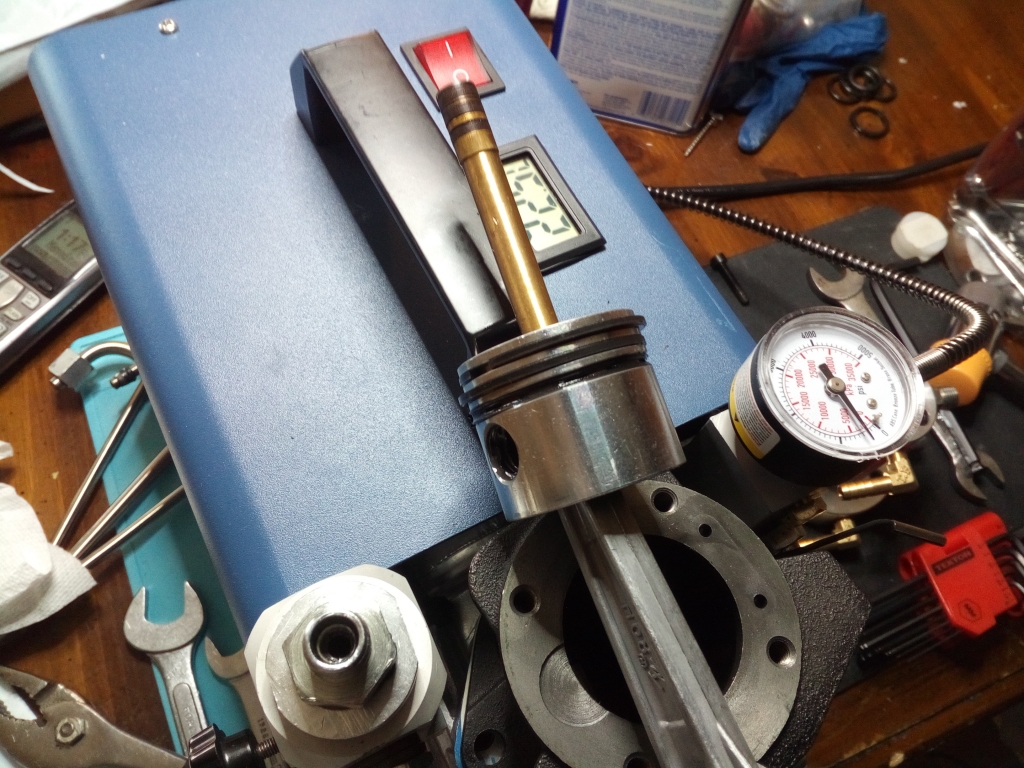

That’s about the time frame I got out of my YH. Ordered a piston group about six months ago just waiting for this same issue, and it happened about a year to the day. Install the new piston assembly and we are back in business. Ordered another piston group for the next time. $25 or so for a piston group and about 30 minutes to repair. Pretty cheap repair. Waiting for the parts to float across the pond is the worst part.
I took the liberty to send your picture of cracked piston to the Yong Heng factory in China. You are not the first one to experience the problem. They told me that they are aware of the issue and all compressors coming out from the factory now have got pistons with thicker wall. Make sure that you get the new piston for replacement. My Yong Heng was bought one year ago and they told me that it probably has got the old version piston with thinner wall. I have just ordered a new-version one, costs 4 bucks shipped
That's interesting. I wonder when the production cut-over to the new piston was since my unit was purchased this past January. Did you get your new piston direct from the factory?
Could you give us a link or more info so we can follow the same path.
There is no link selling the new piston. I am located in Hong Kong and I contact the Yong Heng factory directly to buy the piston. I am sure sellers on Aliexpress or alike can get it for you guys in US .
