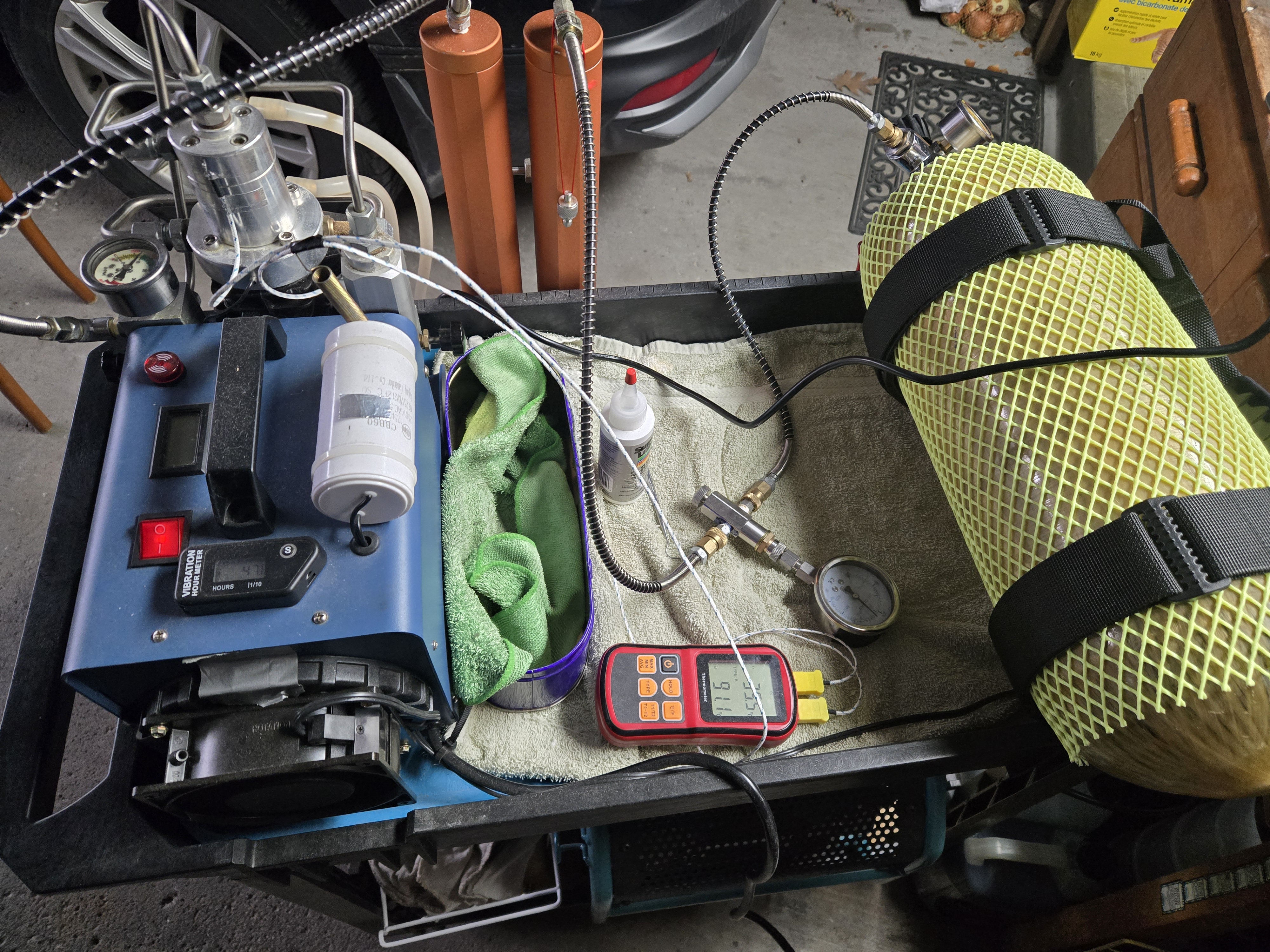

Yong Heng after piston replacement
My Yong Heng started taking 45 minutes to refill my 45 minute Scott air pack from 3000 psi to around 300 bar. It really struggled as it got up around 4000 so I did not always take it to 300 bar. It used to do this in 20 minutes. So I ordered a piston/rod assembly from Amazon and installed it this morning.
I would not call the installation very easy but it was not terrible either. But with the new piston installed I cannot get my bottle to go over 3500 psi (where it started). It also trips breakers much more than it every has but I got it to run for 15 minutes but it stayed at a pretty constant 3500 (using the gauge on my fill set, not the crummy YH gauge). The temperature is up a little, 10 degrees or less, but it's hotter here now so that is probably at least part of it. The big issue is it won't even do as well as the old piston did in terms of filling my bottle. It will go to 4000 psi on a dead head test but slows down a lot over 3500 psi.
It might be leaking a bit somewhere around the gauge. I don't think it's the gauge itself but might be. The gauge is new (but that doesn't prove anything). I will check more for leaks, probably tomorrow (tired of messing with it right now).
Other things I should check?
