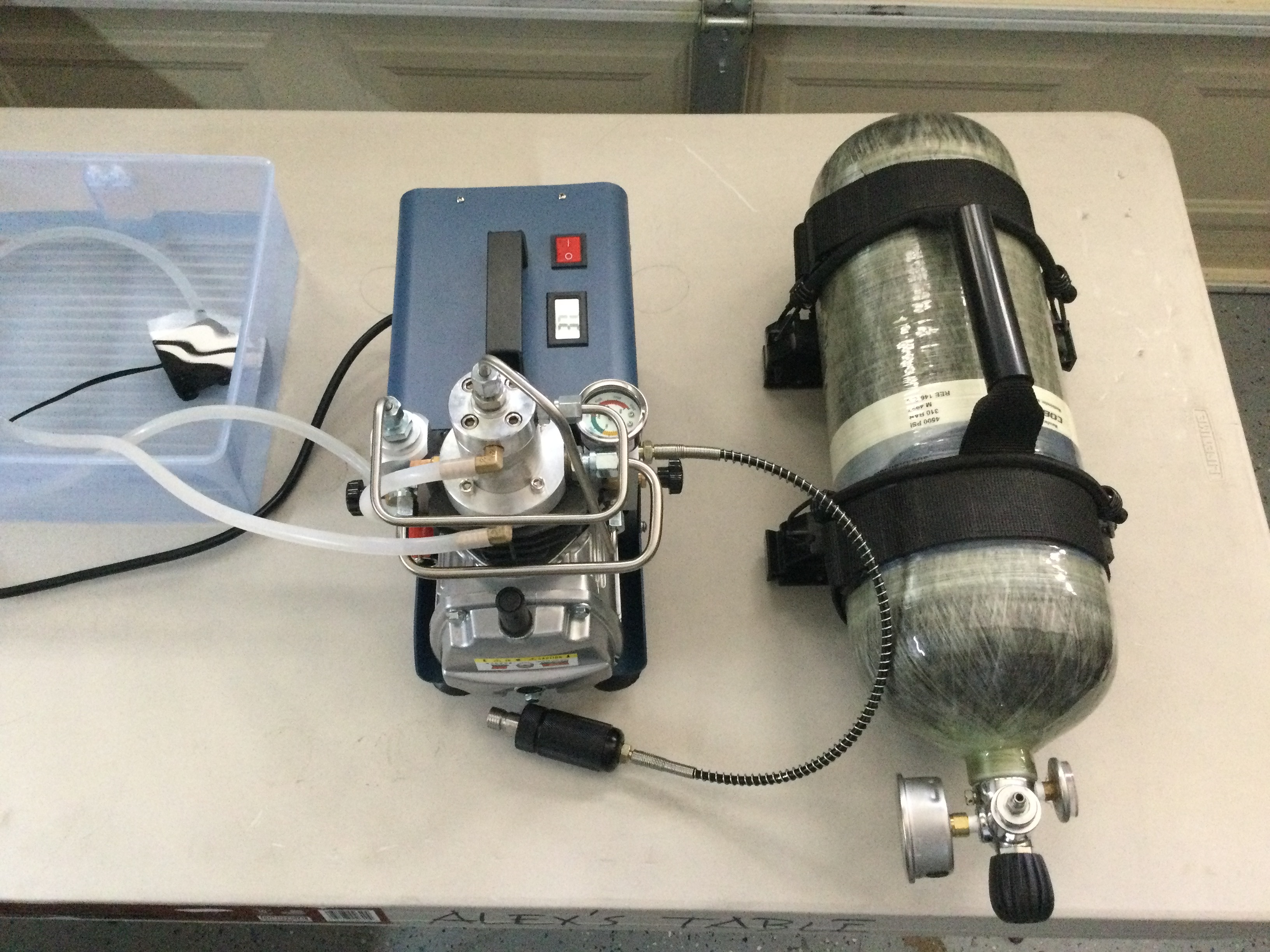

Here's my humid Florida garage set-up, doubt you'll need the bronze water separator, but the gold (3-media cartridge) should help with moisture control. Keeping guns and tanks above compressor, when filling, also helps with moisture control. Members report fan blowing from back to front of compressor also aids in cooling. Water-filled lemon juice bottles are frozen solid, just like Sqwirlfugger suggests. WM
