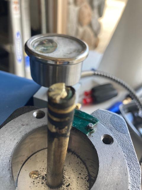

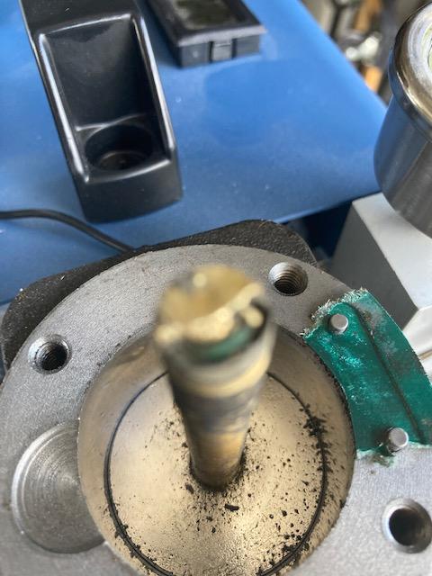

Pulled the upper head off and here is what I found....Before pulling the head off the pistol wouldn't go to TDC then I found this....Looks like time for a new pistol set.....Now do I need to pull the bottom portion of the head off to get the entire pistol out?
