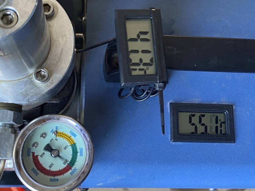

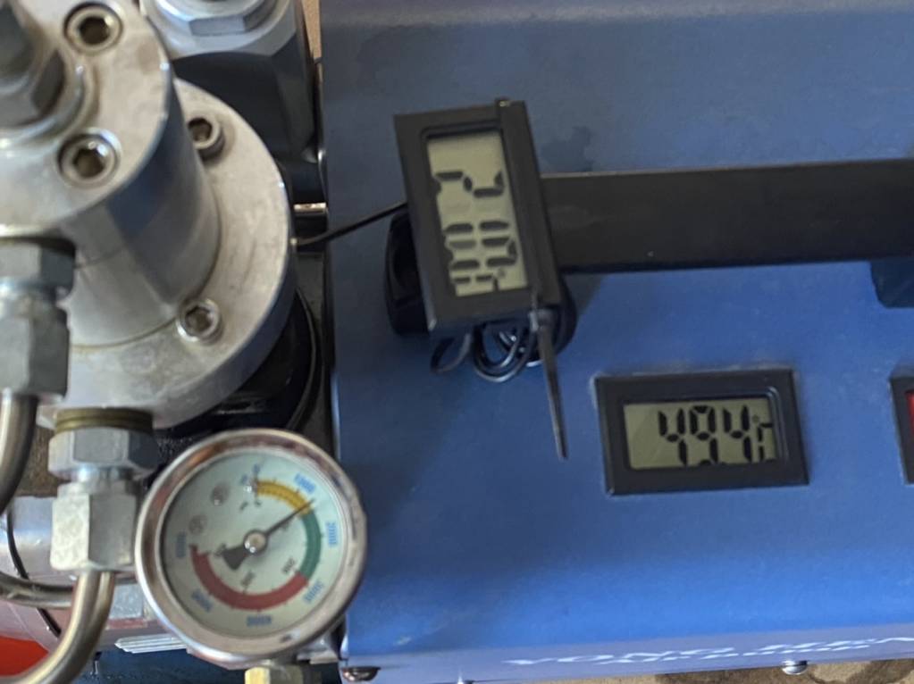

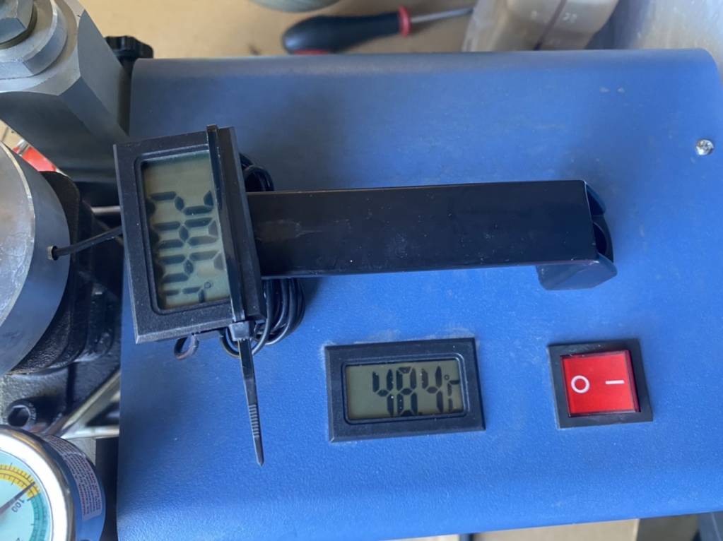

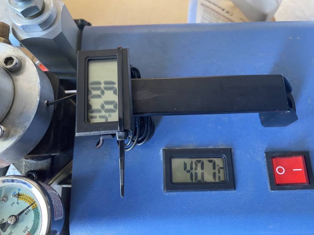

ordered a pack of temp gauge and I’ll let the pictures do the talking so you can decide if you want to do the same mod. Gauge on the case is for the motor and gauge on the handle is for the head.
This is my third 10-12 minute run today and second run to fill my 45 minute tank from empty. Same exact result, 41 degree at the head for the entire run but the motor slowly climbs to 55 that’s when I shut it off.

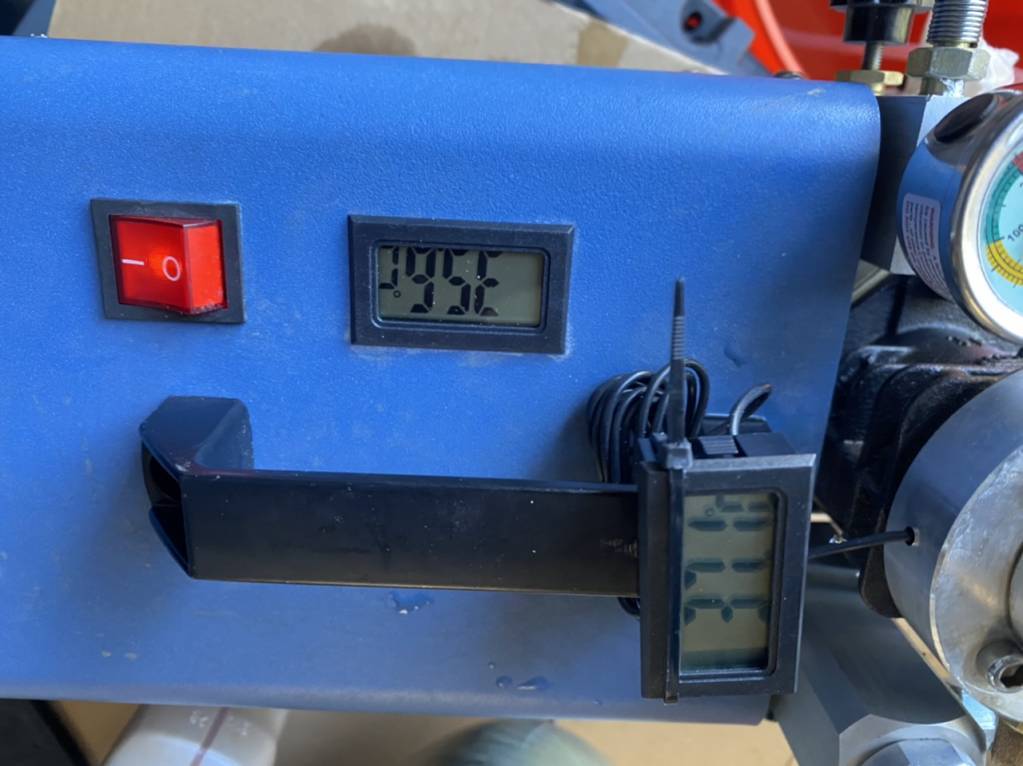

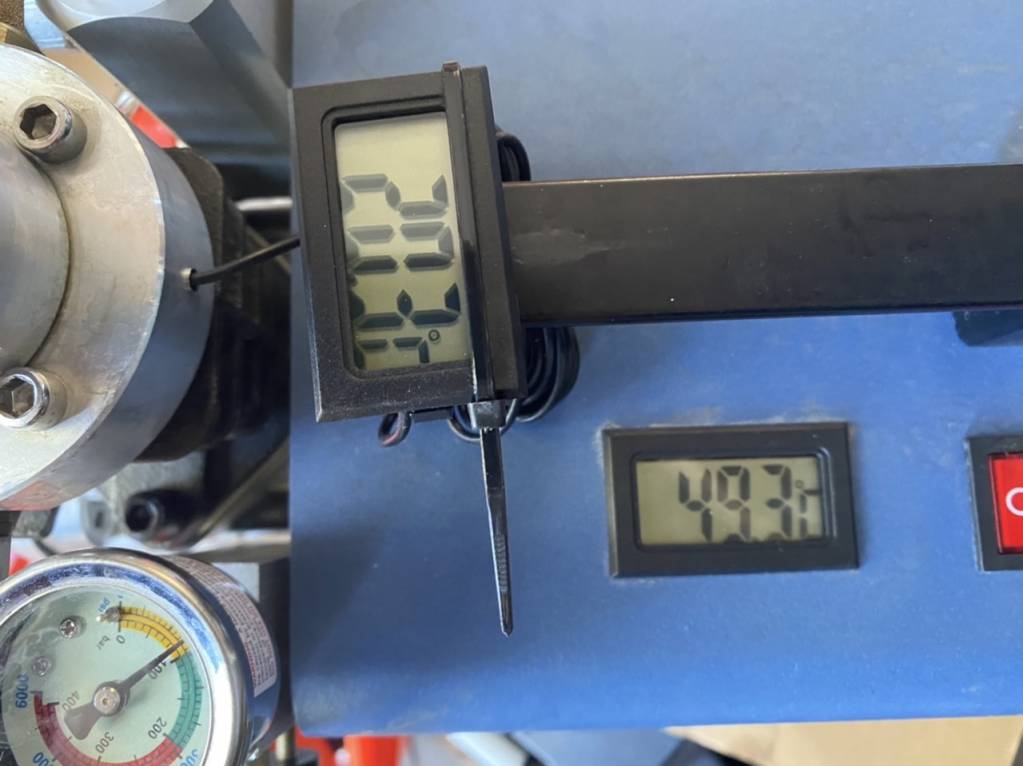

end of 10 minute run right befor I shut it off:
after only 1 minute of cool down with fan and pump going, the motor takes about 10 minutes to cool down to about 30 degrees with fan on high but the head drops to 21 degrees in just 1 minute.
