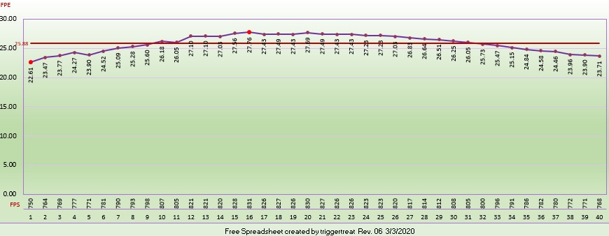

Had the Sentry out for a run yesterday and might shoot it some more today.
This gun came to me as a basket case in .25. This thing wouldn't hit the side of a barn from the inside.
I tried a few different barrels and it just wouldn't play nice at all.
I called Mike Mellick at FDAR and we settled on a complete upper half in .22 for $80.. all I had in the gun so far was a little over the cost of shipping IIRC.
That's what it took to fix this "Fugly" gun. It's a pure tack driver now and loves domed pellets between 14 and 19 gr.
I got a nice tune on it with a pretty sweet bell.
18.1 JTS domes....
