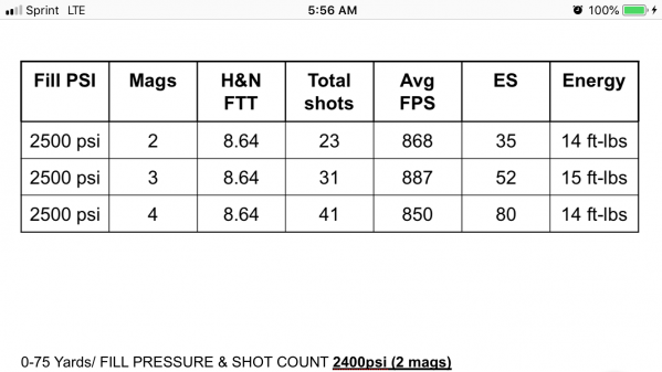

Here is how I’ve chose to tune my rifle due to several different factors:
One it allows me to have my maximum shots at my desired velocity and still be able to use the rifle for a pests and small game. You’ll see that my tune is only between 14 foot pounds and 15 foot pounds and the truth is I can squeeze 21 foot pounds out of this rifle but only for around 12 shots and the key for me is to keep the extreme spread as low as possible. So if you have one of these rifles just know that my set up is an absolute laser beam and I never have to worry about accuracy with this set up. I would much rather have shot placement and correct calculations then maximum energy on any of my rifles. I just thought I would share this and Potentially help other guys with one of these. I know there is several tunes for every rifle but I believe this keeps you at the best velocity for the most amount of ACCURATE shots.
PS: And I used field target trophies but I will be using poly mags I just don’t like to waste them. Ill redo my tables with then and only shoot a few over chrono.
