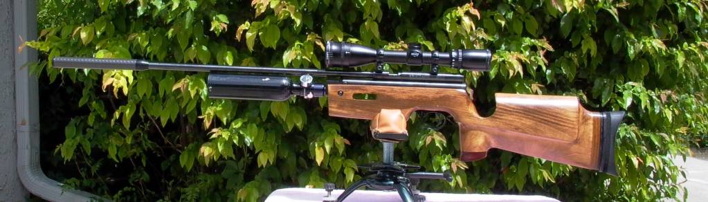

This is a custom .22 caliber, regulated, pcp built by Ron Robinson (highly accomplished shooter and author of 5 airgun books. His first was Manic Compressive and his latest is Awesome Air Pistols!).
This was built on a QB 78 platform and the custom stock was also done by Ron Robinson. The thumb rest on the stock is perfect and the adjustable butt pad is a wonderful feature. It was this gun that Ron Robinson used to take second place in Hunter Class at the 2009 FT National Championships at Yegua Airgun Club. There was a .177 barrel on the gun at that time but Ron installed a very accurate .22 barrel since then.
3 weeks ago, the very competent airgunsmith, nervoustrig went through this gun completely. Here’s a list of what was done:

Chronographed at 735fps with 15.9gr (19.1fpe). Velocity is consistent/reliable after sitting idle overnight (no evidence of regulator creep).”
Since receiving the gun back from nervoustrig I’ve shot 25-30 15.9gr JSB pellets and confirmed that it’s doing 734-740fps and is still very accurate. The little bottle on the gun fills to 3,000psi and gets 70-80 shots
