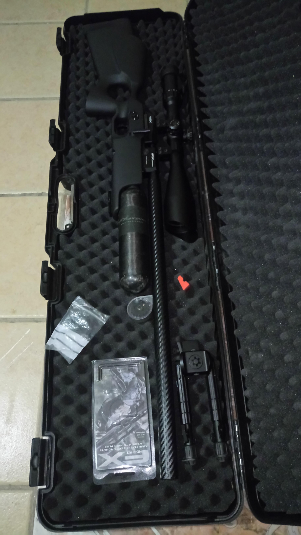

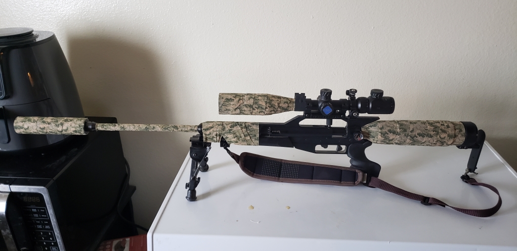

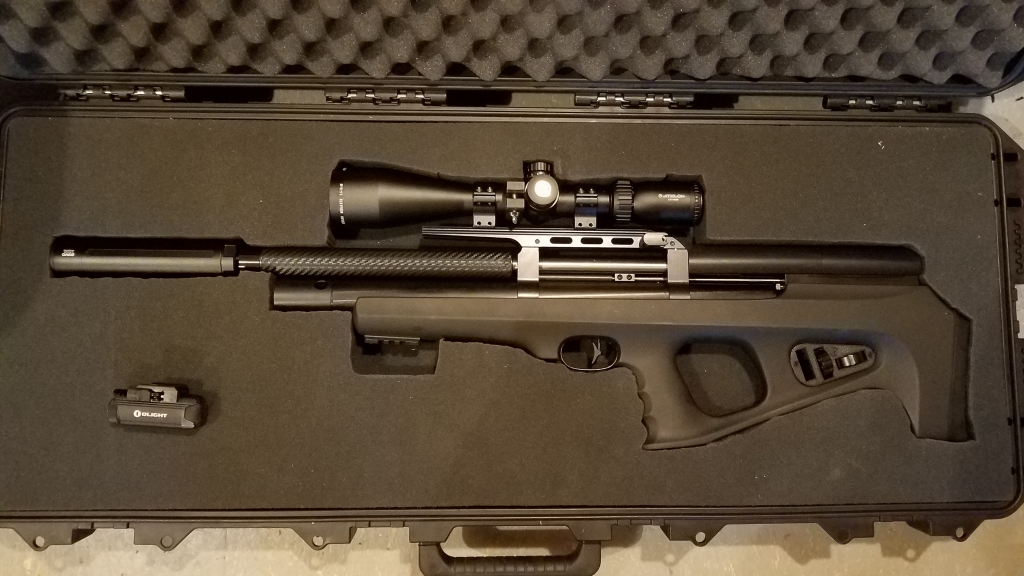

A few days ago I wrapped the shroud of my FX Crown with a "carbon fiber" design as I can't afford the real one yet.
1553891283_14378178335c9e7fd3258372.09002646_1553487724_14296093165c98576c6cfd79.80351441_DSC_...JPG
1553891283_3355769325c9e7fd3937bc0.16894048_1553487726_6606649545c98576e505254.68702537_DSC_1179.JPG
1553891341_17224239235c9e800da42467.24861162_1553487724_14296093165c98576c6cfd79.80351441_DSC_...JPG

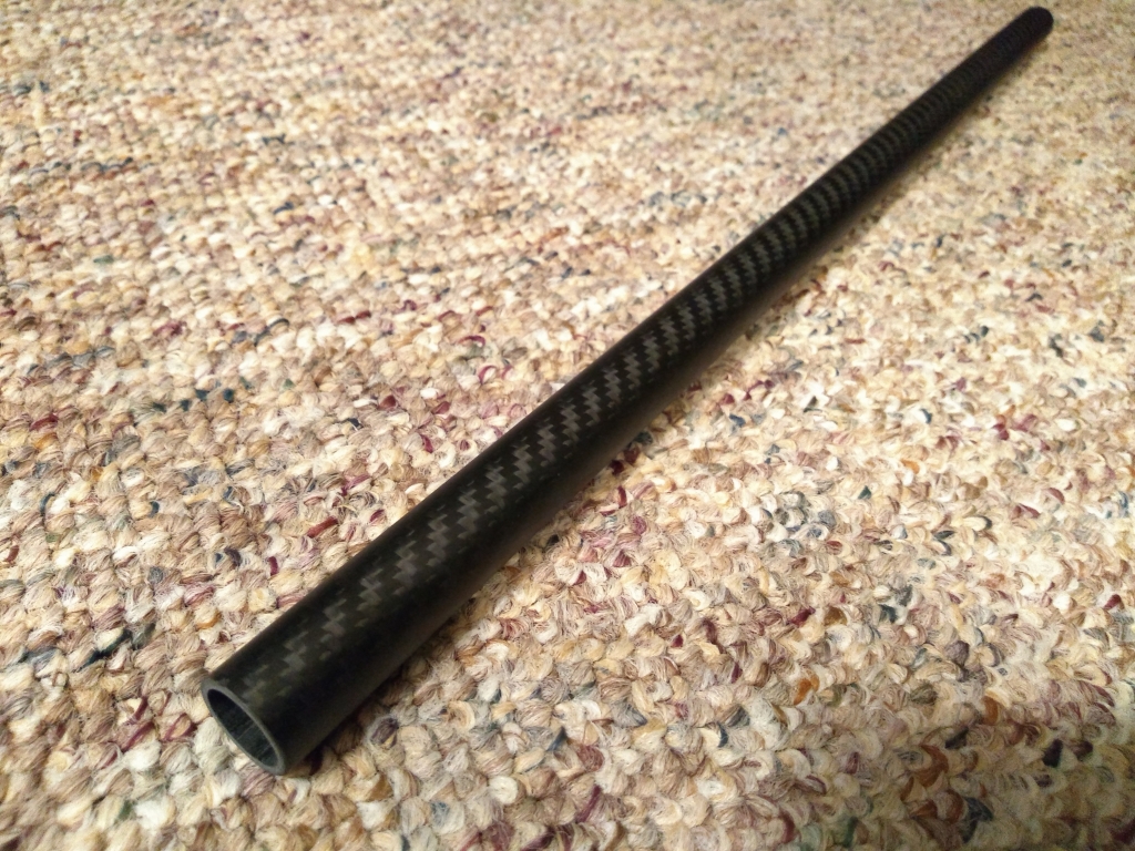

Here is a picture of a 100% real carbon fiber tube that I bought a few weeks ago:
(EDIT: This thing is INSANELY light and rigid as hell.)
Prices for real CF have been dropping for years. This one is 3K CF, very strong. It is 15mm ID, 19mm OD, and 500mm long (just under 20". Through-and-through, it is 100% CF layered composite. And it was $20 total shipped to my door.
I measured the dimensions when it arrived. It is true to almost perfect 15mm ID which is what I wanted. Thinner-walled pieces are more common and can be had for less money for the same length.
I bought this for a barrel shroud project that I ended up changing direction on. I am still going to use it, but I am waiting to do anything with it until my other items show up so I know what my OAL is.
I am interested in the wraps to match the raw matte finish of this piece with the mod that I have arriving soon. Unfortunately, it is hard to anticipate what the wrap pattern looks like in-person when looking at it on the net. Sometimes I wish Amazon had a virtual store lol.
EDIT: Important safety tip: If machining/sanding/drilling, wear gloves and a face mask or other respiratory device. If you breathe this CF dust in, it will stay for... well, maybe forever. If you do buy a true CF tube/sleeve, and you have to machine it in any way, be prepared to nuke some tooling. If you try to cut or drill too hard, you can fracture it and not leave a clean cut or hole. Conversely, even going slow, you can leave a very clean hole, but even with a sharp titanium-nitride bit, after about 8 holes the bit will be nuked. The carbon fiber is so hard and abrasive it will tear through that coating on the bit (even on thin pieces) and dull the poop out of the drill bit fast.

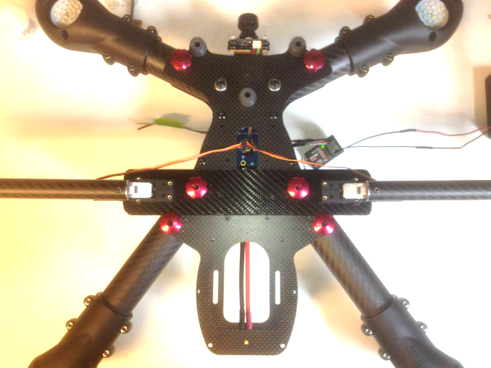

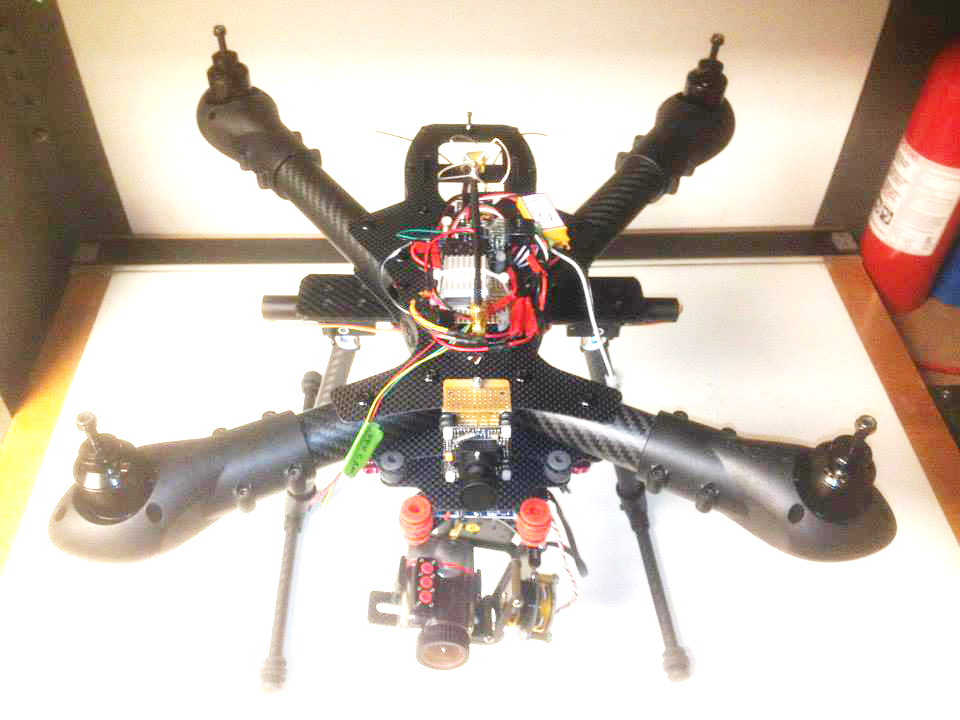

Anyways.. I used to build and mod a lot of radio controlled multirotors, frames, arms, gimbals, etc. out of CF..
Here's a Sky Hero Little Spyder - 3K plate and 3K matte tubes [arms/legs]
1554226160_13202182095ca39bf0edfe53.41974226_996112_10206837087148890_1406314407777030560_n.jpg
I had to build a mounting plate for the retractable landing-gear,
and I ran out of CF plate, so, I fab'd the mount out of aluminum, and wrapped it..
