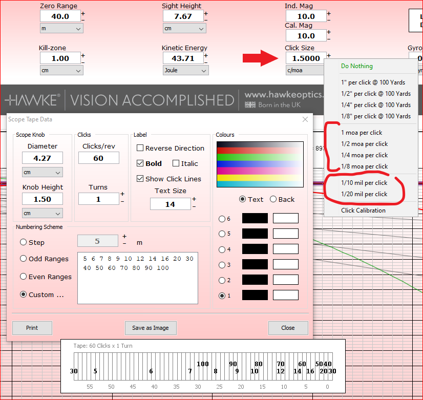

I was eyeing the scope tapes for some time but only last week sit down for first time to make my own. And it was a bit of nervwrecking learning curve.
Currently I have 3 scopes mounted, two SFP in MILLDot (0.1 and 0.5) and one LPVO in MOA (1/5 MOA).
I lost myself calculating what is what in Chairgun, which was recommended to me in other thread. Finally I made my scope tapes and now comfortably matching the Strelok clicks but not tested in live shooting yet.
Btw I am a metric guy, mechanical designer and my major client has a production in inches... so I am 50-50 good with numbers. But is beyond me why there any need for 3 different standards ...
The problem started when my best scope turret is a 1 click=0.5cm @ 100 meters, and the LPVO is 1 click 1/5 MIL and the third scope is 1 click 10 mm???
How to do that, here is the screenshot above??

If 1 click is 0.5cm at 100m it is 1/20 MIL per click
If 1 click is 10mm (aka 1cm) at 100m it is 1/10 MIL per click
I've never used a 1/5 MIL scope but that's probably typical on LPVOs and red dots (mine are all 1/2 or 1 MOA adjustments). I would assume you could create a custom 1/5 profile by selecting "click calibration"

I didn't care neither what scope I was using because at the bench I had my tablet and Strelok with me all the time.
But decided printing a scope turret tape for my Leshiy2 only to simplify my luggage. I hope I don't need a tablet+radar+batteries+paper and a pen.
Finally I can shoot a full silhouette range without looking up how many clicks I need for jumps in between 20-40-60-70-80-100, also for short ranges 10-20.
