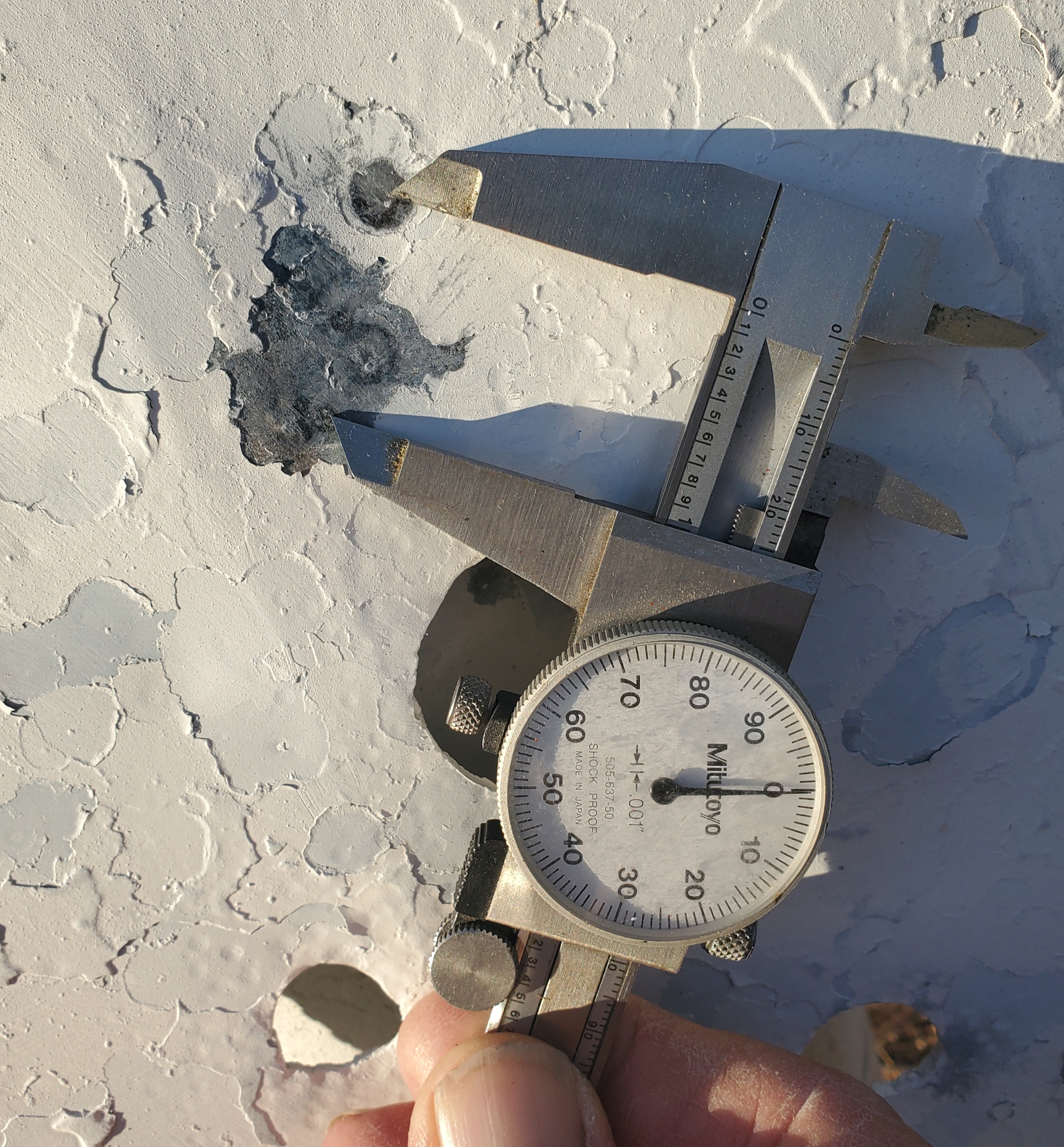

Quick question, why did tou measure the second one corner the corner while the others were measure center to center? Great groups either way.
Reactions: .20calguy
I measured all the paper from the outer pellet marks, then subtracted the caliber (.200) to give ctc group size. The splatter on the steel makes that difficult and the center of the pellet shows, so I just measured ctc on it. The 50 yd group would be 0.312.

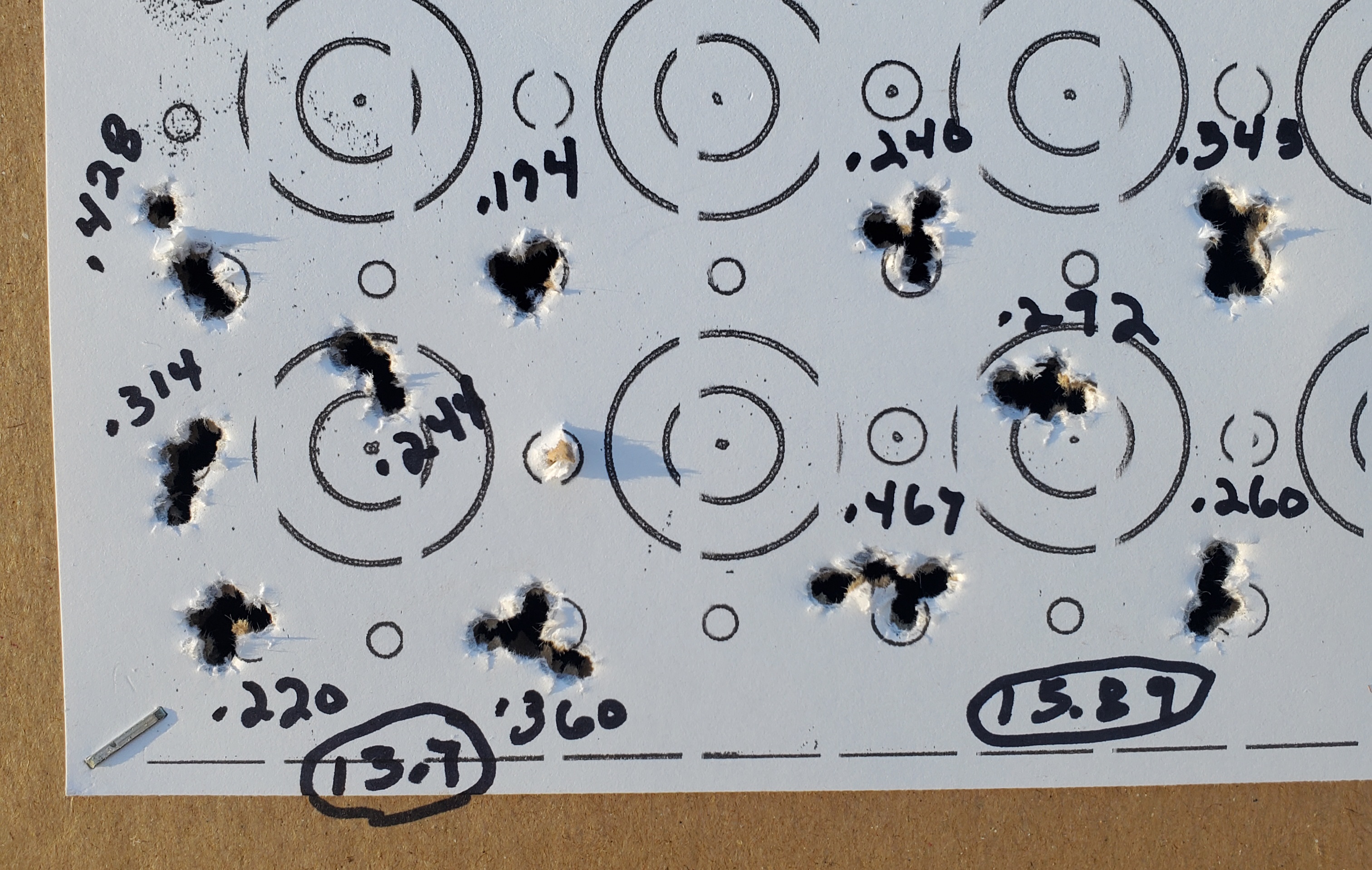

Since we're talking Sterling Lothar .20s.....
Late night at work so just barely shot this..
And I got all kinds of excuses, 38 degrees, night time shooting is hard to center the eye in the scope, jittery from being at work all day and drinking caffeine, etc.
5, 5 shot groups with the Vet .20 and 5, 5 shot groups with the Ghost .20. all at 30 yards. 50 shots in a row, all seen here. Shot in the order I wrote on the bull. No "flyers" per se, but the lowest one from the Vet (#4) was waving grass blades as the pellets went past. And I did pull the 25th shot on the Vet, in group 5, pulled just a bit right. That shot bumped up the average from the Vet .20 quite a bit. I think the somewhat and slightly wandering poi is from parallax issues (again, eye centered in scope in the dark is tricky).
Only used the .20/13.73s. Both guns average 800-805ish, and both have fairly tight extreme spreads. Vet is a bit tighter, 8-10fps spreads usually. Ghost is more like 15fps extreme spreads. Those ES aren't a factor for 30 yards.
The written group size is how they measured from outer edge to outer edge.

THAT'S what I'm talking about, @Franklink 👊... so your Ghost averaged 0.119 ctc and the Vet averaged 0.137.... This one averaged 0.302 w 13.7s and 0.320 w 15.89s.

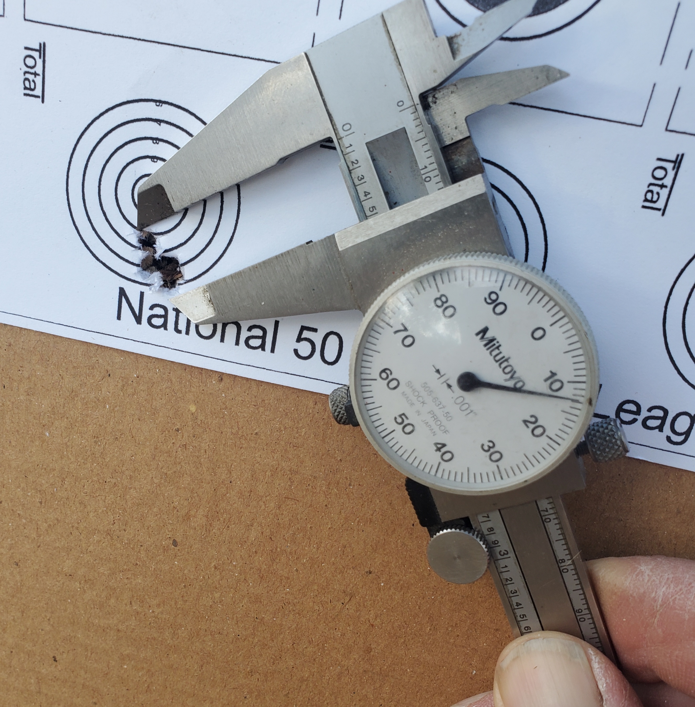

This is often regarded as nit picky, but is actually important when trying to compare groups of different calibers or projectile types.
To obtain a valid ctc distance based on a groups outside to outside “daylight” measurements…you must use the “daylight” measurement of a single hole to deduct from the outside to outside. Using the raw caliber as the deduction results in optimistic numbers…especially when the group is already smallish. .177 holes from round nose pellets on reasonably decent paper are about .135”-140” but can produce even smaller “daylight” measurements than that with variations in paper and backer support.
Mike
