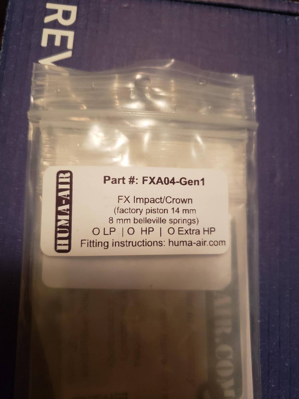

Would this work for my FX Impact MK1?
No, like this👍
You would also need to know if your Gen1 has the short reg piston with 11 x 8mm diameter belleville washers or is actually a Gen2 like mine with the longer 8mm piston and 16 x 8mm diameter washers. Before you start changing things around.

Thanks for this. Yeah mine is a Gen 1. Where can I buy a Huma regulator?
I bought mine from Huma. Only replaced mine cuz it was faster than going through FX to that the part I needed. They really screwed that one up. They did better with the rest of my transactions with them though.
From Huma
https://www.huma-air.com/FX-Impact-and-FX-Crown-Tuning-Regulator-Gen-1
