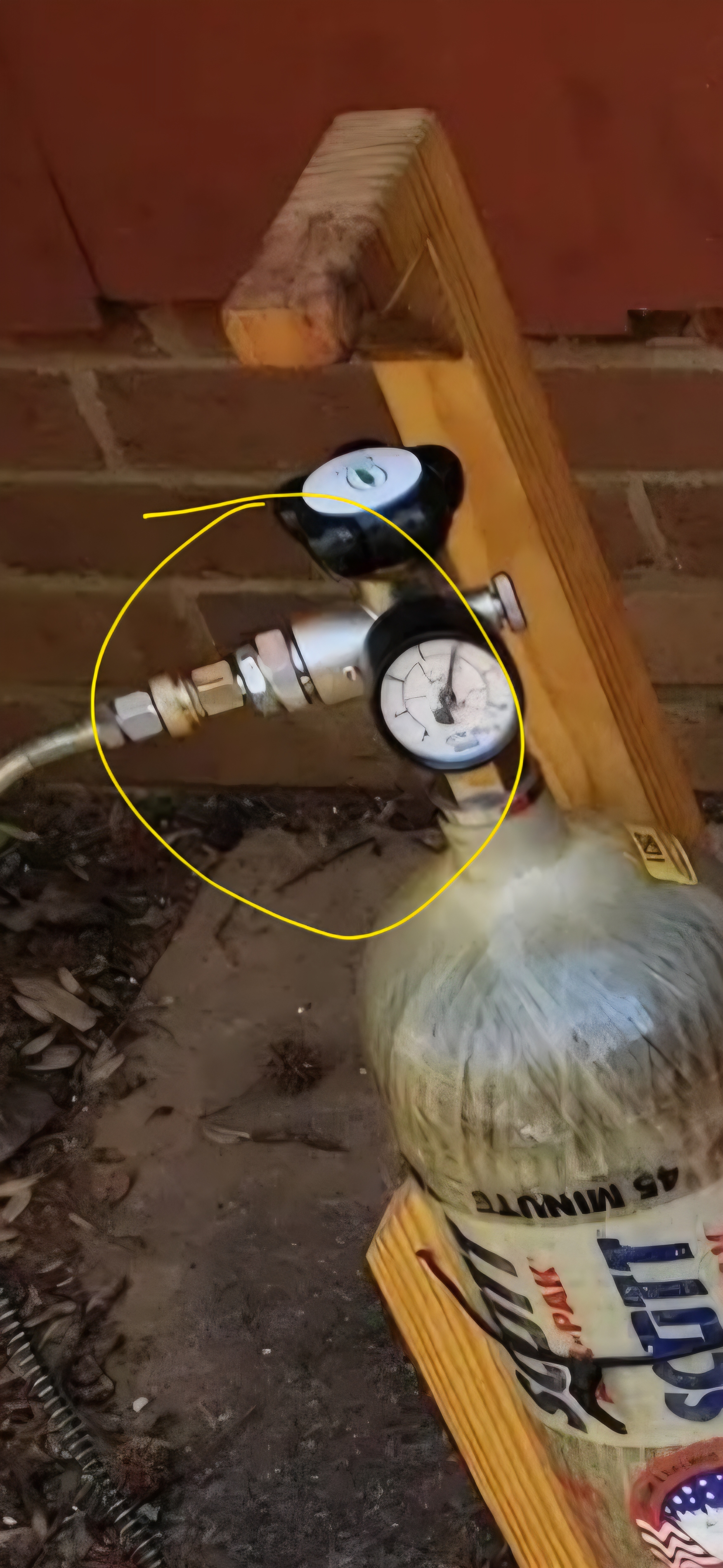

Cga 347
What's this. This the one with resolution good enough to see?View attachment 590526
Probably just an adaptor that goes down to m10 pipe thread or whatever it is. It came like this with the bisley valve from best fittings. All I did was put the qd fitting on.
Confirmed, it came with the valve, can see it down there with the hose attached

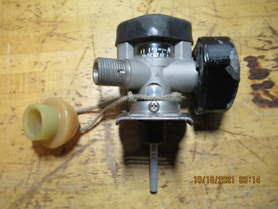

I also use an expired Scott airpak, 45 minute, which I fill with my YH. I use the stock valve but I took the spring out of the stock knob so there is no impediment to rotation of the valve. I ended up buying a somewhat expensive fill set from Air Tanks Plus which works great. But I wonder sometimes if getting a Chinese bottle that comes with a fill set might not be a cheaper way to go. I suspect the Scott bottle is better made, however.
Those Chinese fill valves are awful. I had one which is the reason I have a bisley valve now 😅
Did some digging around, and it seems those 7/8-14UNF to m18x1.5 adaptors are basicaly unobtanium now. But they did used to exist

Did some digging around, and it seems those 7/8-14UNF to m18x1.5 adaptors are basicaly unobtanium now. But they did used to existView attachment 590662
Donnyfl makes an adapter to convert from metric bottle to SAE threads.
