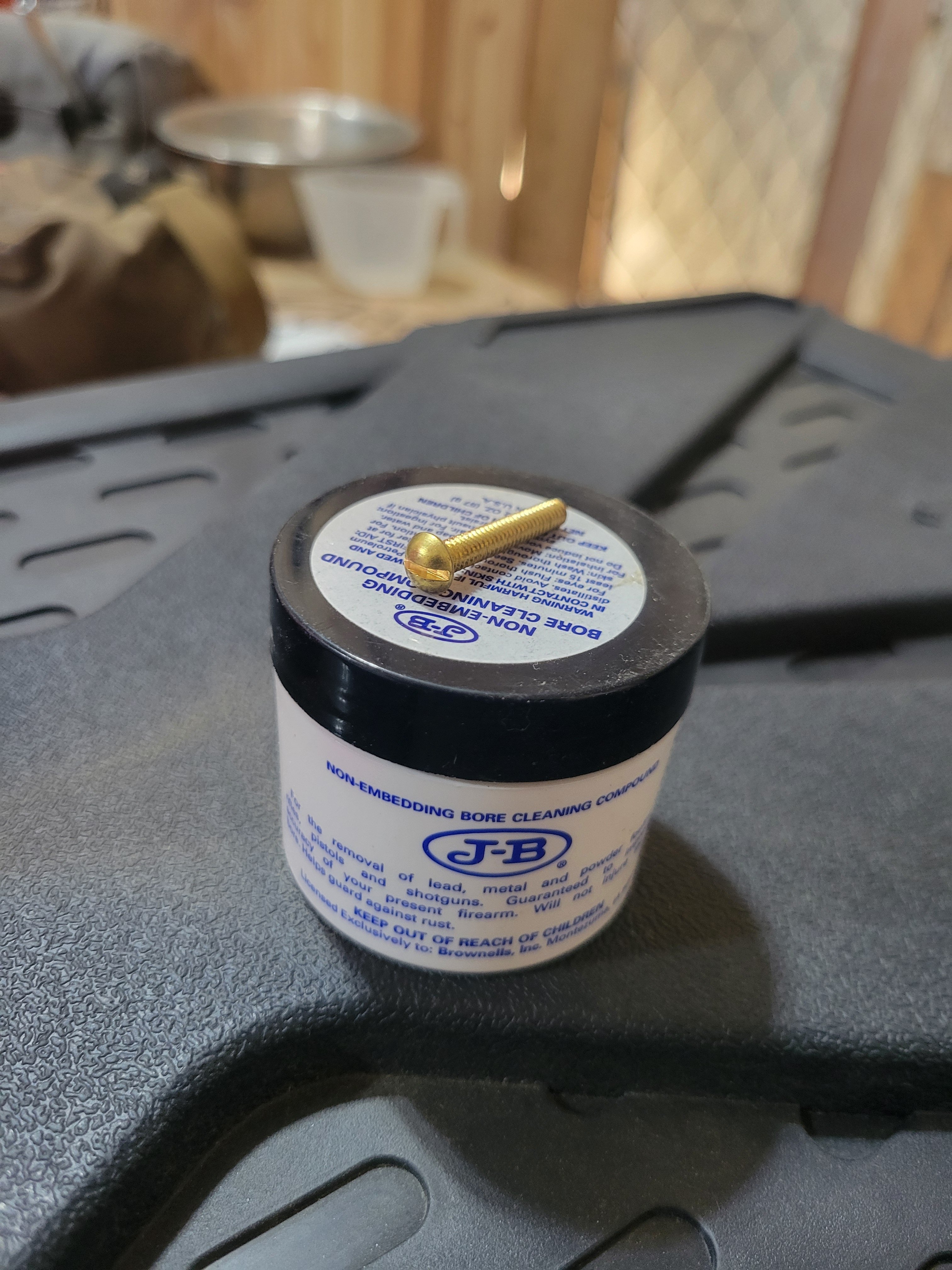

I feel daft asking, what does this brass screw look like? TIA
