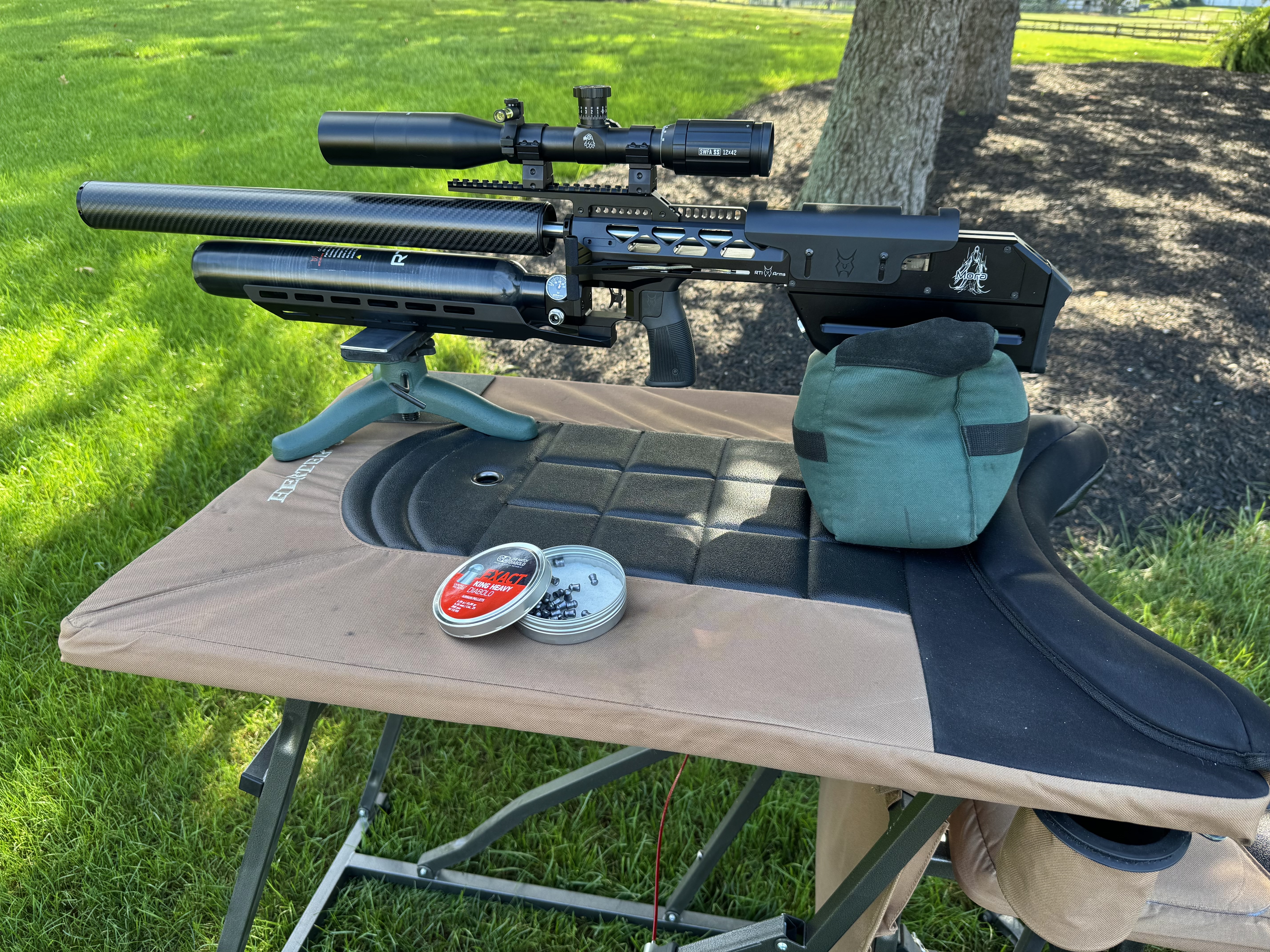

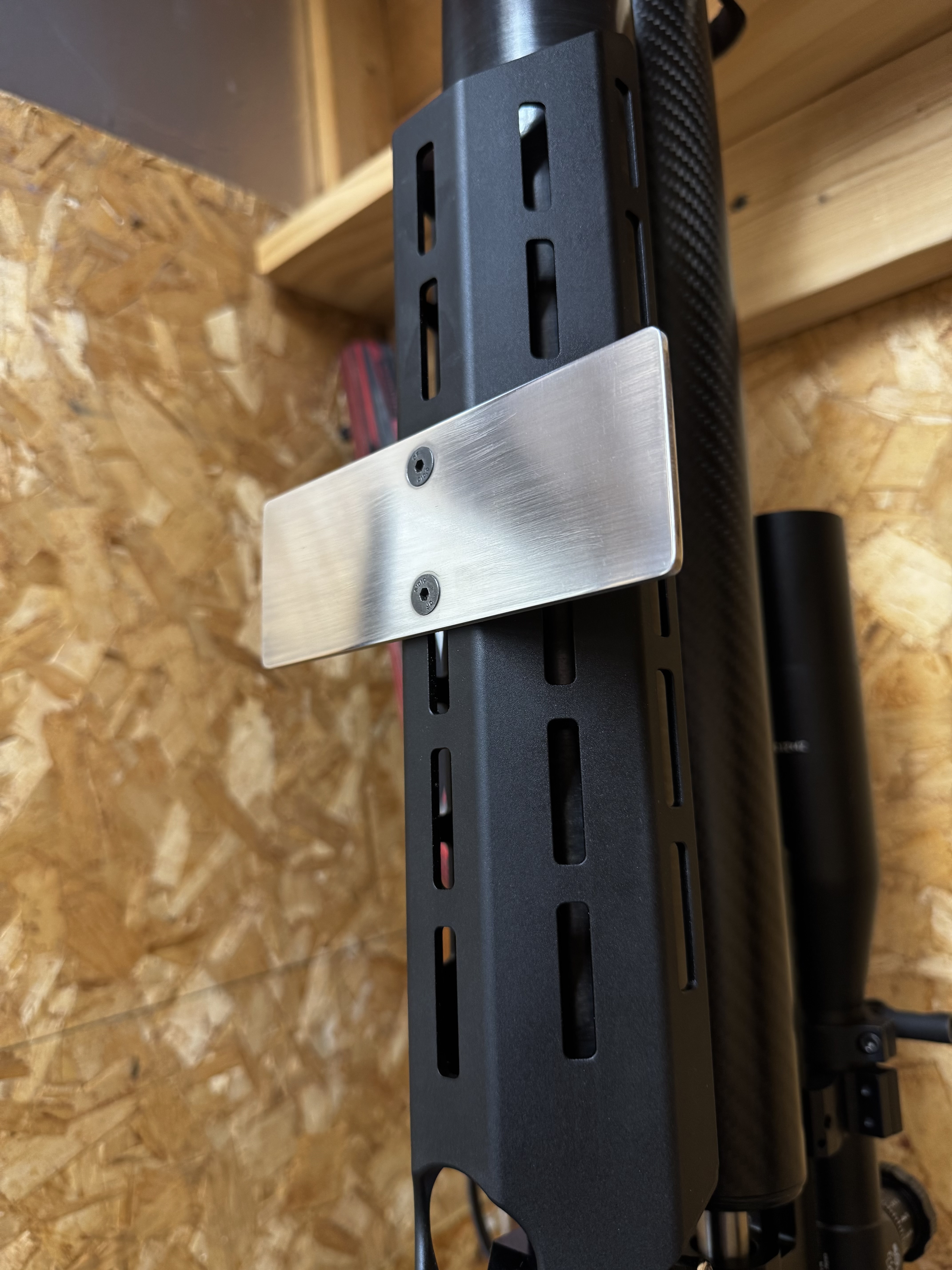

After studying various set-ups and watching a few videos from Brendan Mahaffey, I made some regulator adjustments to get the rifle better suited for the pellets I am shooting. Additionally, the rifle felt too tall on the bench and was a little unstable with the narrow, rounded bottle guard. An adjustable plate fixed that and was made to fit my Caldwell front rest. A simple piece of hard foam on top of the rest provides a nice solid surface for the forearm plate to lay on, and it is set as low as I can get it (just under 4.5").

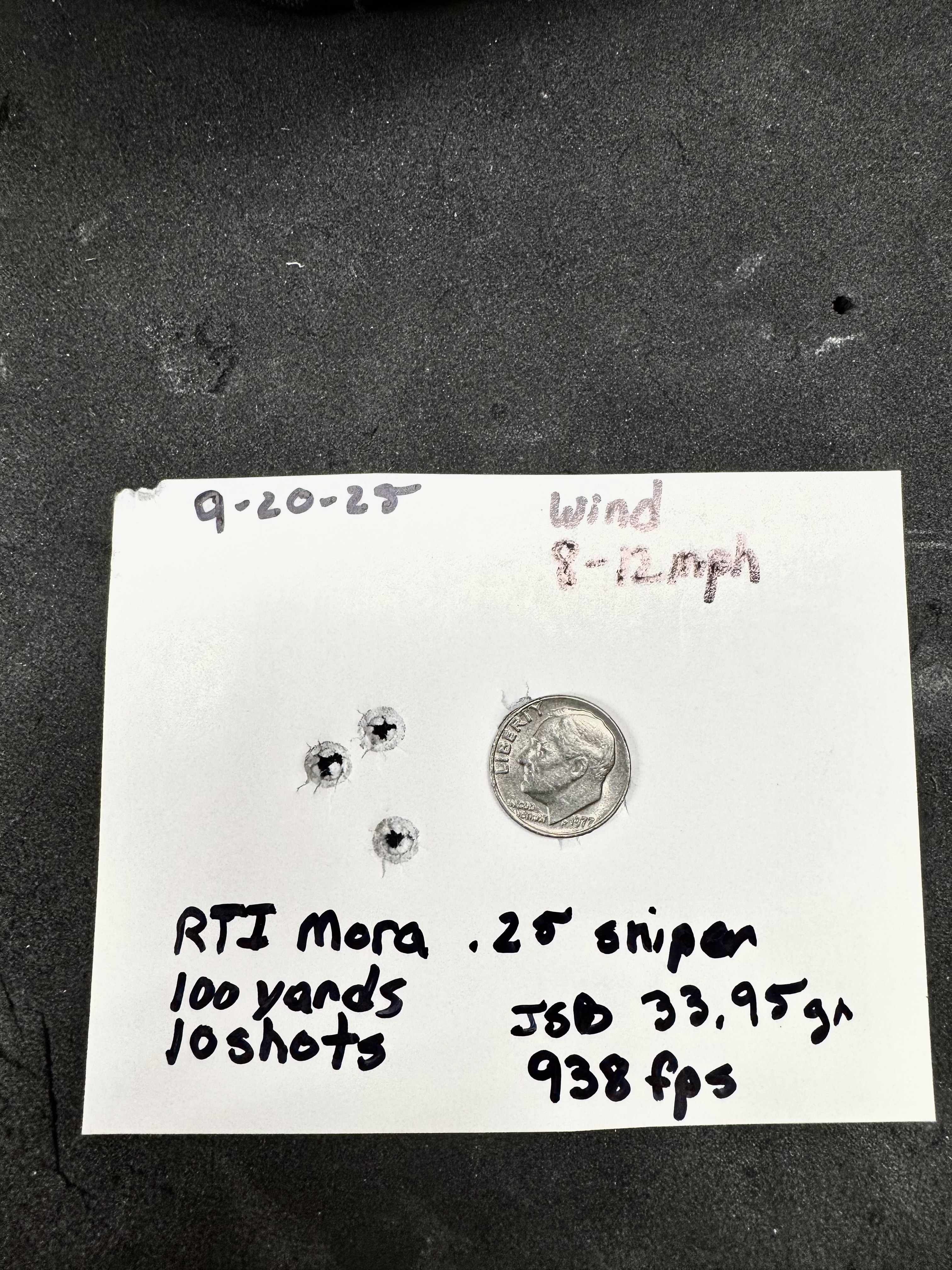

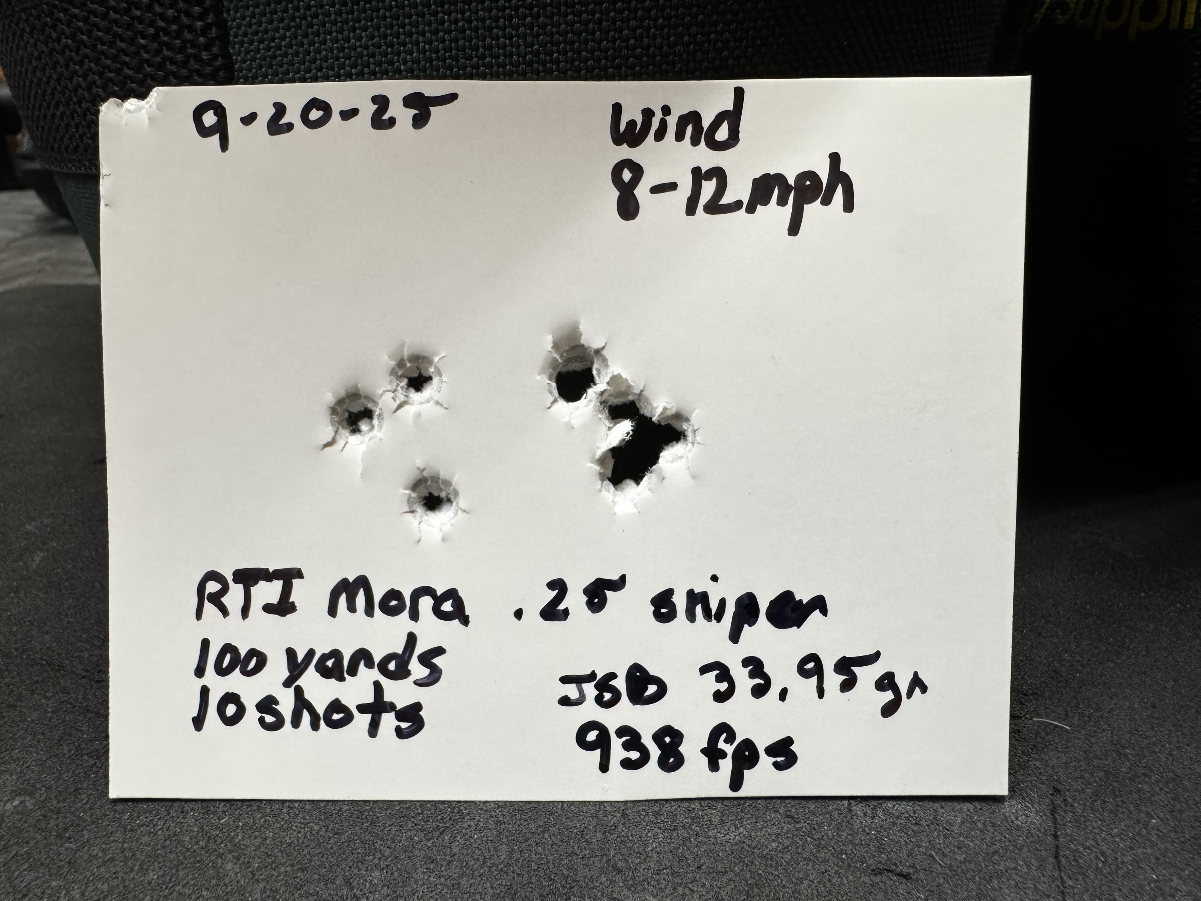

On target at 100 yards the rifle is performing great and is much more manageable with the lower front rest and more forward shooting position on the bench.
Conditions were 8-12mph varying cross breeze. Learning the effects of the wind and reading flags are the challenge that lies ahead for me. But for today I dialed the rifle in with the new set-up and then aimed at the same spot for 10 shots, letting the breeze do what it may while watching the effects when the breeze would pick up. There were 7 shots that fell into a nice hole at just under 1/2" and 3 shots that were carried to the left by approximately 1" from the core group when the breeze was increasing. Now to get some flags and begin to learn how to read them and compensate as breeze picks up.
