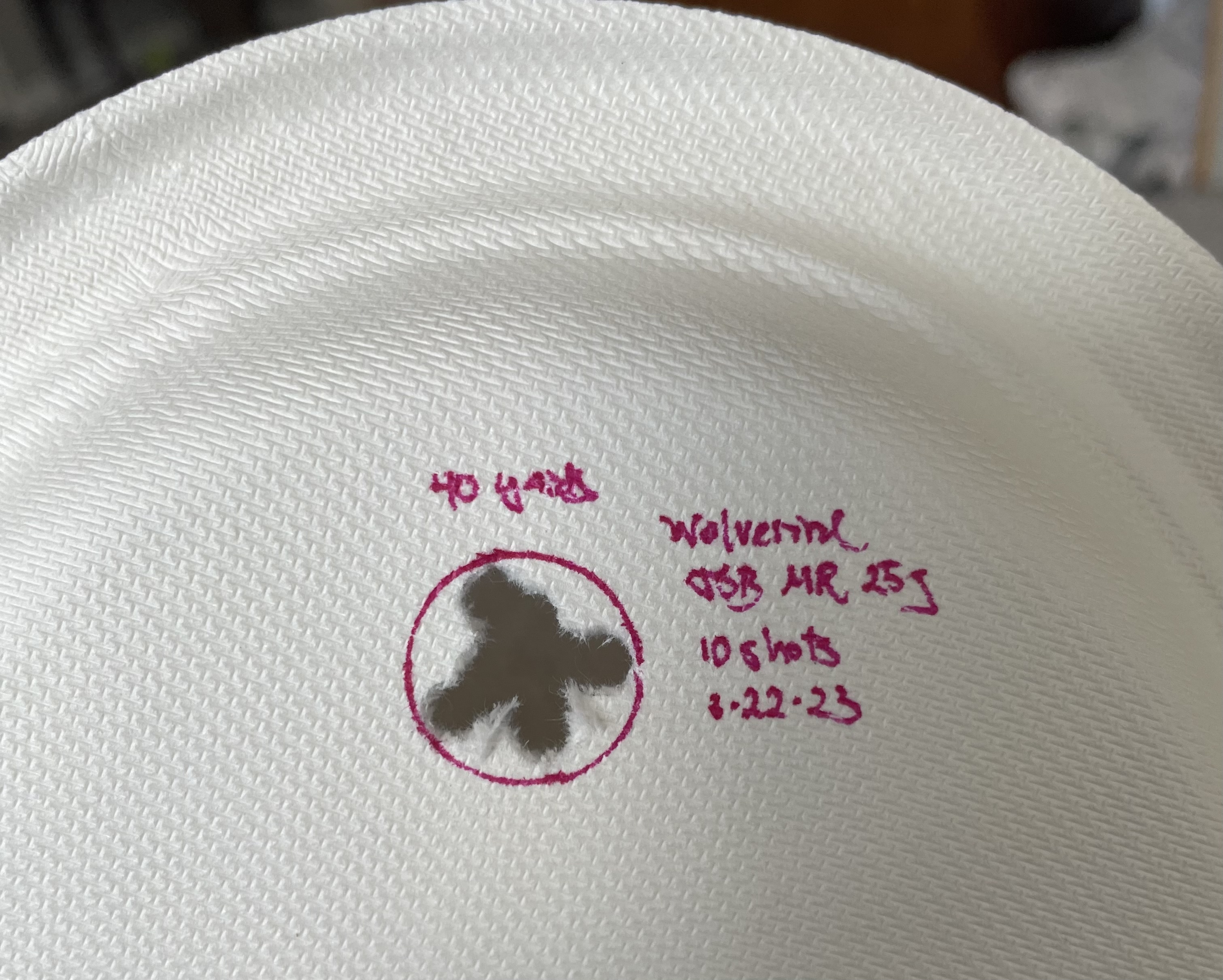

Recently bought a Daystate Wolverine R HP .22 off a forum member. He had less than 100 rounds through it.
I got it out for a little pellet testing today. This thing has a pretty hot tune from the factory:
893-896 fps - JSB MRD 25g
970-972 fps - H&N Baracuda Match 21g
1020-1023 fps - JSB 18g
1030-1035 fps - Hatsan Vortex 17.75g
The MRDs shot best, but all shot nice groups at 40 yards - despite the extreme velocities. Its got a LW polygonal slow twist barrel - unique to the HP version of the Wolverine R.
Anyone have any experience dialing down the power on a Wolverine R HP? I may want to do so in the future.

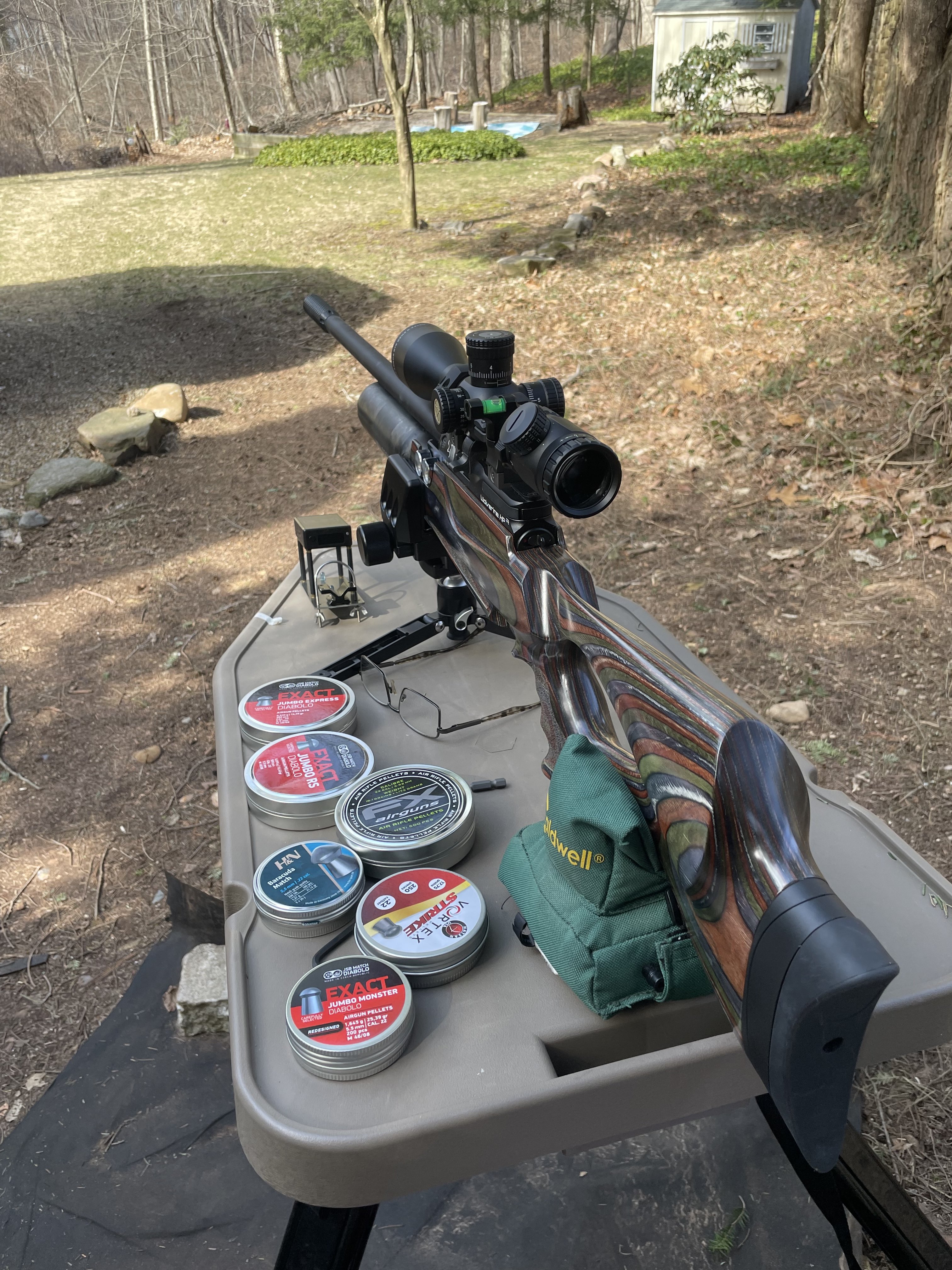

Love the look of that Forrester stock!
