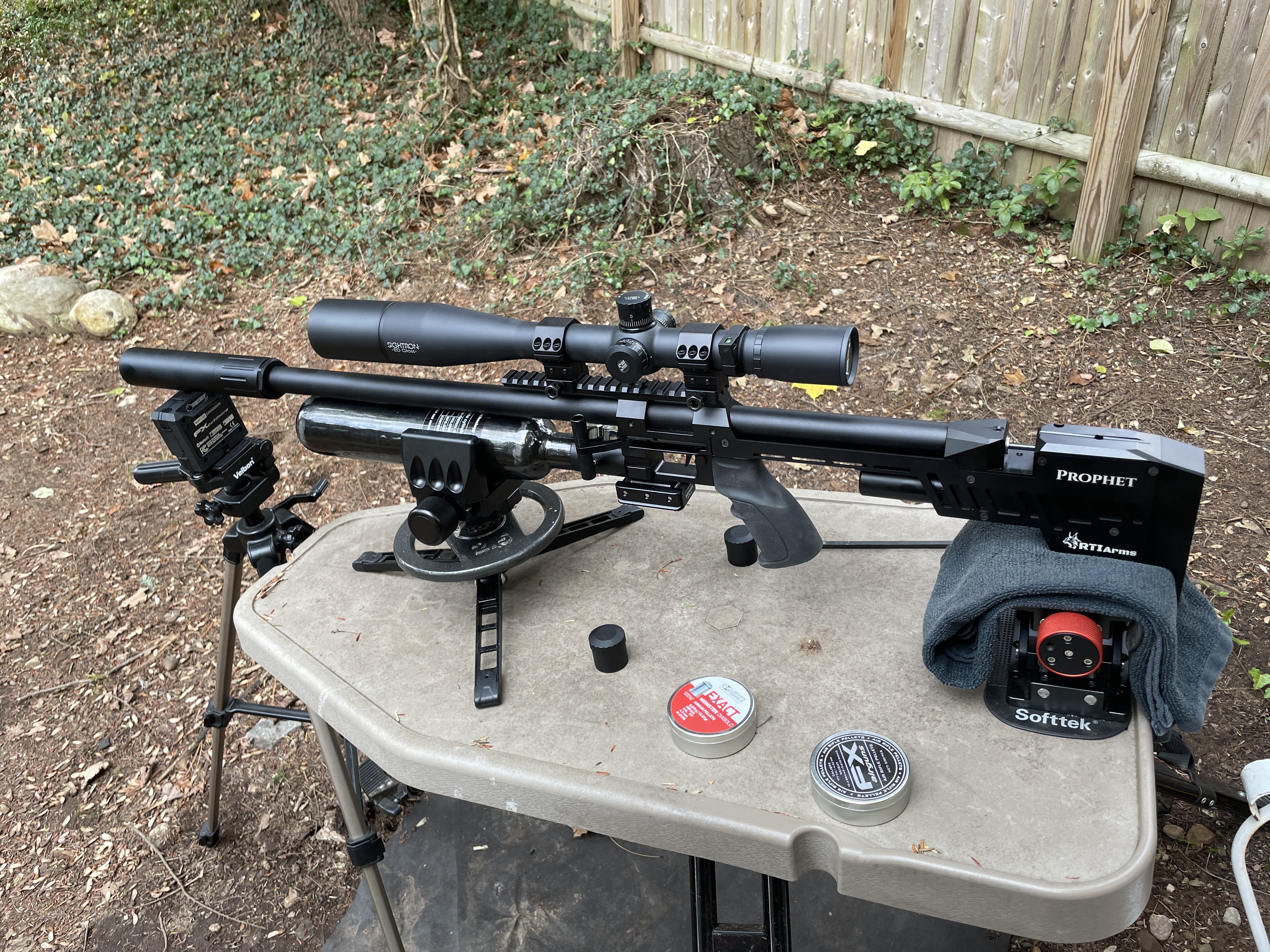

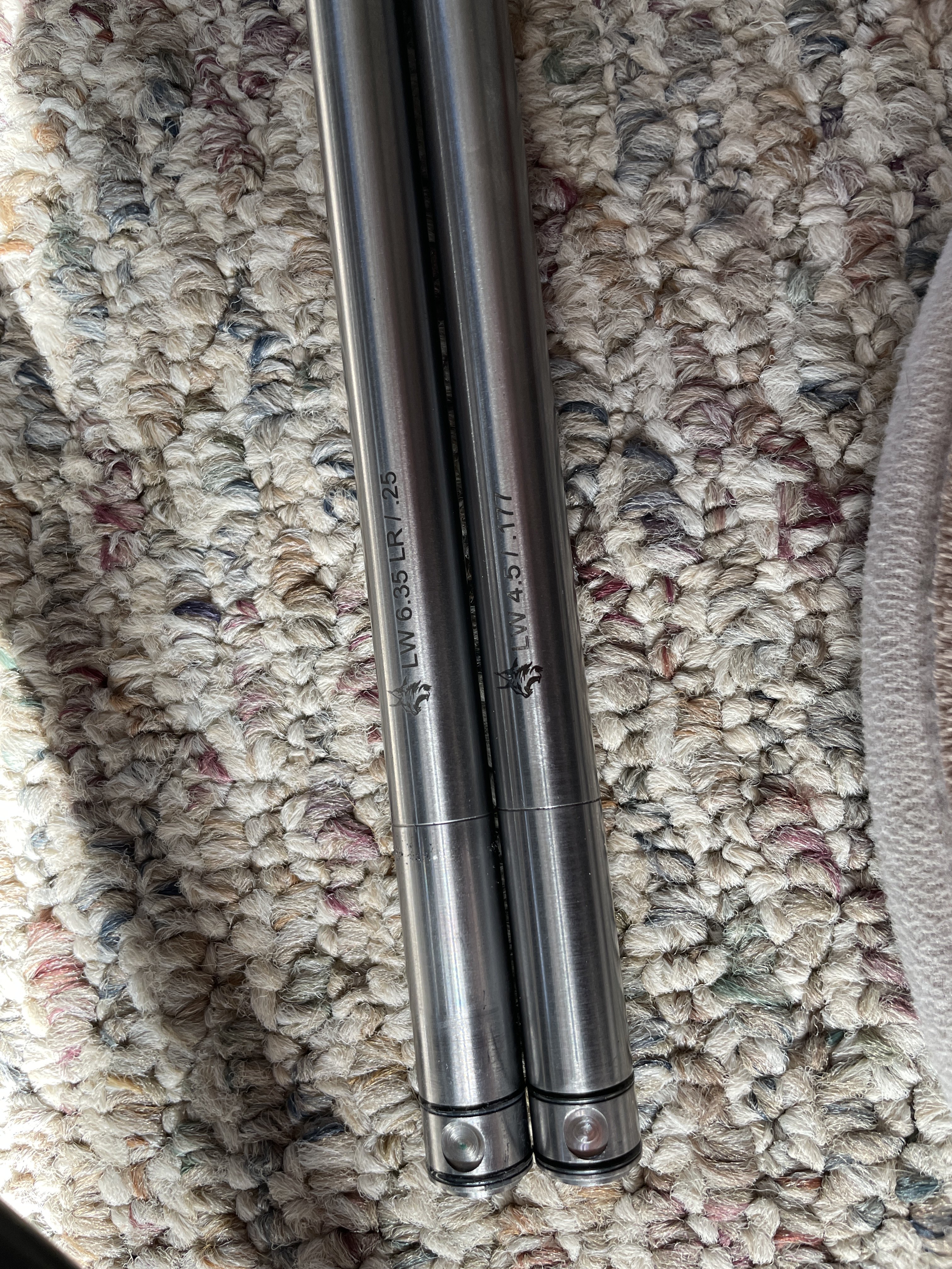

Temps are getting cold in Connecticut, so I thought I’d “winterize” my Prophet by swapping the .25 LR barrel for my .177 barrel. I won’t be shooting and walking my brother’s 100 yard range in the winter - so I figured it was a good time to switch to my favorite backyard caliber.

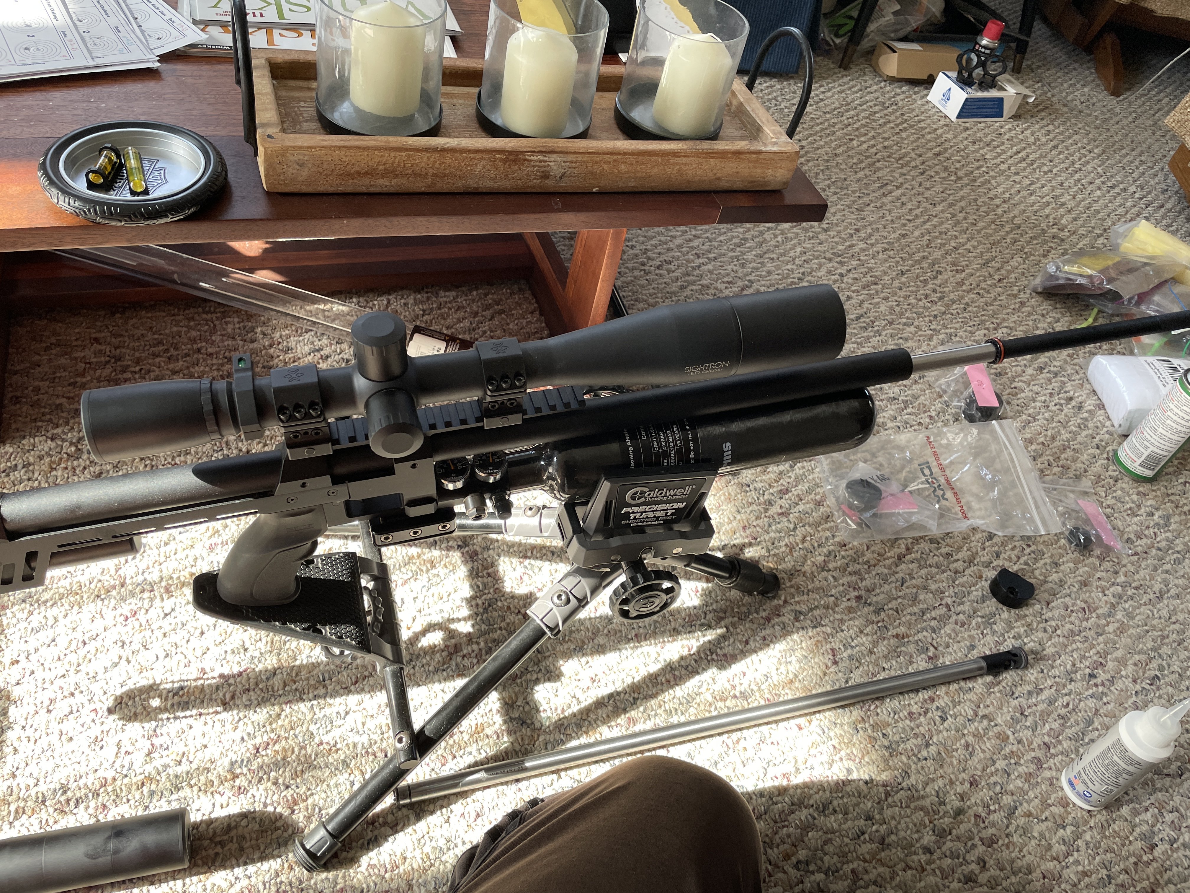

Swap took less than 5 minutes - super easy rifle to change calibers. I kept the .25 caliber end cap on the shroud - figured it wouldn’t make much difference.
I had polished the .177 barrel with Flitz, so I was hoping it would shoot well.
