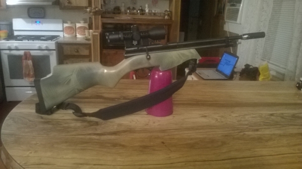

4 shots is real with that set up.
10 shots may well clear the barrel but you would NOT be shooting 40 yards on the 10th!
Thinking QB, bulk fill end cap.
Rigs that seal on the cartridge ( not with a sealed tube) you can tap a hole in the side and run a line there, aka " dummy cartridge".
