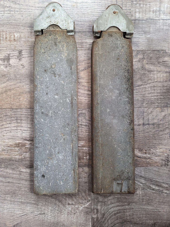

A few years back, I came across some flat cast iron window sash weights at an auction, and for some reason my mind immediately went to "pellet trap." These weights are marked with a "12" as in pounds, so there's 72 pounds of cast iron in total. There were pulleys at the top of each weight attached with with a steel frame which I discarded. The edges of these weights are tapered, so when I alternate them, there is virtually no gap in between.
