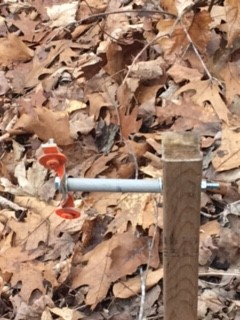

The wind-indicator flags are quick and inexpensive to make. A coat hanger, 18 inches of flagging tape, 3 inches of 1/8” bead chain and some thread is all you need. Nothing fancy, the only thing is that the bead chain should not be able to reach the vertical wire to prevent tangling and that all the bead chains and flags should be the about same size and weight. I use a bit of thread and some lacquer (nail polish) to secure the flagging tape to the bead chain and once a season put a couple of drops of oil on the chain.

Very nice DIY shot of the flag and i really like the spinner/ backstop log slice idea
