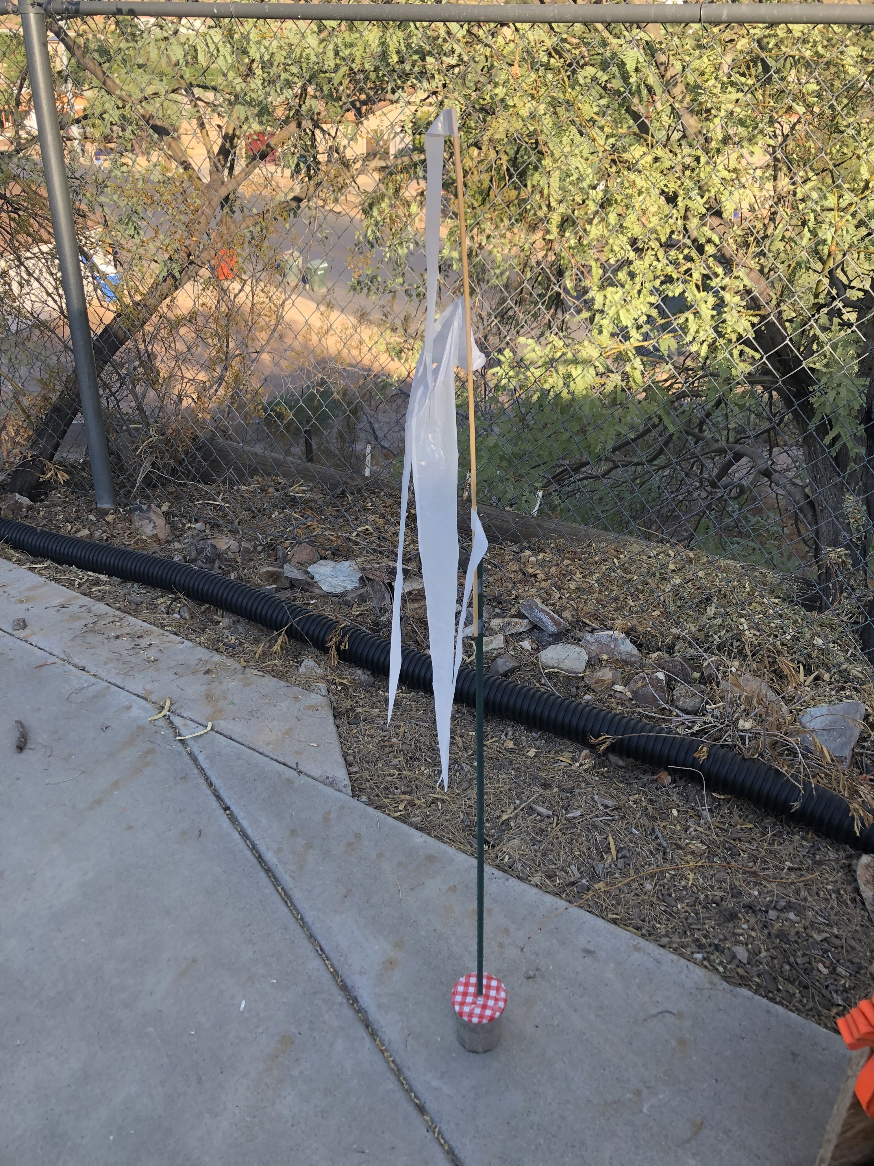

My “low tech” wind flag…
-Ed

Hi Oledawg,
Is this the type of swivel that you are looking for, lol 😂?
-Ed

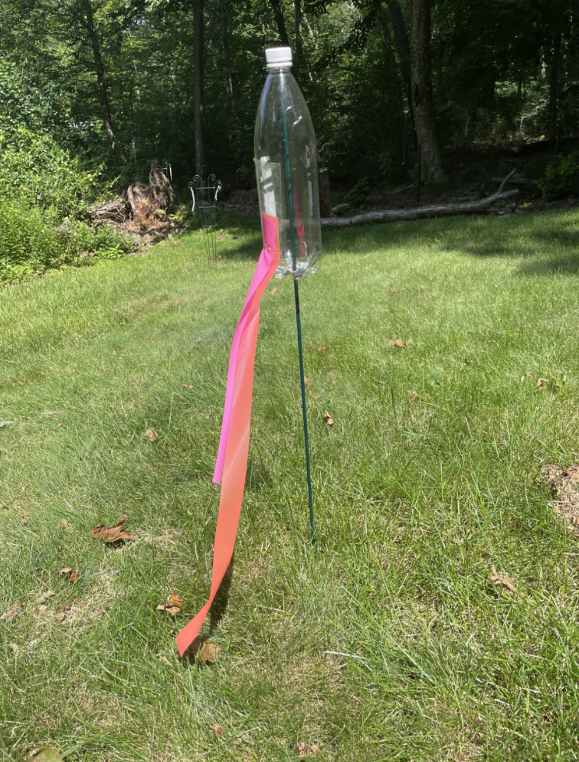

I like it..
I've used electric fence post rod and a bottle but super glued a rudder wing thing ..lol
Today I simply tie a foo to a limb
Heck a cup stick nail and ribbon will do for fancy
Reactions: oledawg

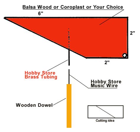

Looking for the heck of it I see some I could find materials around the house shop
Wood dowel (old broken broom handle)
Hobby store wire ( straight part clipped off metal coat hanger).
Rudder ( good cardboard box cardboard at the minimum).
Hobby store brass tubing (Aluminum drinking straw )

Thanks that is exactly what I was looking for. Time for a trip to Ace Hardware and then maybe the hobby store.
