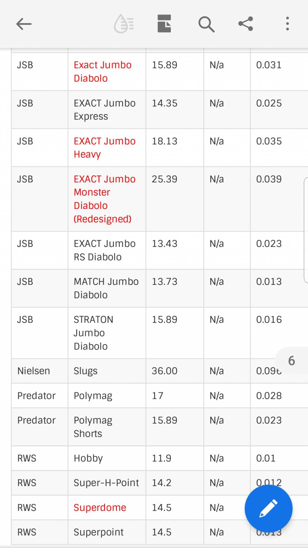

that BC for the .22 Jumbo Monster RD of 0.047 BC seems rather high.... The test data of the comprehensive BC test by HardAir Magazine shows 0.039.

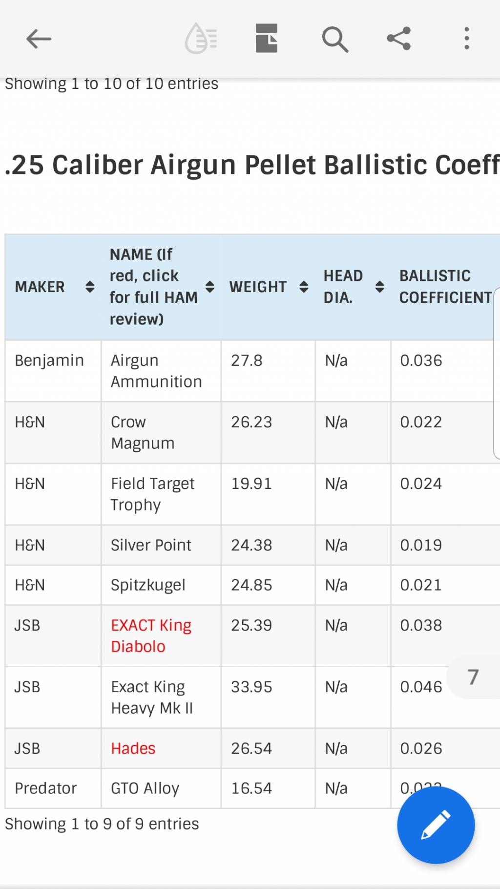

And a BC of 0.062 BC for the .25 King Heavy seems more like the BC of a slug than of a pellet. The BC tests found 0.046
Here're a couple of screenshots from HardAir Magazine's extensive BC tests.... 😊
Matthias

HardAir Magazine tested the .25 Heavy Mk2. Not the King Heavy (Mk1). Not much but different.
My beef with them is they don’t test at “accurate or normal” pellet speeds. They test the .22 RDM at 718 FPS and the .25 Mk2 Heavy at 654 FPS. What? No one shoots those pellets at those speeds and of course the BC will be low. .
.22 RDMs should be tested between 925 and 975 FPS, and the BC will be about 0.050 to 0.053.
.25 Heavy Mk2 should be tested at 850 to 900 FPS and the BC will be similar to the RDMs. And the King Heavy Mk1 will be slightly higher.

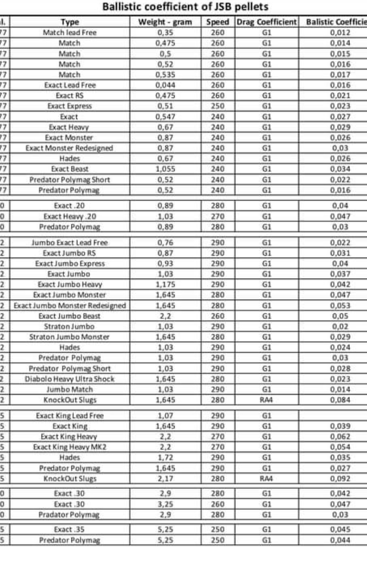

It makes a huge difference in BC what muzzle velocity is used. Not sure why HardAir does that with the low speeds? If you look at the JSB BC test charts they test their pellets/slugs at realistic speeds. Their speeds are listed in meters per second.
