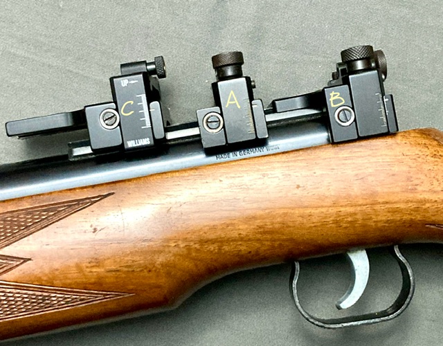

The FP-AG is the usual choice for springers - I've used them successfully on both rail and groove mounts for years. But some have noted issues getting it to go low enough on a rail-type mount. BUT NOTE - the current FP-GR can give fit problems. (Apologies for the odd pic below, which combines parts from different sights! The gun is an old BSF with a Diana-like separate sight rail and a REALLY low sight line.)
A = FP-AG sitting loosely on the gun's rail.
B = FP-GR base hard-mounted on the rail, with an older riser arm.
C = Loose older sight base, with the FP-GR riser arm.
The issue is that the current FP-GR's base and riser arm are much taller than the FP-AG's. They can hit wood, unless the stock is really narrow, which is why I had to mix'n'match parts on this rifle. The base just barely fits (and would not have worked at all on an HW). The riser arm was too tall for this gun and would be completely out of the question for an HW.
