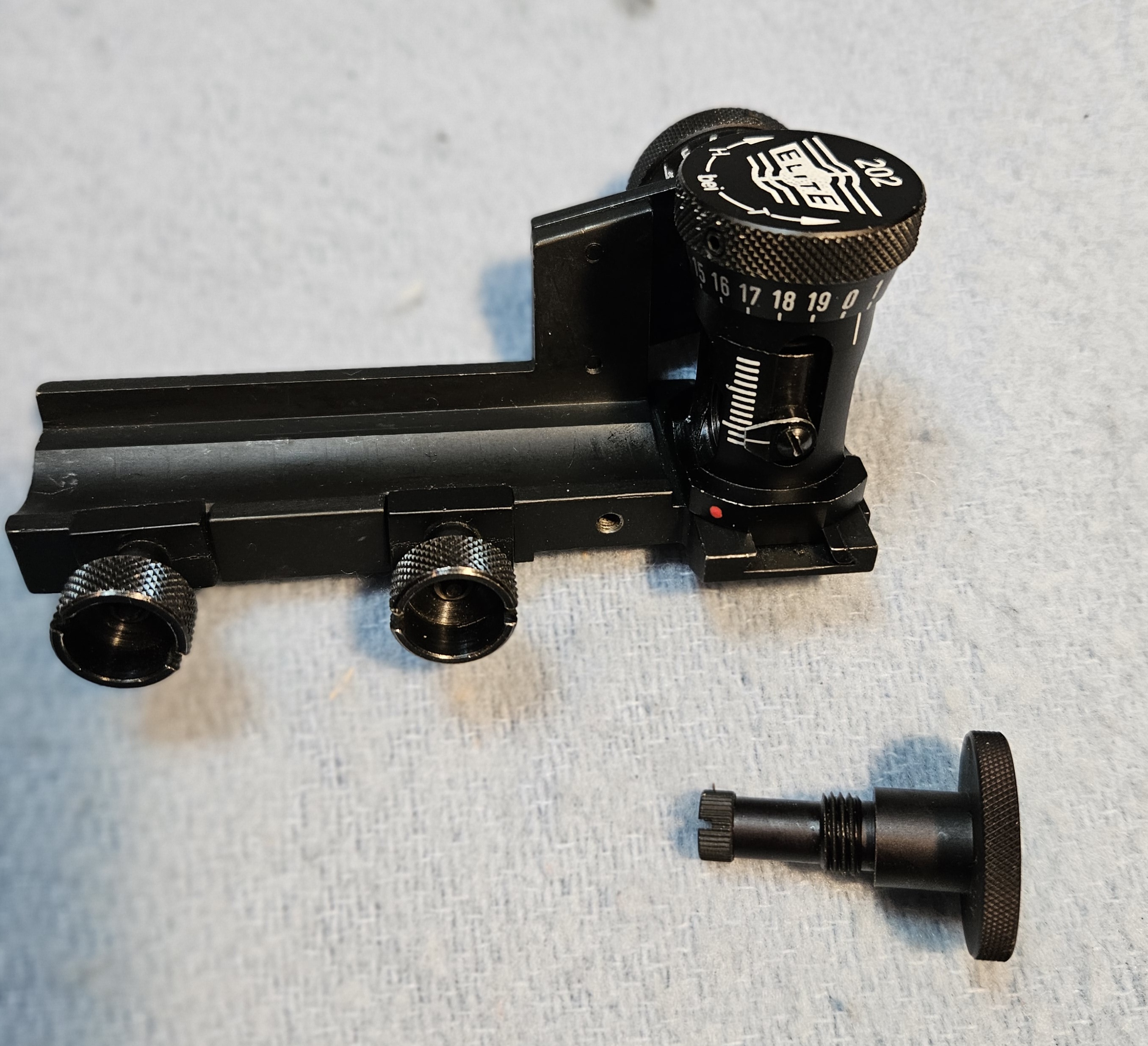

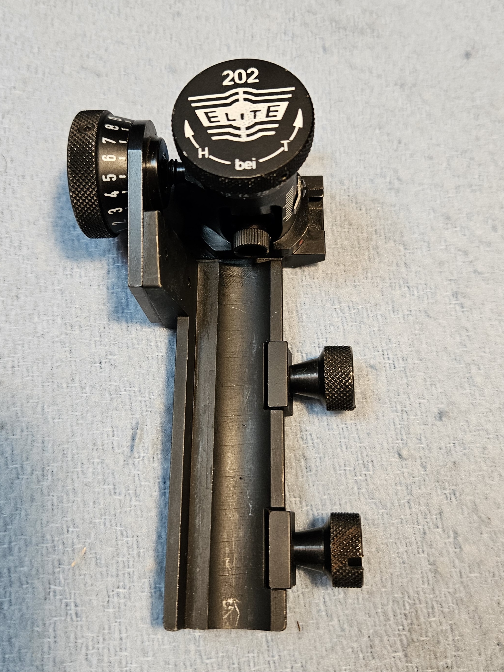

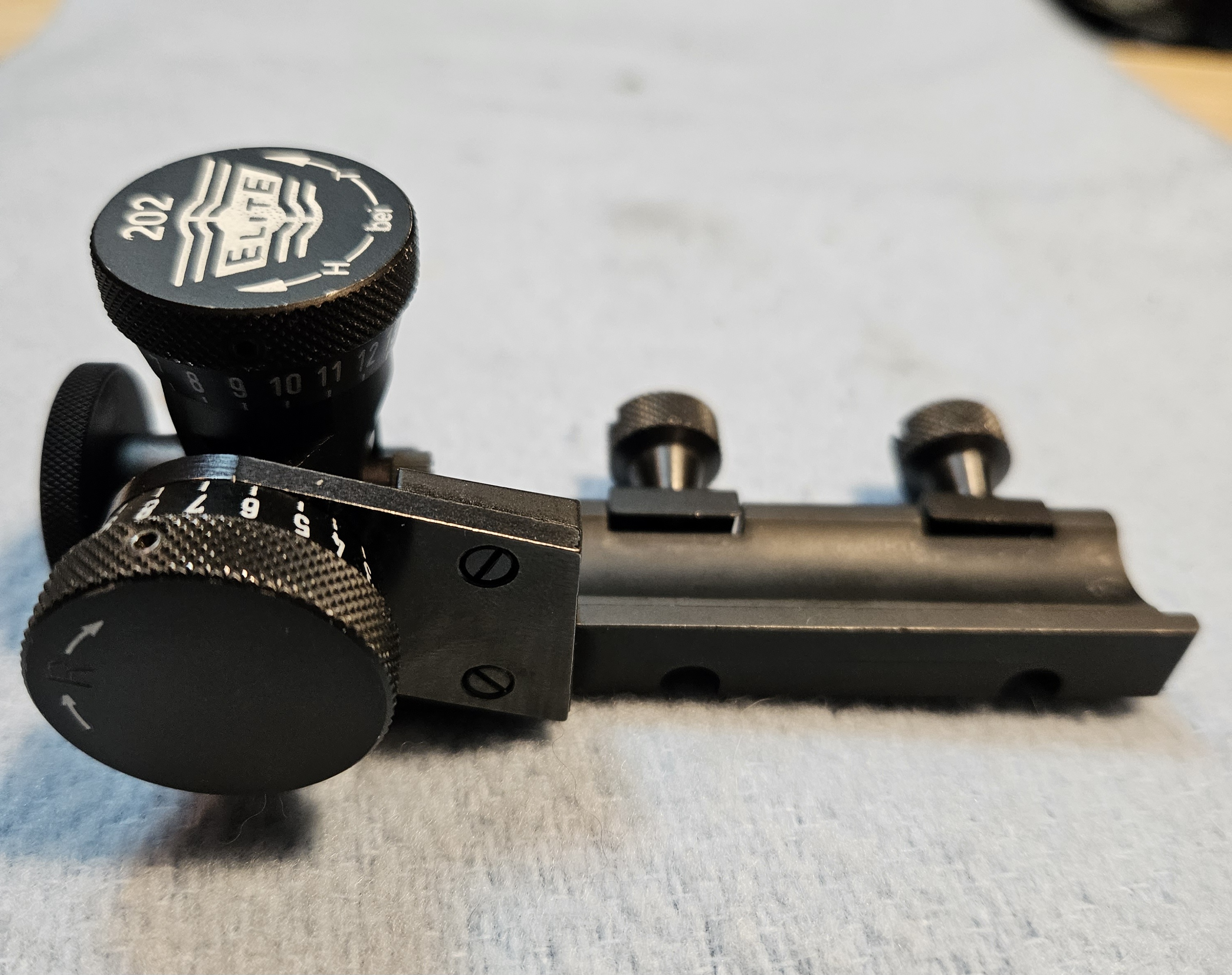

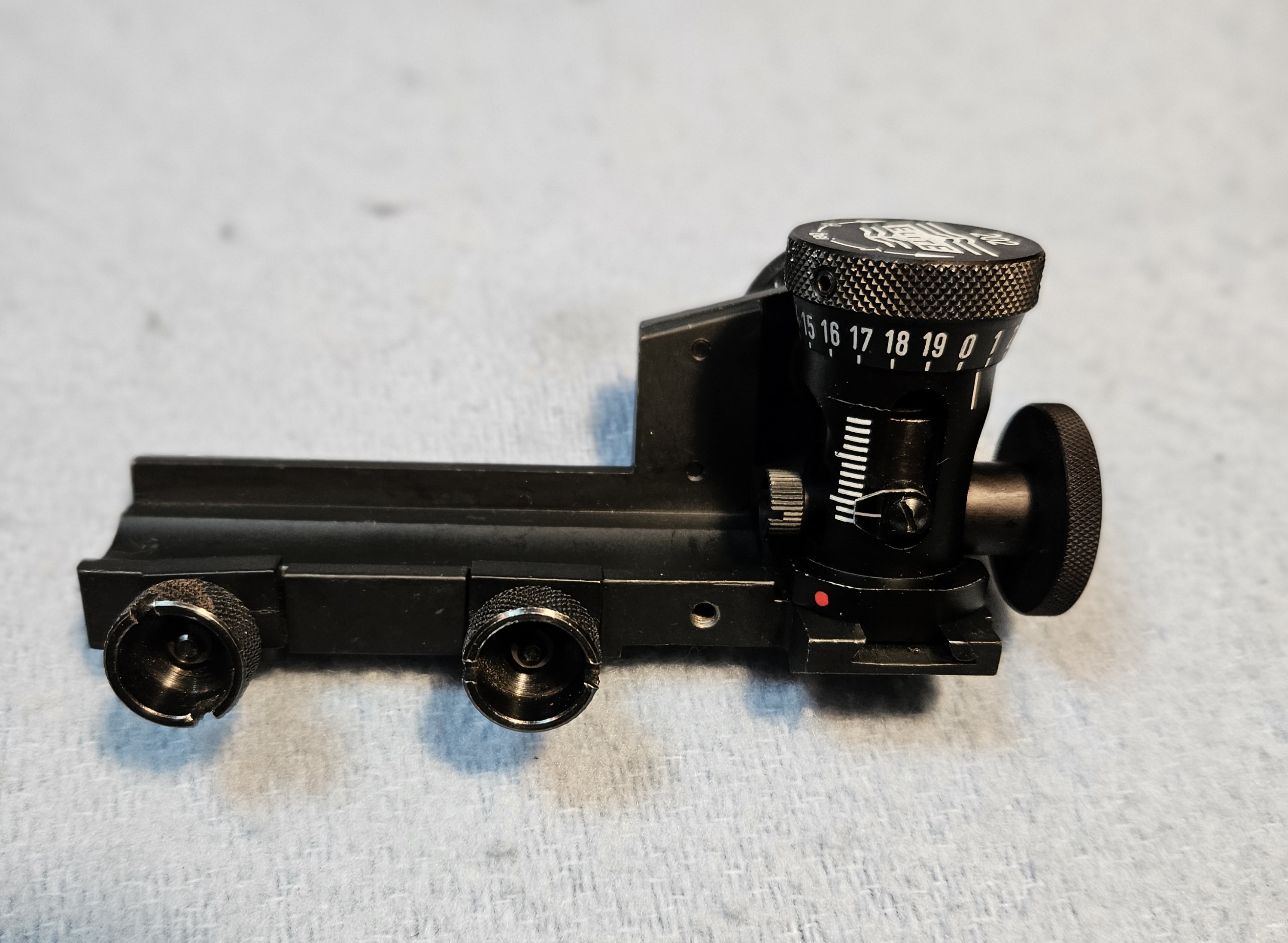

Swiss made Elite model 202 rear sight.
Not to be confused with the Swedish made Elit rear sights.
Supposedly, Elite was sued by Elit for copying their rear sight design that was available as an upgrade on the Diana 10M rifles. Elite apparently quit manufacturing that pattern sight and moved on to different designs.

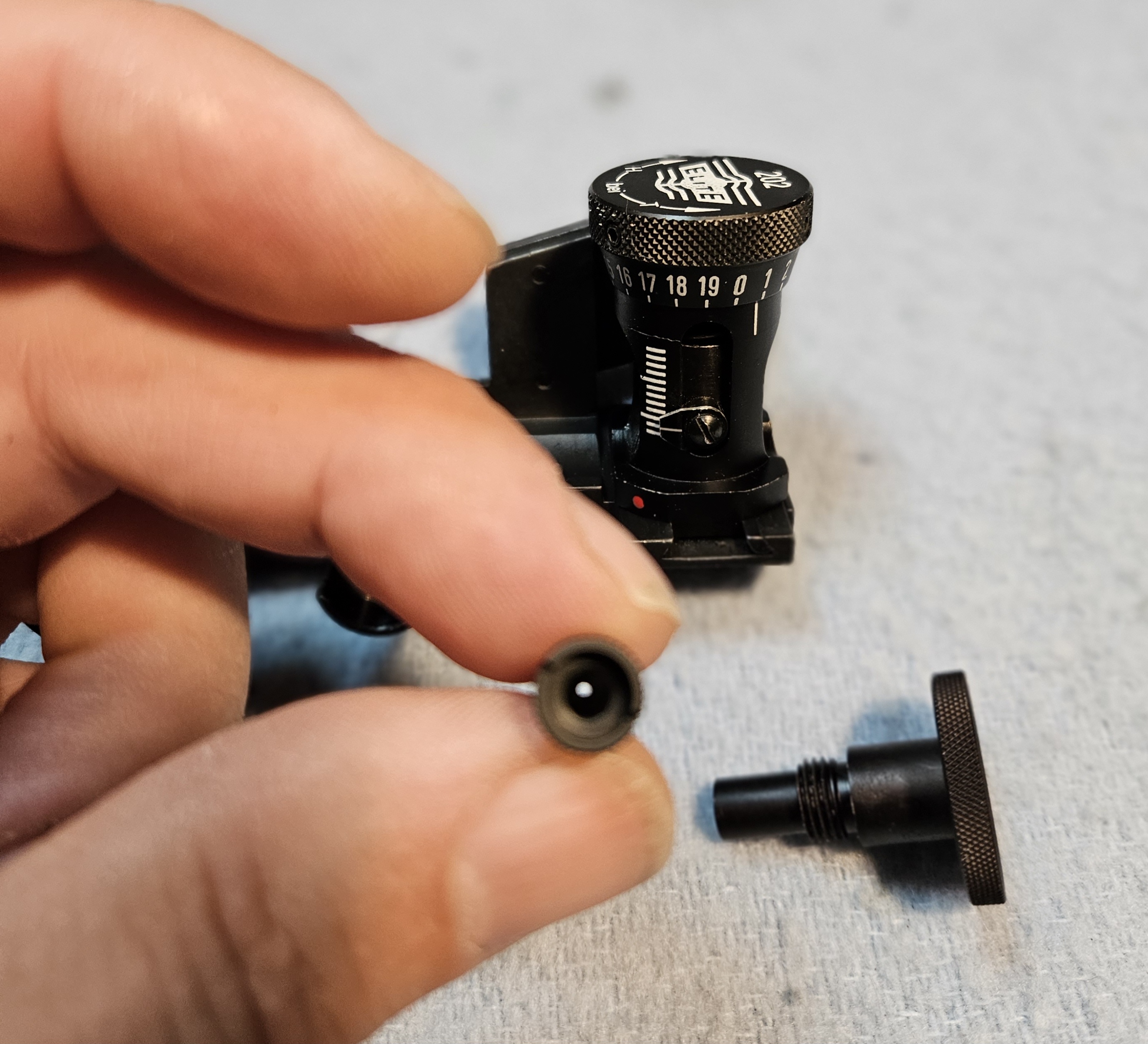

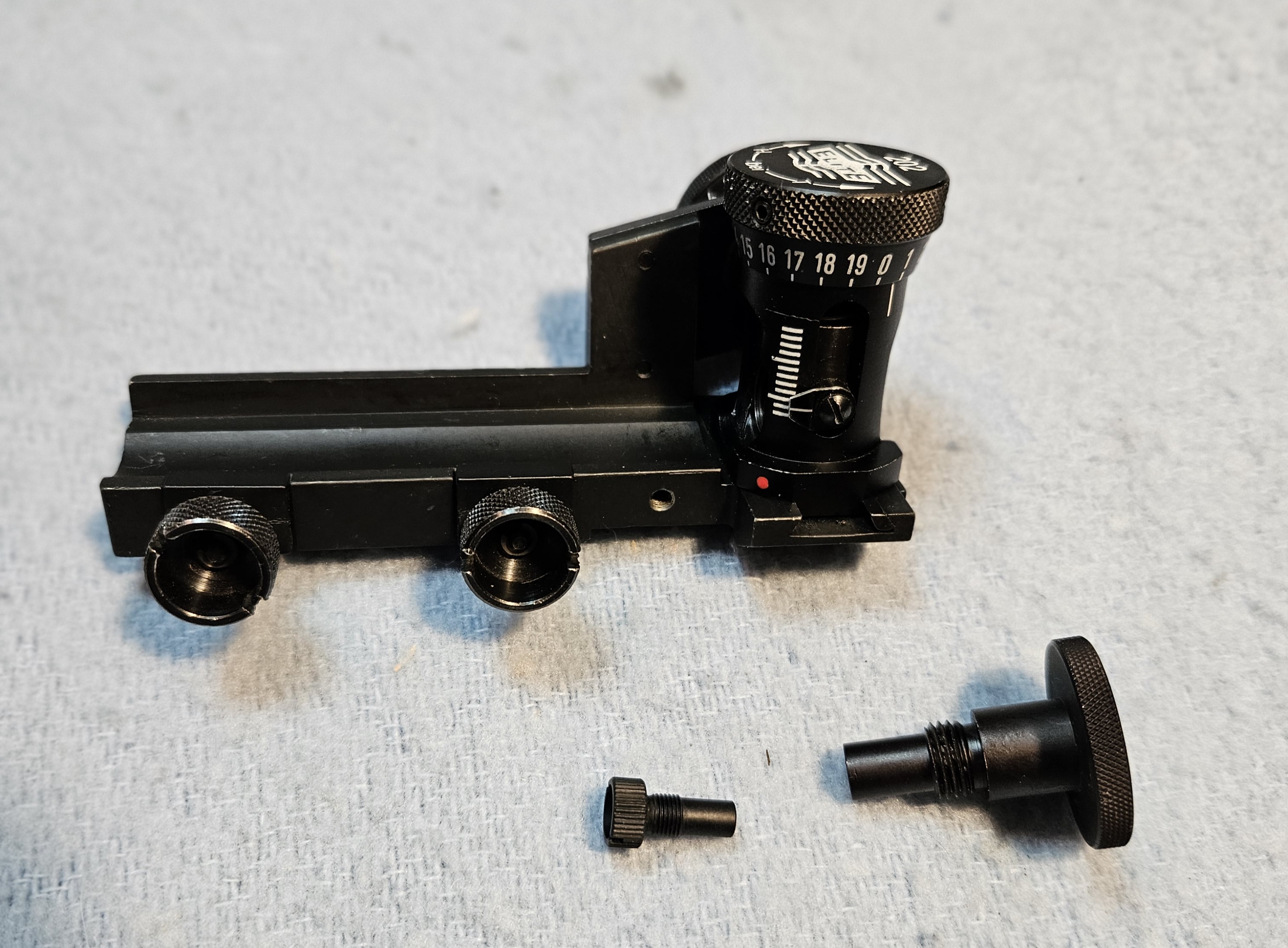

An interesting feature of this sight is the eye piece and aperture set up.
As you can see, it is removable just like all the others we are familiar with, and the sight body is threaded to accept adjustable apertures from the likes of Gehmann.
The different part is that the actual aperture is threaded into the front of the eye piece and is removable, so as to change aperture size.
It is a 20 click rear sight and mounts on an 11mm rail. I have had it mounted on a few rifles where it has worked wonderfully.

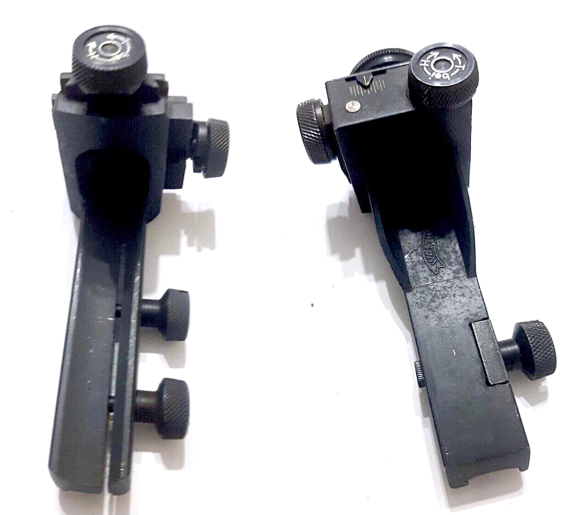

Because I have never owned a Walther Diopter, I want to be clear for everyone. So, this Walther on the left “round” WILL-NOT fit the 11 mm dovetail grooves and the Walther ”square” on the right will fit the 11mm dovetail. Is this correct?

Because I have never owned a Walther Diopter, I want to be clear for everyone. So, this Walther on the left “round” WILL-NOT fit the 11 mm dovetail grooves and the Walther ”square” on the right will fit the 11mm dovetail. Is this correct?View attachment 400536
The left one is not the old "round" pattern. It's a somewhat later steel upgrade model intended for firearms. The one on the left is a contemporary Walther alloy sight. Both of these fit Walther grooves which are around 11.5 mm. The sliding foot on the alloy one is pretty tolerant of variances and will fit most 11 mm grooves with no problem, though sometimes does not sit perfectly level.
I'll try to post a pic later today that may help ID these various Walther models.
