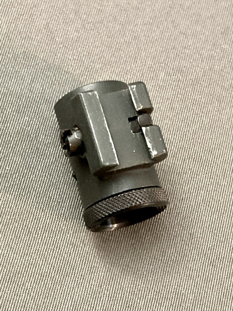

MDriskill, levgen721 et al, does anyone know if the Gehmann front sight unit that accepts the adjustable iris will fit on HW?
Iris Gehmann 520 will probably suit you, but it’s better to wait for someone else to answer. I don’t see the point in spending money on Gehmann iris, it’s easier and cheaper to buy OEM Weihrauch inserts for the front sight.
Gahmann 520 will probably suit you, but it’s better to wait for someone else to answer. I don’t see the point in spending money on Gehmann iris, it’s easier and cheaper to buy OEM Weihrauch inserts for the front sight.
Thanks. I have a NIB 520 18mm and the front globe it threads into. I’m wondering whether the front globe will fit the HW front dovetail.

I don't have a Gehmann 520 so this is a pure guess! But most newer aftermarket front sights have 11mm spacing on the rails - works better with the chunky barrels, weights, etc., on current match rifles. The HW's, and many other older match guns and current sporters, have 9mm front rail spacing.
A reasonable way to get a sight with 9mm rails and M18 securing sleeve is older Anschutz units. These show up a lot on auction sites, etc., for reasonable prices. Nice sights too, with a ton of different OEM inserts in addition to all the M18 accessories out there, as mentioned above.

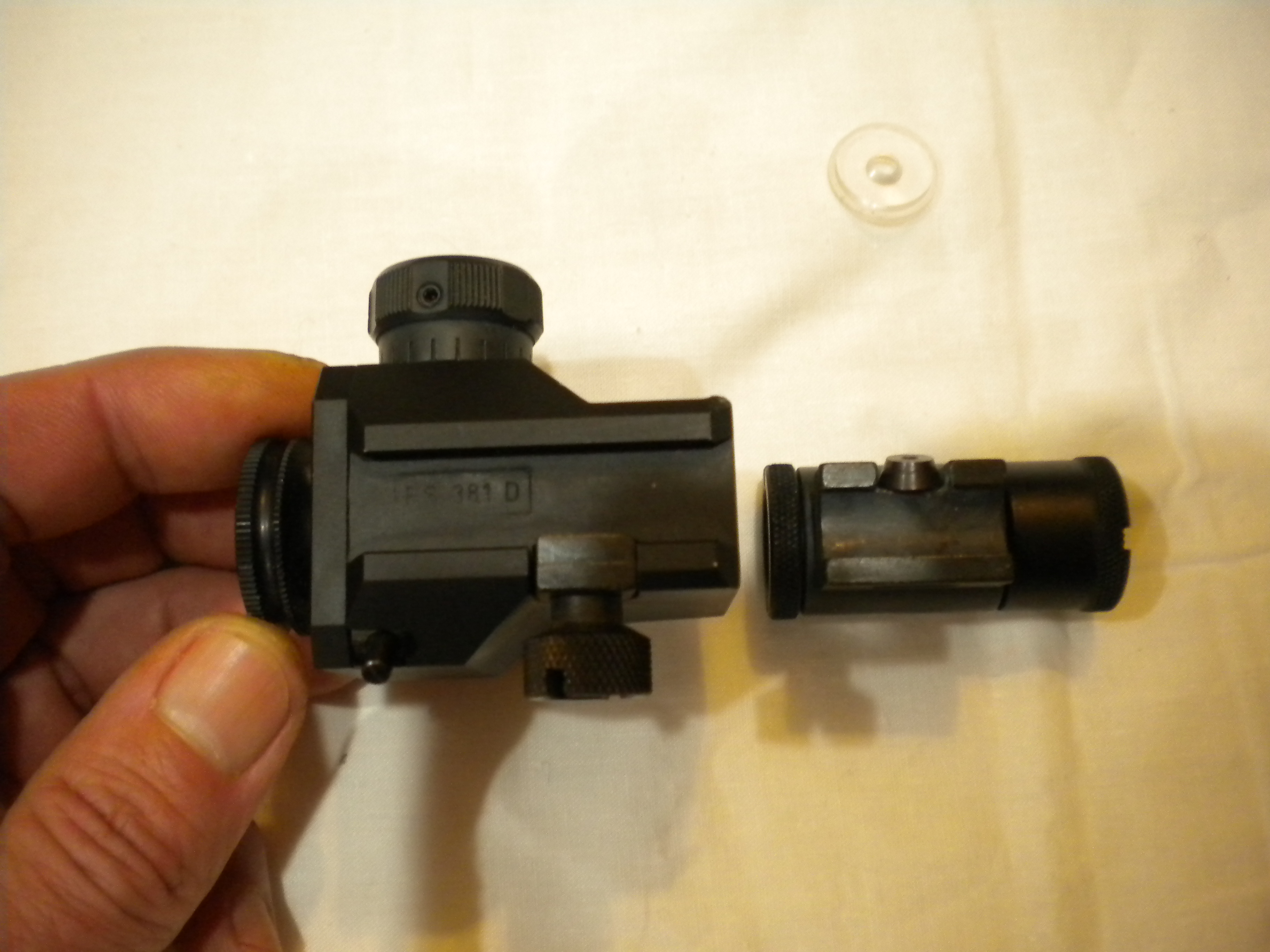

Here's an Anschutz sight on an HW barrel, it fits the rails and centers up perfectly.
Not all front sights with the same 9mm mount are interchangeable! For example, the HW front sight will not work on Diana with the same 9mm mount! That’s why I’m always against non-original front sights. I installed a new Gehmann 598+iris566+iris522 on my FWB, only because my original rear diopter was lost when moving , only the original FWB front sight remained. Also, the 598 is much better than the original FWB rear diopter, and the AOA ridiculous price left me no choice. For the whole set I paid $250 with delivery, the MSRP of this set is about $700.
Reactions: jbuchse17
I have actually swapped vintage Diana and HW sights, but you are correct - it's a VERY rough fit! Won't do it again, and don't recommend it.
The nice thing about the Anschutz unit is they clamp by means of a small movable steel "foot." IMHO a much better design than the old Diana, HW, and Walther sights, which work by flexing the sight base itself. This makes them tolerant of slight variations in groove spacing, and an easy "tip-off" fit for Diana or HW grooves. Plus, as already noted moving up to the Anschutz's M18 sleeve thread has many benefits.
To be clear, this particular model has no advantage over FWB's match front sights, and does NOT fit their wider groove spacing. But I really like them on Weihrauchs especially.

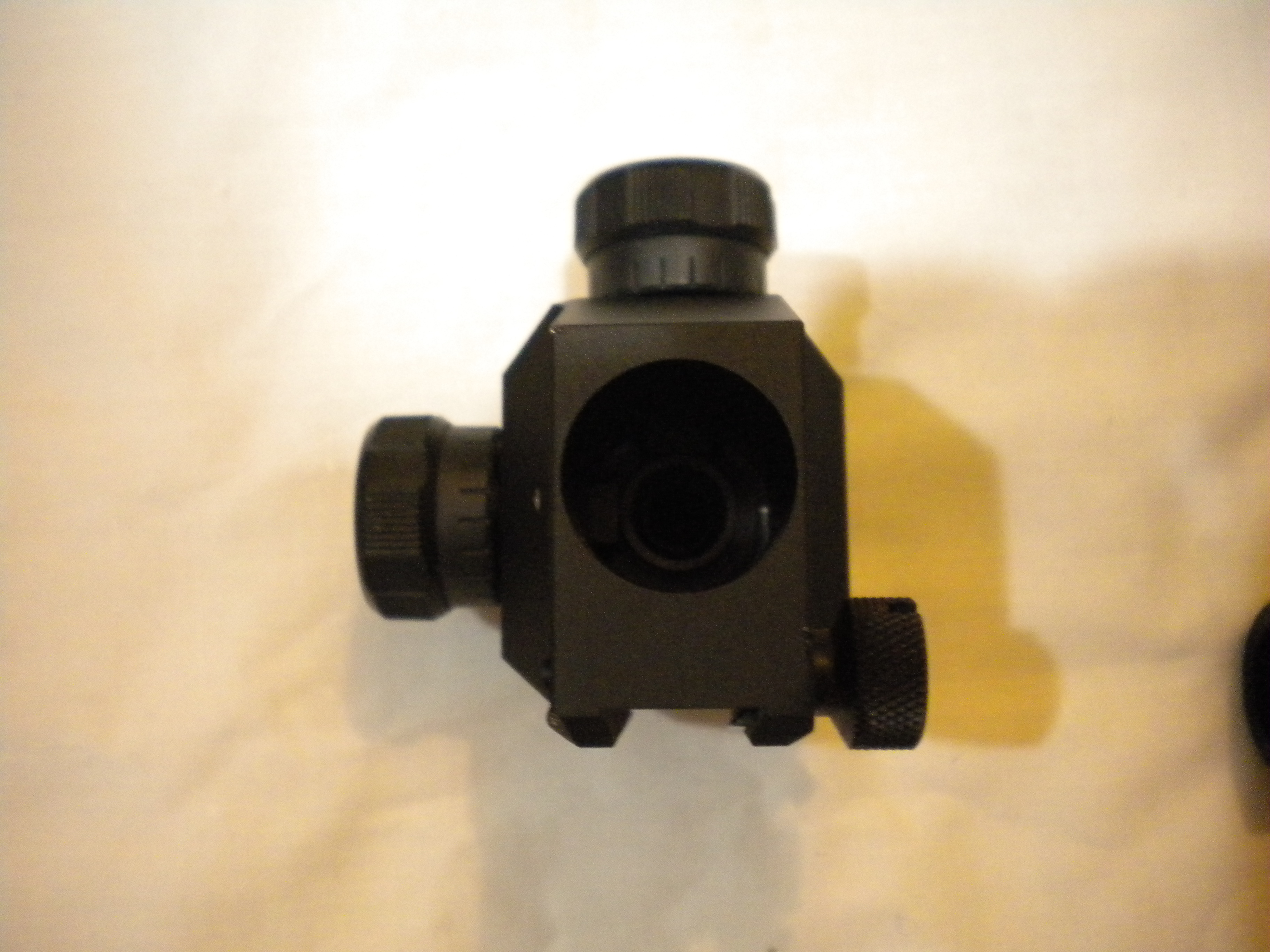

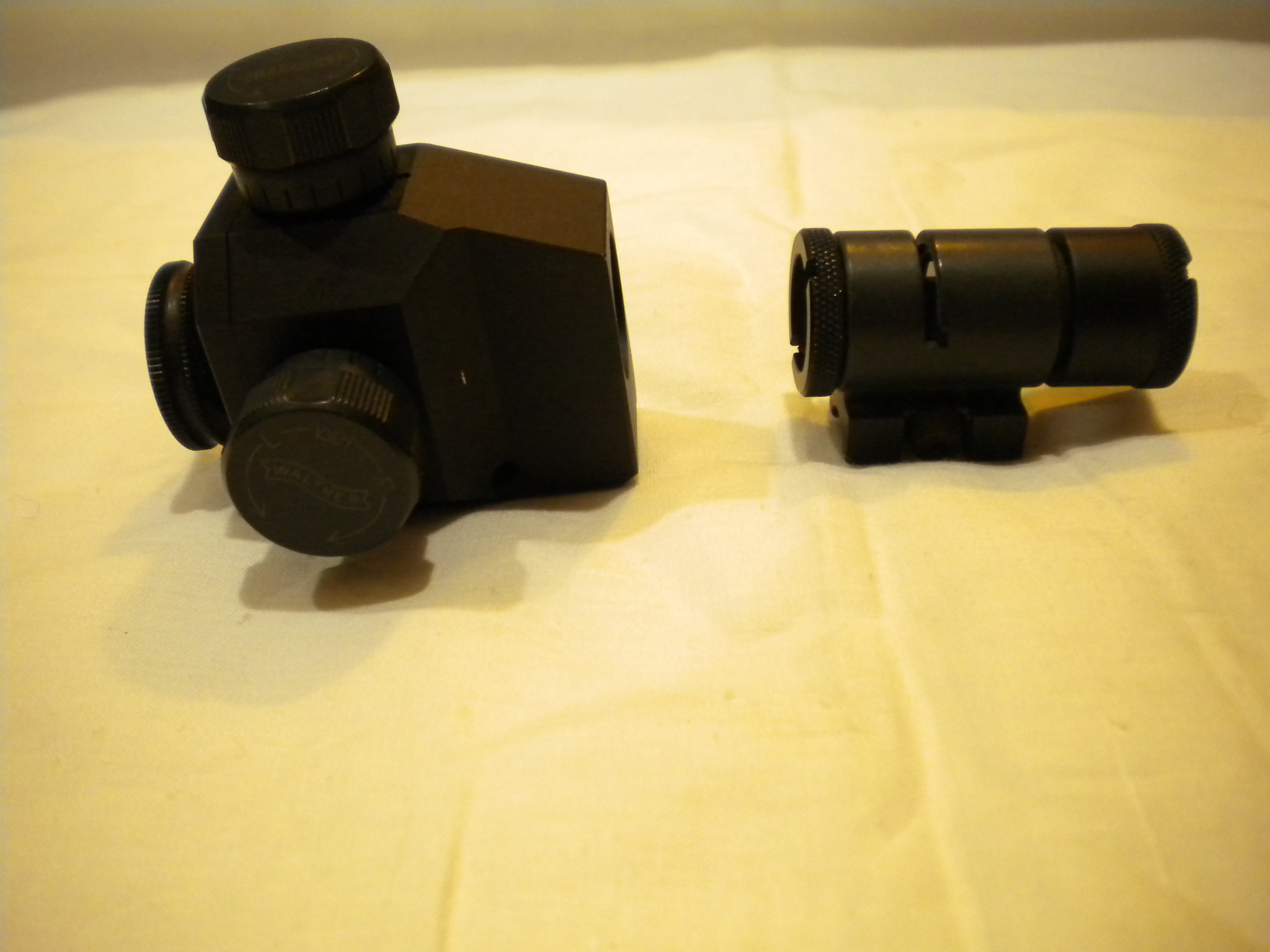

Meant to show you this a few days ago. This is my Gehmann M18 front. Imitation is the sincerest form of flattery and all that I guess ha ha.
