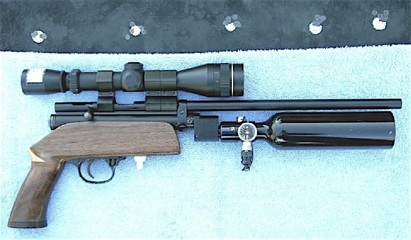

The Bandit has a LOOOOONG way to go to even compete with "cobbled together PCPs"; much less make them obsolete! 😂
Three National Champion and three State Champion titles with a cobbled together PCP.

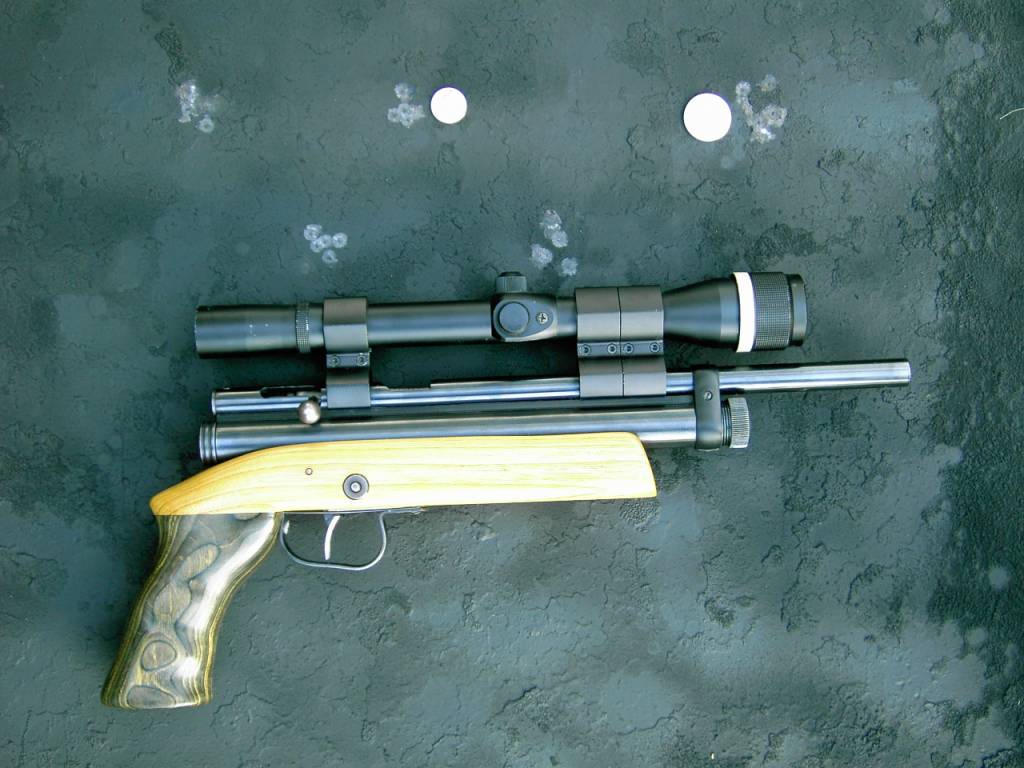

Five consecutive five-shot groups at 50 yards that averaged .66" center-to-center with a cobbled together PCP. The smallest group measured .34" c-t-c!

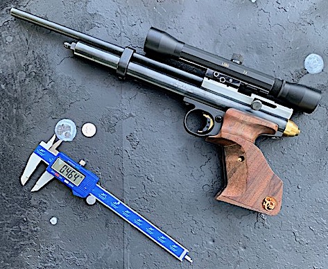

A .464" c-t-c group at 25 yards with a cobbled together PCP.

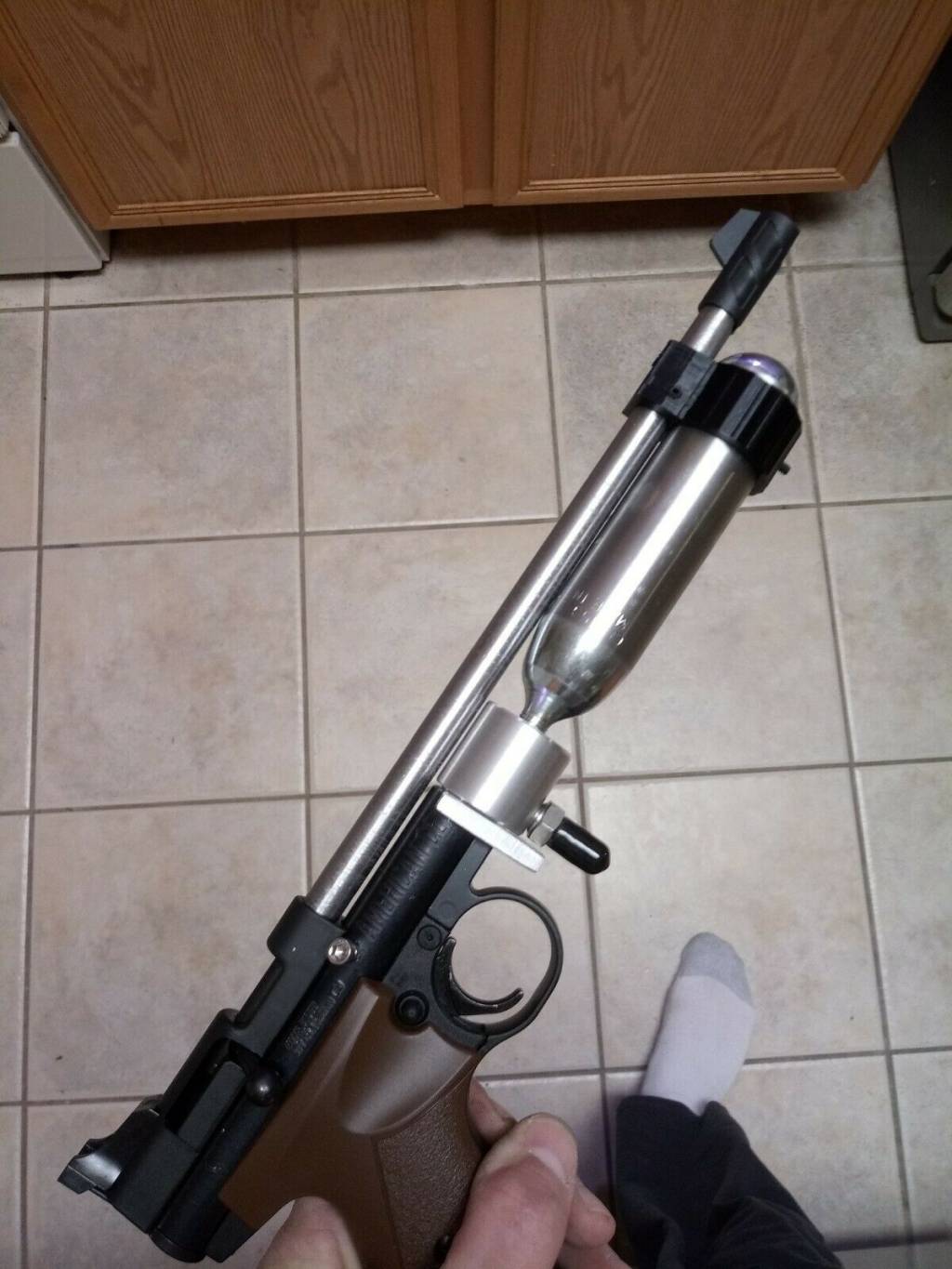

Not a cobbled together PCP, but this Co2 pistol cobbled together from a 1950s vintage Crosman 180 rifle that cost $21.95 brand new averaged .75" c-t-c groups at 50 yards.
