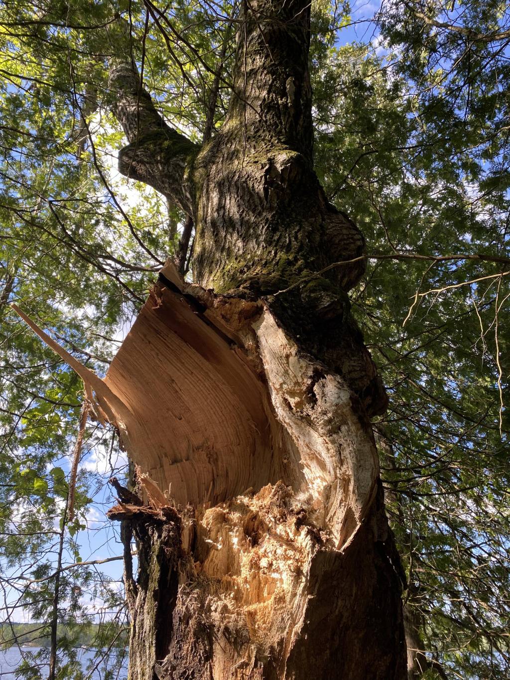

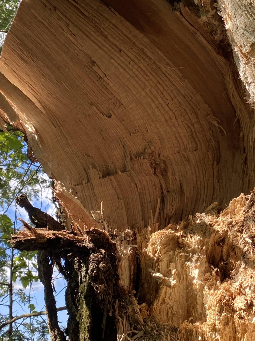

I just took a massive branch off 200 year old oak tree. 50 ft long. The whole tree has to come down, I just did the branch because it was over my woods hope and when the tree comes, that branch would’ve taken up my shop. I used my excavator to help take it down otherwise I couldn’t of done it. The 1 branch weighed over a ton.
This tree has got some beautiful crotch in it, I would consider turning into a gun stock.
Is red Oak suitable for a gun stock? Crow

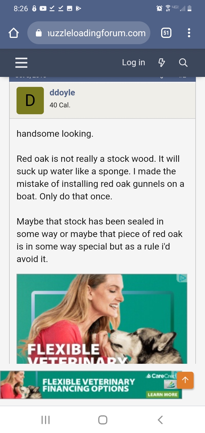

Lotus7 woodworking same time, didn’t think about branches wind, interesting Thanks I know White Oak is used in boat buildings resist water and also stays straight. Red Oak is almost opposite water destroys it. This gun will never see bad weather.
I’ve milled several Oaks from this area, they were all red. 1750 bf. When it comes down, I‘ll get a few blanks. I wanted to do a thumb hole stock for my Varmint, Maybe a regular stock would be better, I don’t think Red Oak would be my first choice for a thumb hole. Crow
Red Oak is not the best wood for gun stocks because of its open cell makeup. It expands and contracts to much with changes in humidity and thus causes POI changes.
