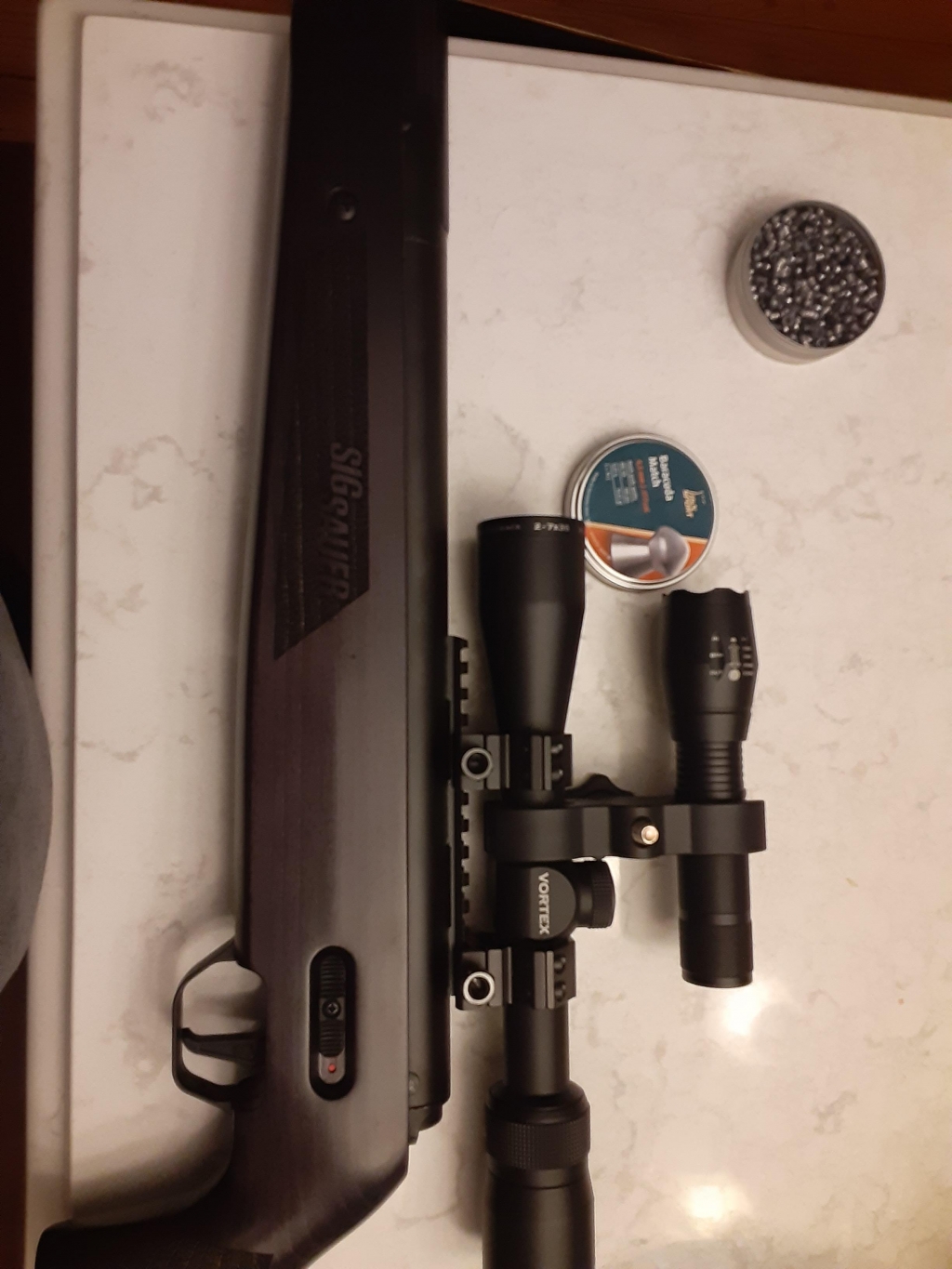

We have nutrias in our lake we are trying to get rid of. I got a gamo whisper air gun but the scope doesn't really work very well for night shooting. Most of my shots will be less than about 50 yards or so since I am usually shooting at a swimming nutria. Anyway, I am newb at any gun related items and was wondering about scopes. I really don't want to spend $500+ on one of the "true" night scopes so I figured I would ask folks here on the forum if a "regular" low light scope will work for me. I have found that there is enough light that I can see the nutria just fine with a small set of binoculars i have . Big difference between the binoculars and the as-delivered gamo scope. I was thinking i could probably purchase a lower-priced (less than $100) low light scope that might work…. Any help folks here can give me would be VERY much appreciated!

My night time pesting….I absolutley need more than just a low light scope. My cheapest set up is my green light attached to the scope. Works great for me out past 50 yards easily for visibility.
I don't have that scope anymore, but I still use the light…
The light cost around $25 with batteries, mounts, etc...
If it's pitch black, you'll need lights, or a night vision scope.
However, for urban and suburban hunting, there is often so much ambient light available, or you can set up a light in the general area where you expect your quarry to show up.
